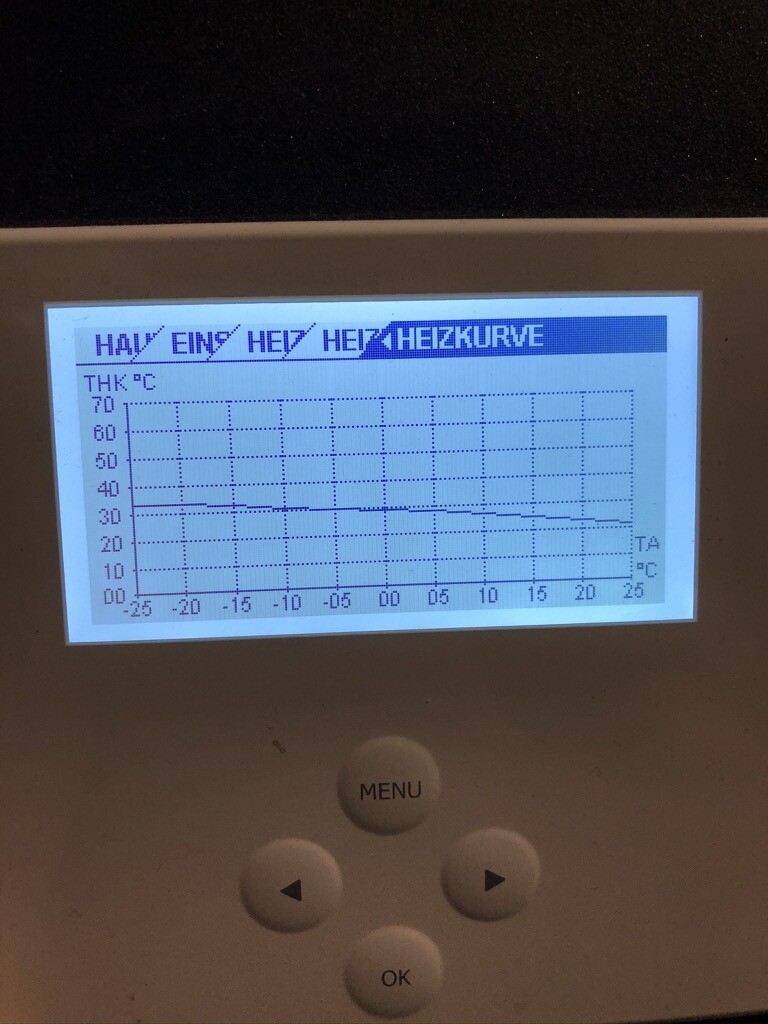

ares8315 Nov 2019 19:31
guckuck2 schrieb:
If you set it like this and don't add any slope, I would expect exactly 20 degrees Celsius (68°F) flow temperature, as long as other settings don’t completely prevent startup.
I would agree with that, and 20 degrees Celsius (68°F) is slightly too low at these temperatures. The values are completely off.
@hoernchenh
Just as a reference: We are using a base point of 2.0 and a slope of 0.30 on the 504.
Did you receive the manual?
This is what our heating curve looks like:
Heating controller display with heating curve graph and menu buttons below
This is the result of two years of adjustments. Let’s see if we can go a bit lower now.
