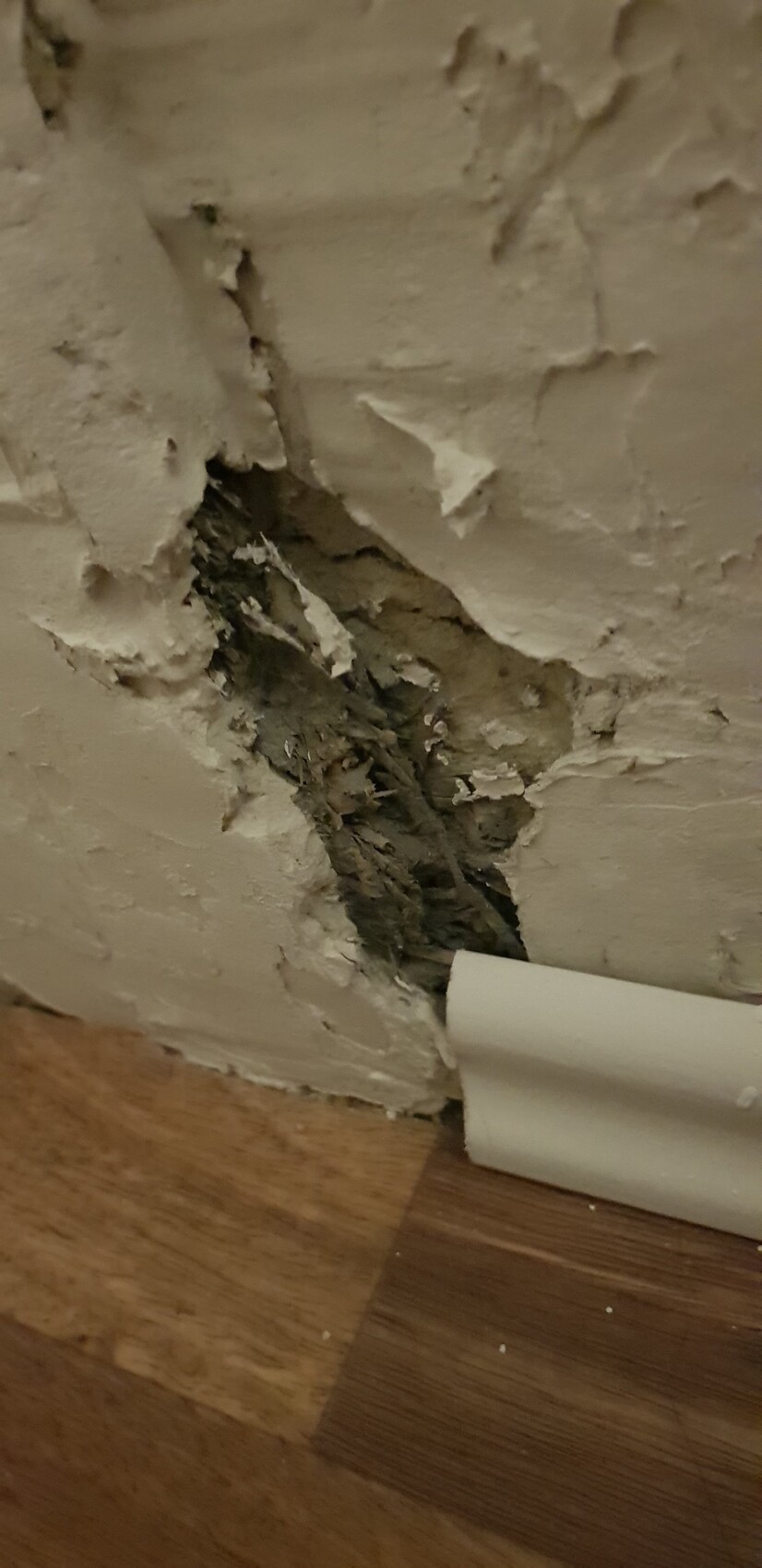

I have a question about a material that’s been on my mind lately. What kind of material am I dealing with here (see attached image)?
Is it Heraklith, wood fiber, or wood wool lightweight boards? I’m a bit concerned...

Damaged wall with flaking plaster and visible layer beneath at the bottom.

How old is the house? It looks like "Sauerkraut boards" – that would be wood fiber insulation.

The house was built around 1968. The ceiling and the walls inside the dormers are "insulated" like this, with plaster applied on top. So, relatively non-critical materials? Is the concern about asbestos rather unfounded?

I would also guess sauerkraut/Heraklith/..

Safety can only be confirmed by an expert if comprehensive testing is done.
If the panels are the sauerkraut-type, then yes, they are considered safe.

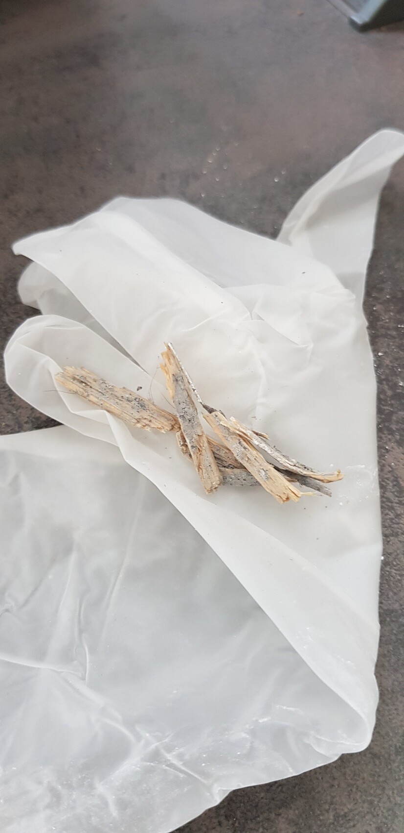

This is what the material looks like up close:
What do you think?
