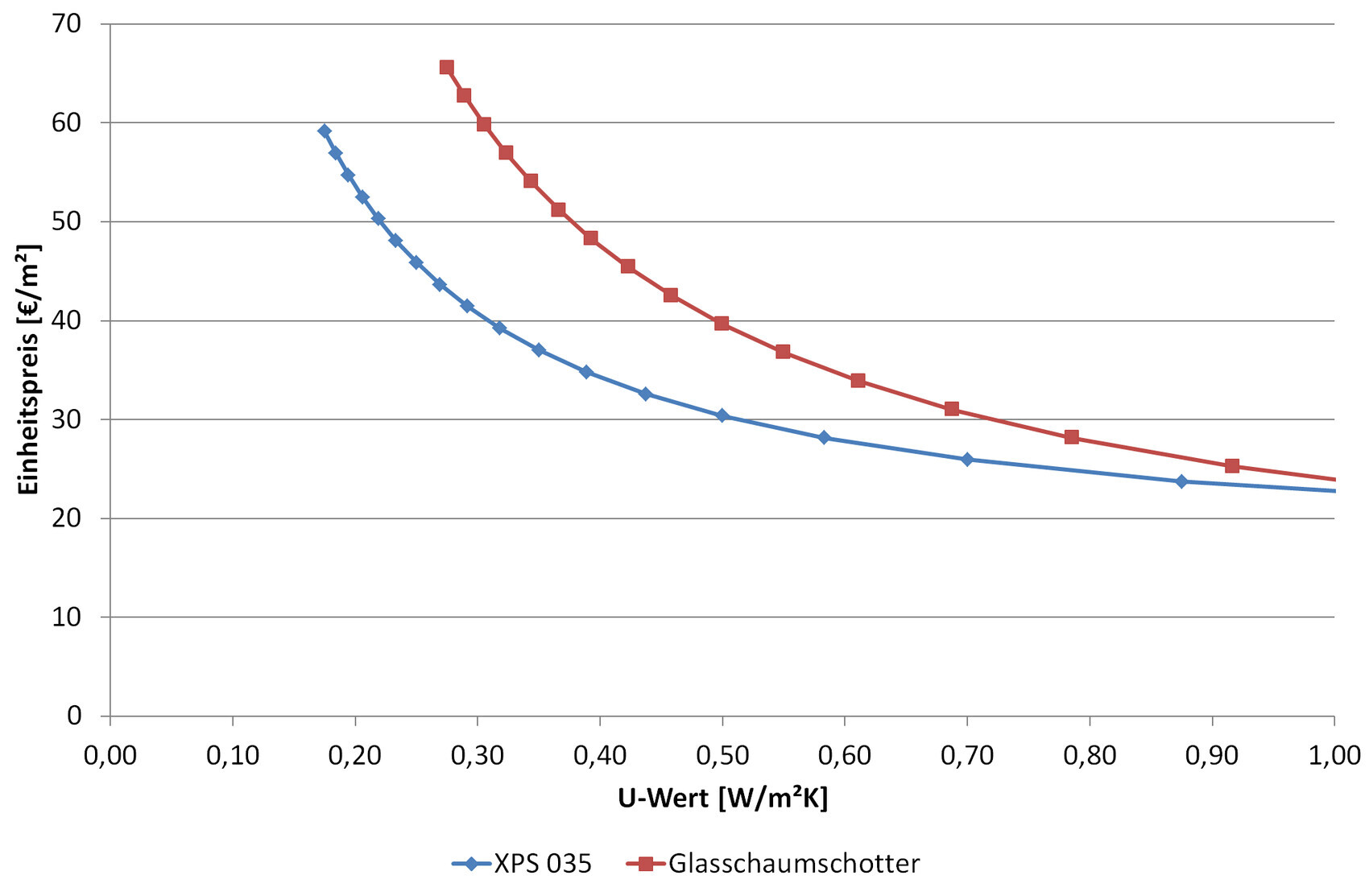

elVincent13 Sep 2016 18:41If I scale up linearly, my prices come to about €65/m² (approx. $65/sq ft) with 40cm (16 inches) GSS and a U-value of 0.28 W/m²K, or alternatively €46/m² (approx. $46/sq ft) with 14cm (5.5 inches) XPS and a U-value of 0.25 W/m²K. In this range, the price difference is quite noticeable; at 35-40mm (1.4-1.6 inches), GSS would have been cheaper.
I made a diagram showing total costs versus U-value
Edit: Diagram changed to unit price per m².
