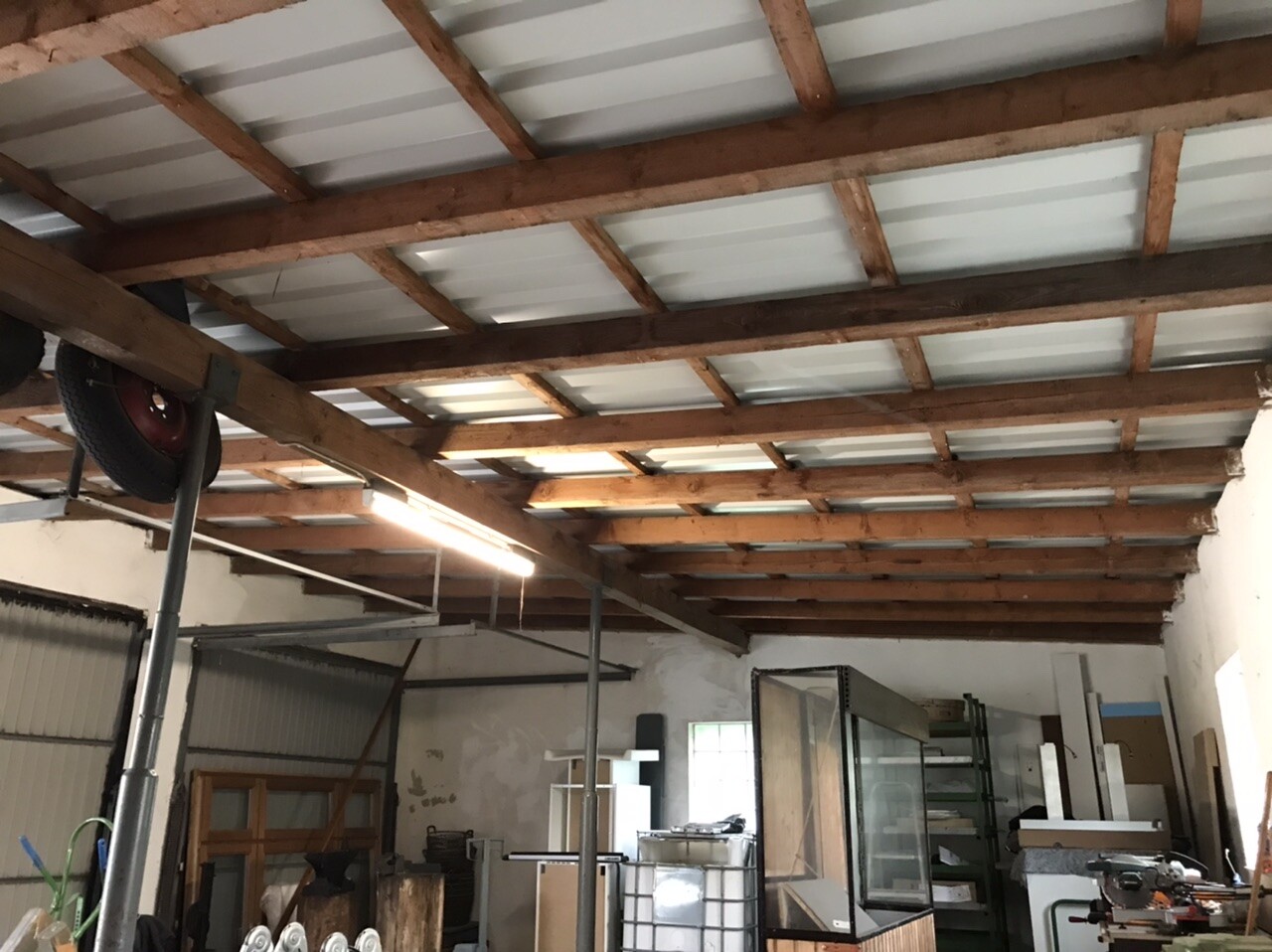

I plan to convert a former tractor garage into a (hobby) workshop.
The floor area is 10 x 7 meters (33 x 23 feet), with brick walls all around, a roof with about a 5° slope made of trapezoidal metal sheets, and three large doors.
I want to insulate the roof.
Although I will only heat the hall occasionally (probably using a warm air fan heater), I want some level of efficiency and to avoid losing all the heat directly through the metal roof.

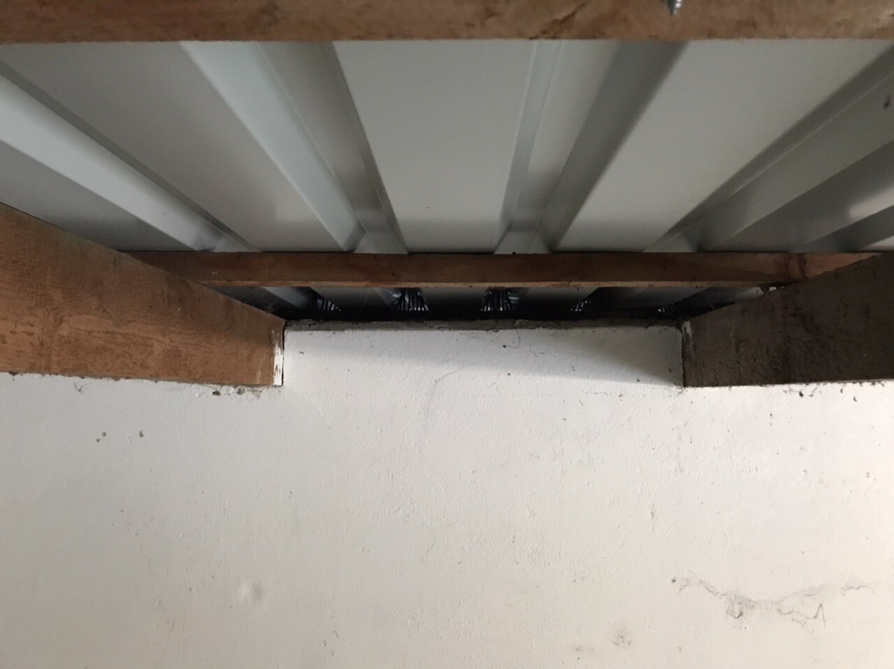

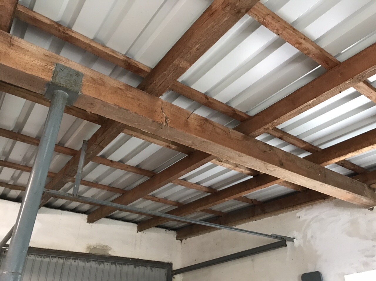

Currently, the roof structure is as follows:
- trapezoidal metal sheets
- 70/40 mm (3 x 1.5 inches) battens
- 130/90 mm (5 x 3.5 inches) rafters spaced about 90 cm (35 inches) apart

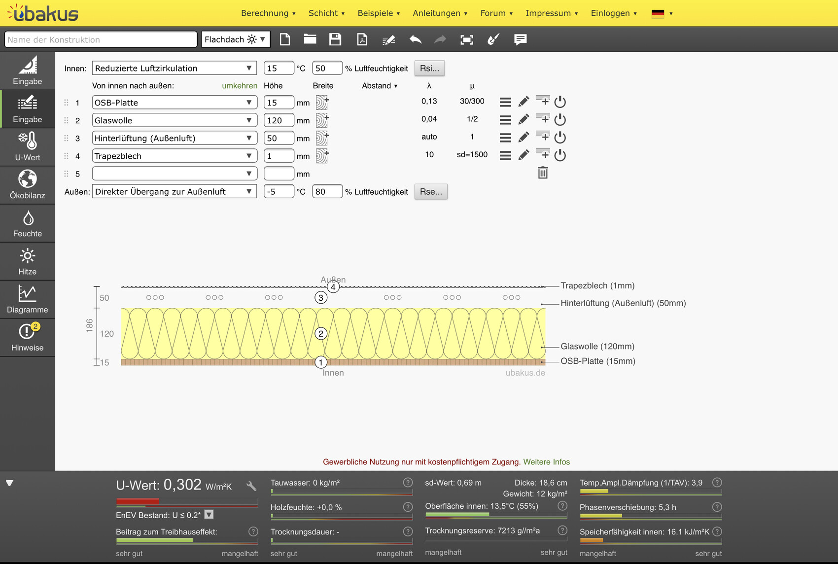

I would like to use 120 mm (5 inches) mineral wool insulation and visible OSB boards.
I have read that OSB 3/4 can act as a vapor barrier if the joints are sealed. How should the wall connection be executed in this case?
Would that be sufficient?
If so, I could save the cost of a separate vapor barrier, additional battens, and the taping and painting of drywall.
