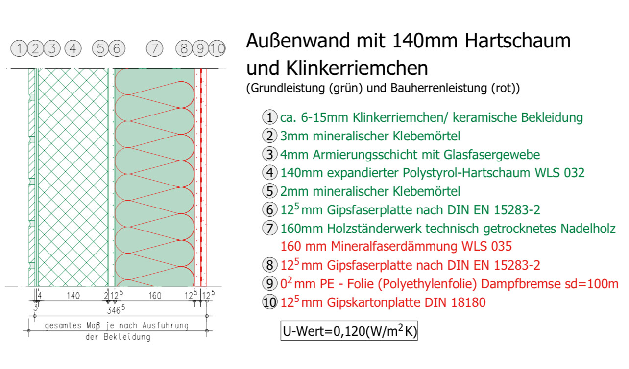

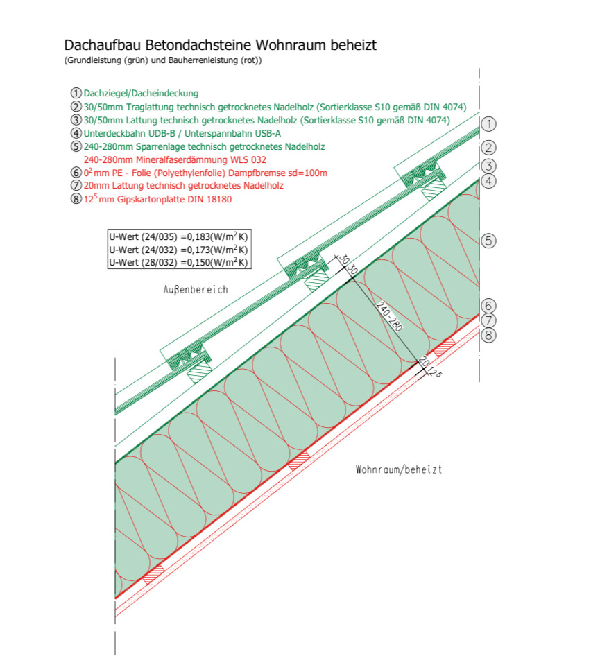

We are currently purchasing a prefabricated timber-frame house built in 2022. It is KFW55 standard, with a lot of insulation and multiple layers.
Technical drawing of the roof structure with concrete tiles and insulation.
Cross-section of exterior wall: 140 mm (5.5 inches) rigid foam, brick veneer, adhesive mortar, fiberglass, insulation, drywall
Now, we don’t want to make any mistakes with the house. Common sense tells you that no reputable manufacturer would build houses where you can’t hang a picture or a shelf on a wall without damaging the vapor barrier. Still, there is a lot of information online suggesting this is not good, including calculations claiming that for every square millimeter of hole in the vapor barrier, 10 square meters of the house rot away per year (just kidding, but only partly). Various points like this are repeated.

Thank you for the reply. Yes, certain finishing steps, like the interior work, were done separately. However, as shown in the attached pictures, it is exactly the parts marked in red that represent the owner’s scope of work. This was completed as far as I know. Therefore, the innermost layer (8 in the first picture, 10 in the second) is also the final one, with only wallpaper behind it. It can thus be assumed that there is no installation cavity within the exterior walls, roof slopes, etc., and any small drilling would damage the vapor retarder. As I said, common sense suggests that with such a construction, it shouldn’t be expected that the vapor retarder remains undamaged.
By the way, these pictures are from the construction service description by the builder, a method used thousands of times in Germany. That’s why I am about 95% confident that everything is fine. Still, the remaining 5% worries me :-) Maybe there are standards regarding this that the builder would communicate to the owner (for me, the seller), specifying in which areas such work should or shouldn’t be done, or which anchors/sealants to use. The seller could not provide any information on that, but that doesn’t necessarily mean anything.

Are there any photos of the interior, or have you visited the house? Are there absolutely no furniture, power outlets, or switches on the exterior walls?
The critical area is the internal waterproofing. Was the previous owner a professional? Properly sealing all connections with the membrane throughout the entire house requires careful workmanship.
If the house remains as it is, and everything was done properly, it can work. But any modification, extension, or troubleshooting will almost inevitably require extensive work to restore the airtightness, which can sometimes be nearly impossible.

Once all connections, outlets, and switches were installed, a blower door test was performed with good results. Afterward, the owner barely lived in the house and did not install anything else, so I assume the current airtightness status is acceptable.
My question is whether there is a risk of damaging this current airtightness status by making a few holes to fix things like curtain rods, etc.

Maybe there are some standards regarding this that should be communicated to the builder (which for me then means the seller), such as in which zones it should be done and where it’s better not to, or which anchors/sealants to use. The seller couldn’t say anything about it, but that doesn’t necessarily mean much.
The fact that he can’t or won’t say anything about it would personally raise concerns for me. This certainly doesn’t reflect the current state of technology. The house isn’t that old yet for long-term issues to appear.
He should know if any special precautions were taken or should have been taken during the interior work or electrical installation.
Especially with exterior walls, added EPS/XPS insulation can trap moisture that gets in, leaving it stuck in the insulation and framing.
Personally, I would go through it with an expert and look for any irregularities.
