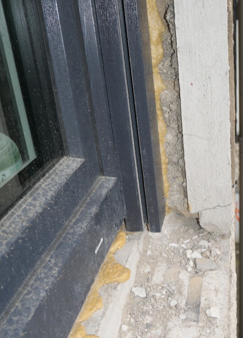

In our house, the windows including the roller shutter boxes have been replaced. We are currently unsure about the sealing and insulation of the joints between the window frame/roller shutter box and the corresponding wall.
A special feature in our case: since there is a slant in the outer wall area near the lintel for some windows, the windows and roller shutter boxes had to be recessed a few centimeters (centimeters) inward (window offset).
Inside, most windows (but not all ...) have a vapor barrier installed in the window area. The roller shutter box area does not have a vapor barrier. Is this common?

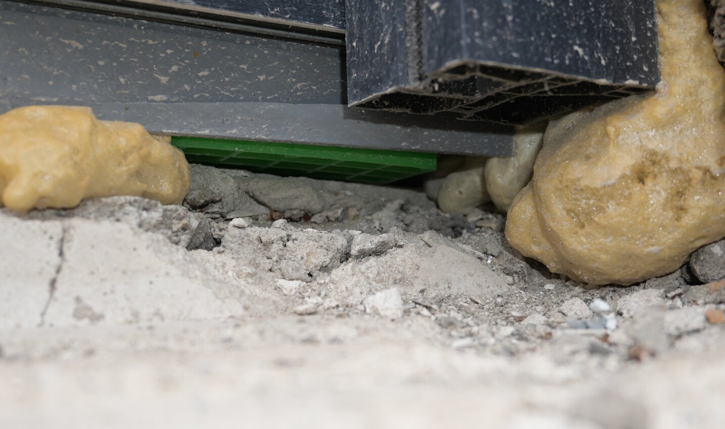

The joint between the window frame/roller shutter box and the wall was filled with expanding foam for these windows (photo: windowsill area), and the reveals were sealed with sealing tape where possible, always with foam at the bottom. However, there are several areas where the foam is not continuous, and for some windows, foam is no longer visible past halfway (no sealing tape either), and in some corners you can easily push a wire through these areas to the inside.

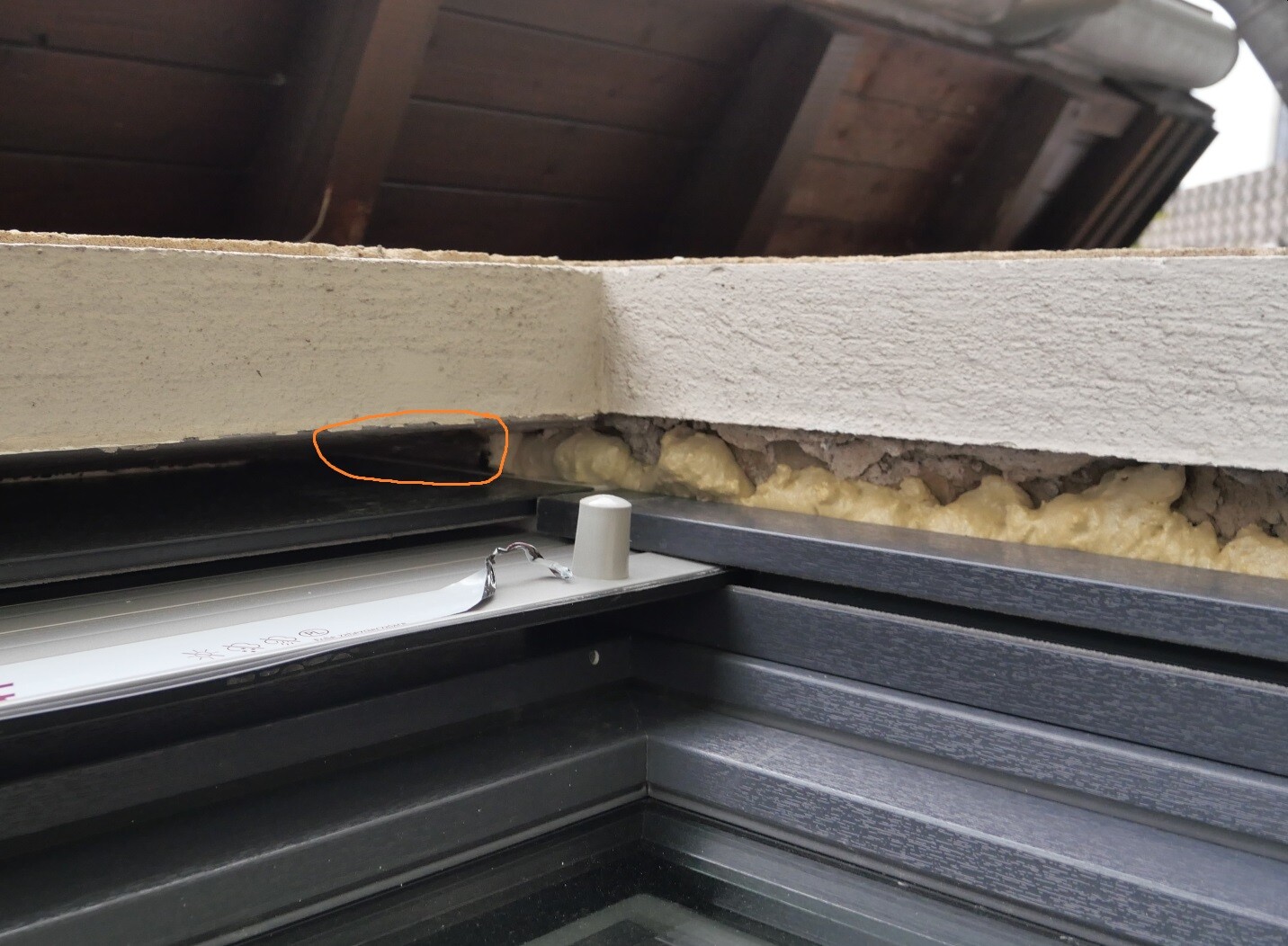

At the lintel area, the joints between the roller shutter boxes are so large (several centimeters (centimeters)) that you can partially see outside. The area marked "window offset" in the photo is an example. The interior installer has already plastered the joints from the inside. So, the only option left is to take action from the outside.
According to the window installer, the newly created joints should only be closed with exterior render. That would, of course, close it at first. We are now worried that this will lead to poor insulation and sealing because only the render would act as a barrier to the interior in some places.
