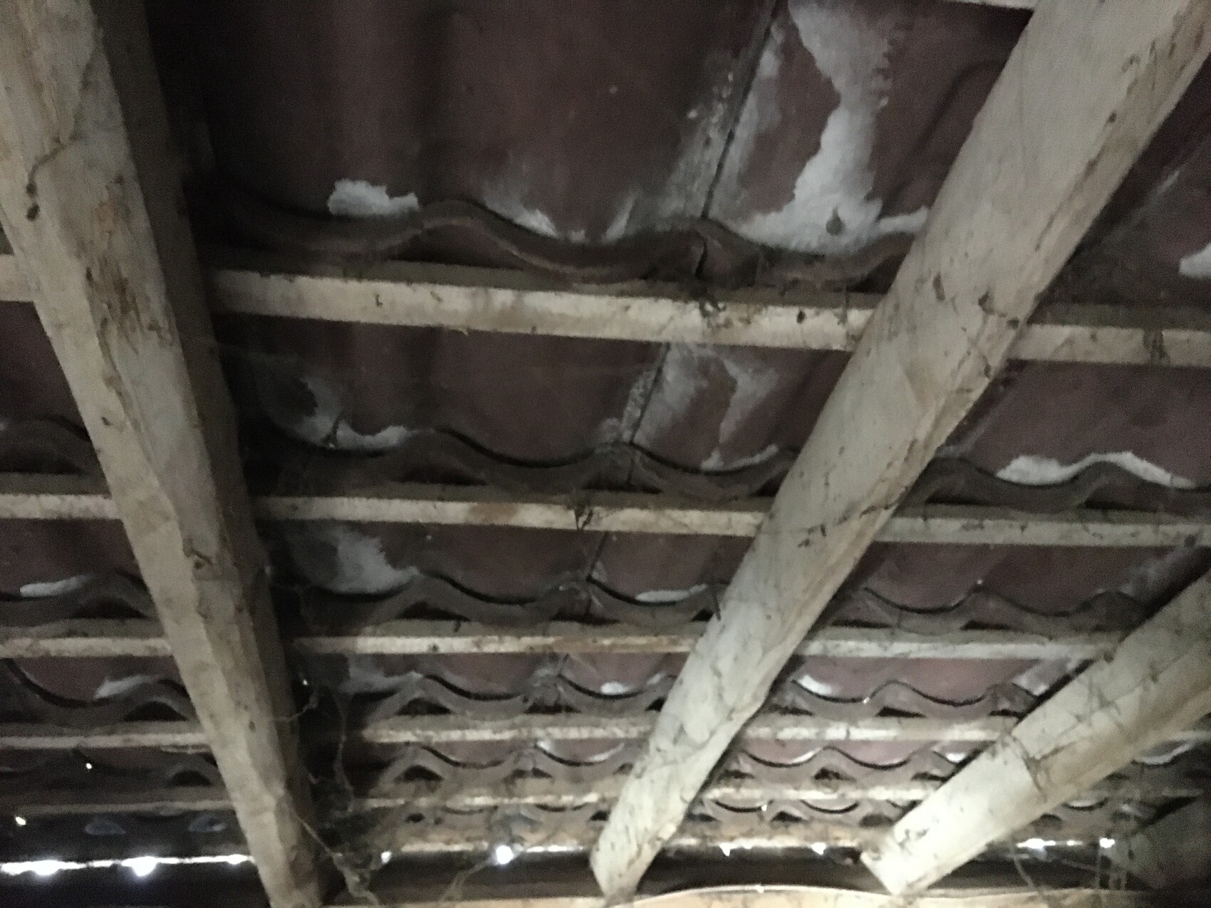

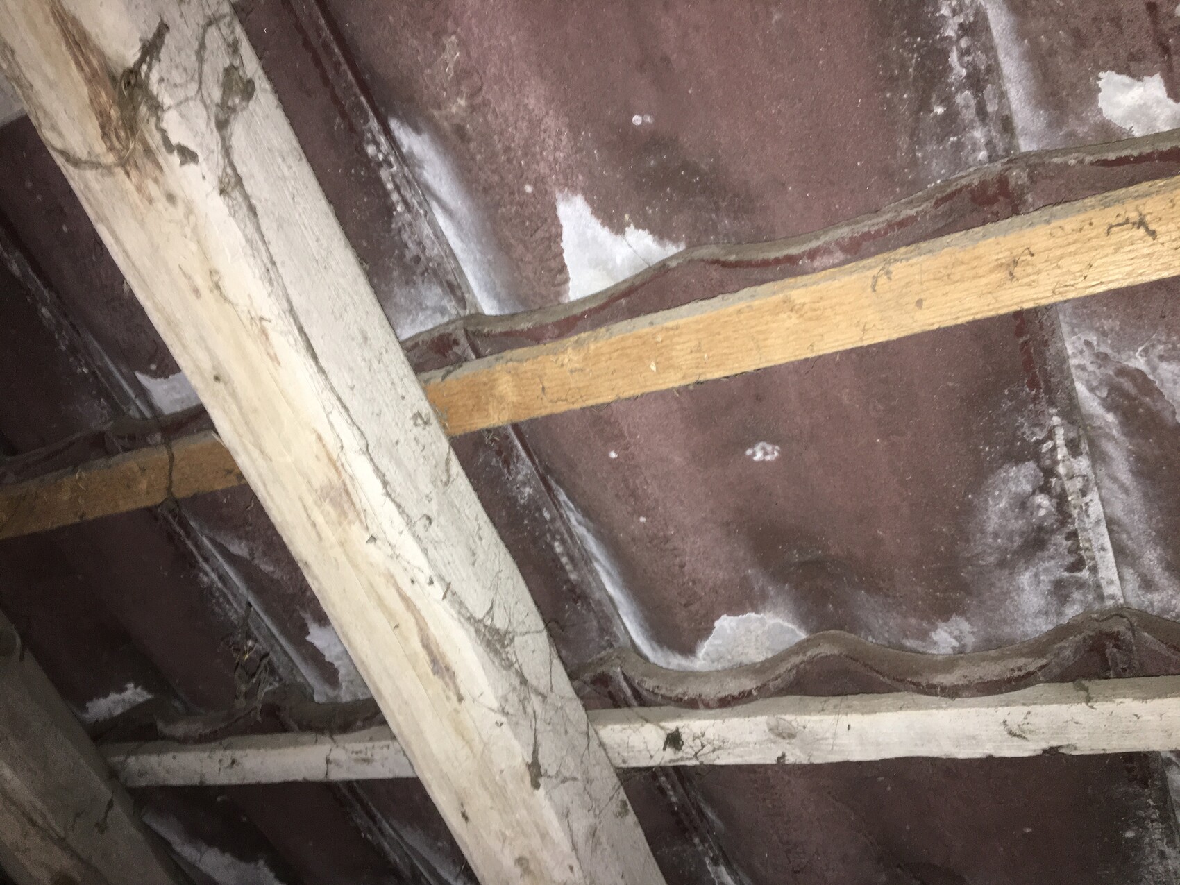

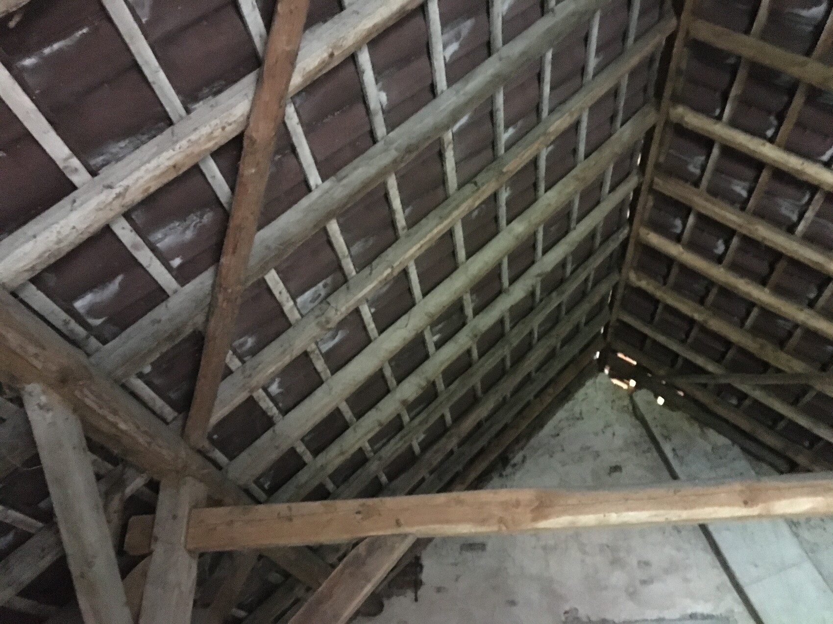

Unfortunately, only the extension roof has an underlay membrane installed. For most of the roof, you can look directly up at the concrete roof tiles from below.
Removing the tiles and installing an underlay membrane is hardly an option due to the effort and costs involved. I have read several times that an alternative looks like this:
Install insulation with at least 4–5cm (1.5–2 inches) of air space to the roof tiles; put the vapor barrier on the inside, followed by the interior cladding (we also want to use gypsum boards here). Essentially, this is just a ventilated roof build-up. Does anyone have experience with this? The roof pitch is 42°.

Roof: fill the space between the beams with mineral wool, leaving a 2cm (0.8 inch) gap to the roof tiles. Then, nail beams or battens across on top and fill the space there again. After that, install a climate membrane and gypsum board. Done.
