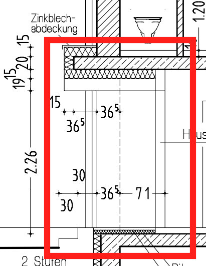

I am currently considering the best way to insulate the entrance area (windbreak) of our new build and how to construct the overall build-up.
First, here is the section drawing:
As you can see, there is a heated basement room below the entrance area.
Since the finished floor level of the entrance area is supposed to be the same as in the hallway, the total build-up height is unfortunately only 10 cm (4 inches).

NatureSys12 Jul 2021 18:25For clarification: Is your vestibule located outside the house? Normally, the entryway or wind lobby is inside the house, situated between the exterior door and the hallway or corridor.
Exactly. Maybe “windbreak” is not the right term here.

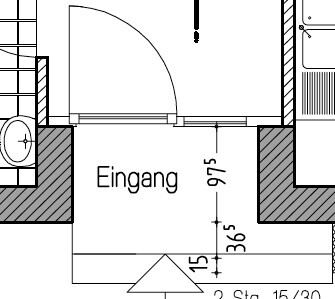

Here is also the excerpt of the floor plan related to this.
By now, it is clear to me that the construction I originally planned above is not feasible.
So it might possibly work like this:
1. Bitumen waterproofing membrane or liquid waterproofing (0.5 cm (0.2 inches))
2. Rigid phenolic foam board (4 cm (1.6 inches))
3. Cement screed (4 cm (1.6 inches))
3. Tile adhesive (0.2 cm (0.08 inches))
4. Terrace tiles (0.9 cm (0.35 inches))
Maybe I can also use a dry screed to gain more height for the insulation. For example, Fermacell offers the product Powerpanel TE for this purpose. However, I am not sure if I can simply place a rigid phenolic foam board underneath it. How would these layers be connected?
