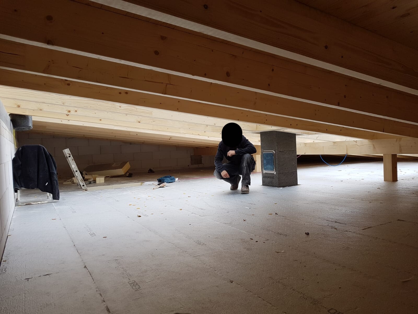

Piotr198125 Oct 2020 20:22benediktr schrieb:
Yesterday, we insulated 115 sqm (1236 sq ft) of the top floor ceiling with 160 mm (6.3 inches) Puren insulation with a thermal conductivity of WLG022. Thanks to the tongue and groove joint, it was quite easy to install. For me, it was clear from the start that I wanted to build a ventilated cold roof. If you insulate the rafters at the top floor ceiling and don’t plan to convert the attic into living space later on (which is not possible for us anyway), you are wasting energy by heating the unused attic. It’s only suitable for storing Christmas ornaments or similar items.
[ATTACH alt="0507671a-dbbc-471e-9a24-caad809e70e1.JPG"]52823[/ATTACH] May I ask how long it took you?
Where did you start, and how do you handle the attic access hatch? Do you install a vapor barrier foil underneath?
Where did you start, and how do you handle the access hatch? With a vapor retarder underneath? Of course, you may ask. We started at the eaves since we have a very shallow shed roof. The roof was constructed simultaneously, and the insulation was installed when only the rafters were in place. There were three of us (one cutting, one laying insulation, and one cleaning up), and it took us 12 hours. Underneath is a vapor barrier with an sd-value of 100 to protect the insulation from residual moisture. Generally, as far as I know, no vapor retarder or barrier is necessary for concrete ceilings. We initially cut the membrane around the hatch area with sufficient overlap.
nordanney25 Oct 2020 22:04benediktr schrieb:
As far as I know, vapor barriers or retarders are generally not required for concrete ceilings.Yep!benediktr schrieb:
As far as I know, a vapor barrier or vapor retarder is generally not required for concrete ceilings.However, if you want to cover the insulation over a large area with OSB panels, then, to my knowledge, it is necessary.Similar topics
