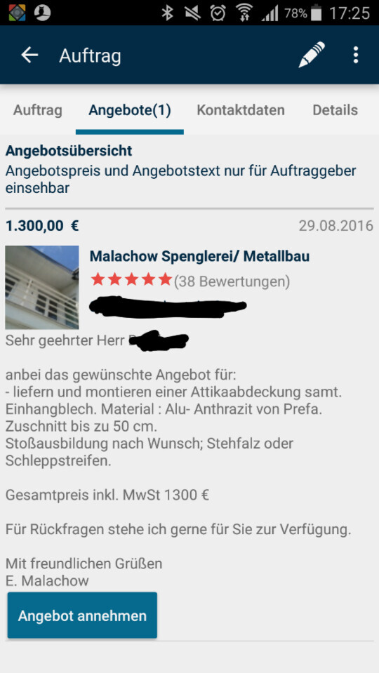

tomtom791 Sep 2016 17:31
For example, this is now through MyHammer, since I prefer to book companies via MyHammer.
The others I found through classified ads or the Yellow Pages.
The requirement was 25m (82 feet) of aluminum in anthracite.
About 3m (10 feet) of that as a connecting sheet.
Cut to size approximately 50cm (20 inches)
Drip edge formed as a fold
Screenshot einer Auftragsübersicht mit Angebot für Spenglerei und Metallbau auf Smartphone

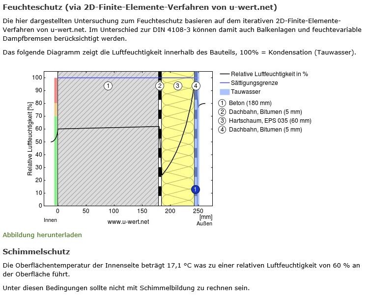

AOLNCM schrieb:
If no roof structure is planned, a concrete ceiling should be insulated from above.
Usually with polystyrene, or in the case of a flat roof, also green roofing.

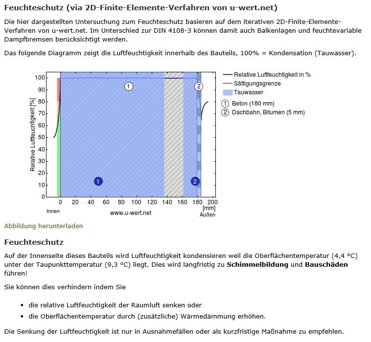

For "non-experts," two images are attached. The graphics, as well as the comments below them, might be interesting for some.
The source of the graphics is visible on the images. I highly recommend the site for experimentation.

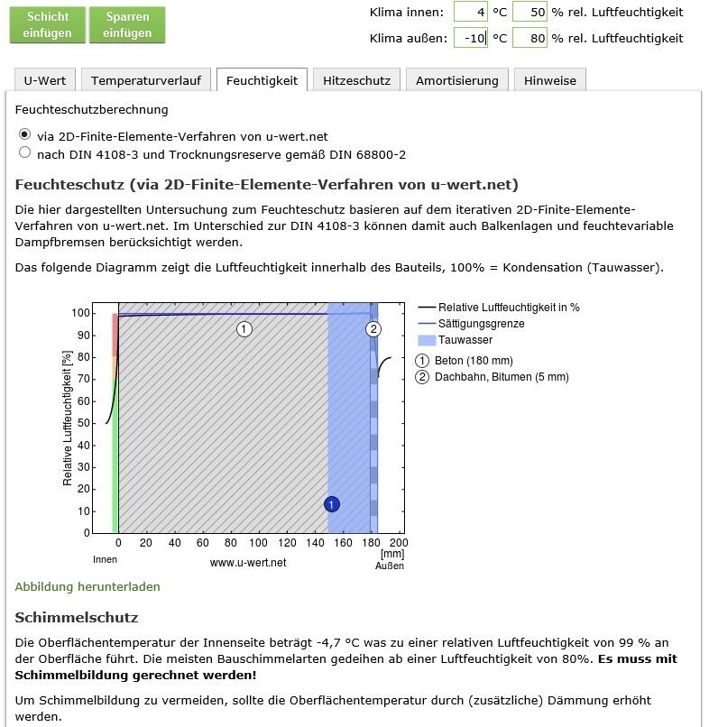

Moisture protection diagram: relative humidity within the building component with condensation.
Cross-section of wall assembly showing moisture distribution, relative humidity, and dew point line.

AOLNCM schrieb:
Two pictures attached for "non-experts."
Under which conditions do these pictures apply? Unheated garages?
AOLNCM6 Sep 2016 10:29
Unheated.
