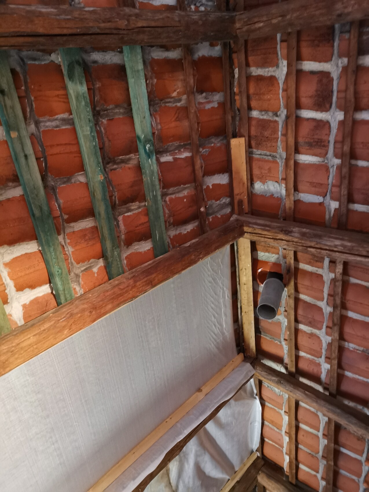

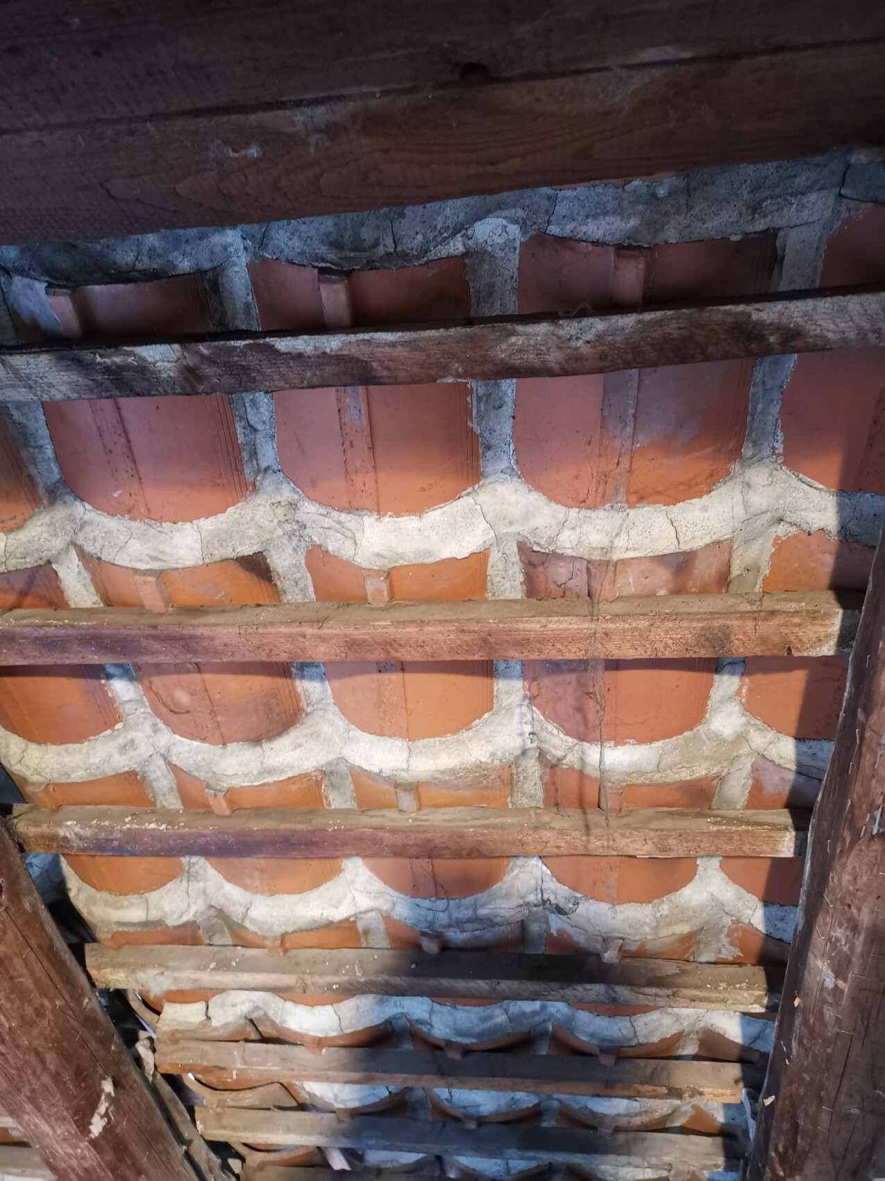

Dennisw7f28 Feb 2021 13:29I wanted to add a photo, but somehow I can no longer edit the post. So here is the image: the tensioned membrane you see was left by the previous owner; it wasn’t extended outward at the bottom. The original build-up, from outside to inside, was the visible membrane, wood fiberboard, insulation (very thin, maybe 10cm (4 inches)), then 3cm (1 inch) of polystyrene, followed by OSB. This was only on one half of the roof.
