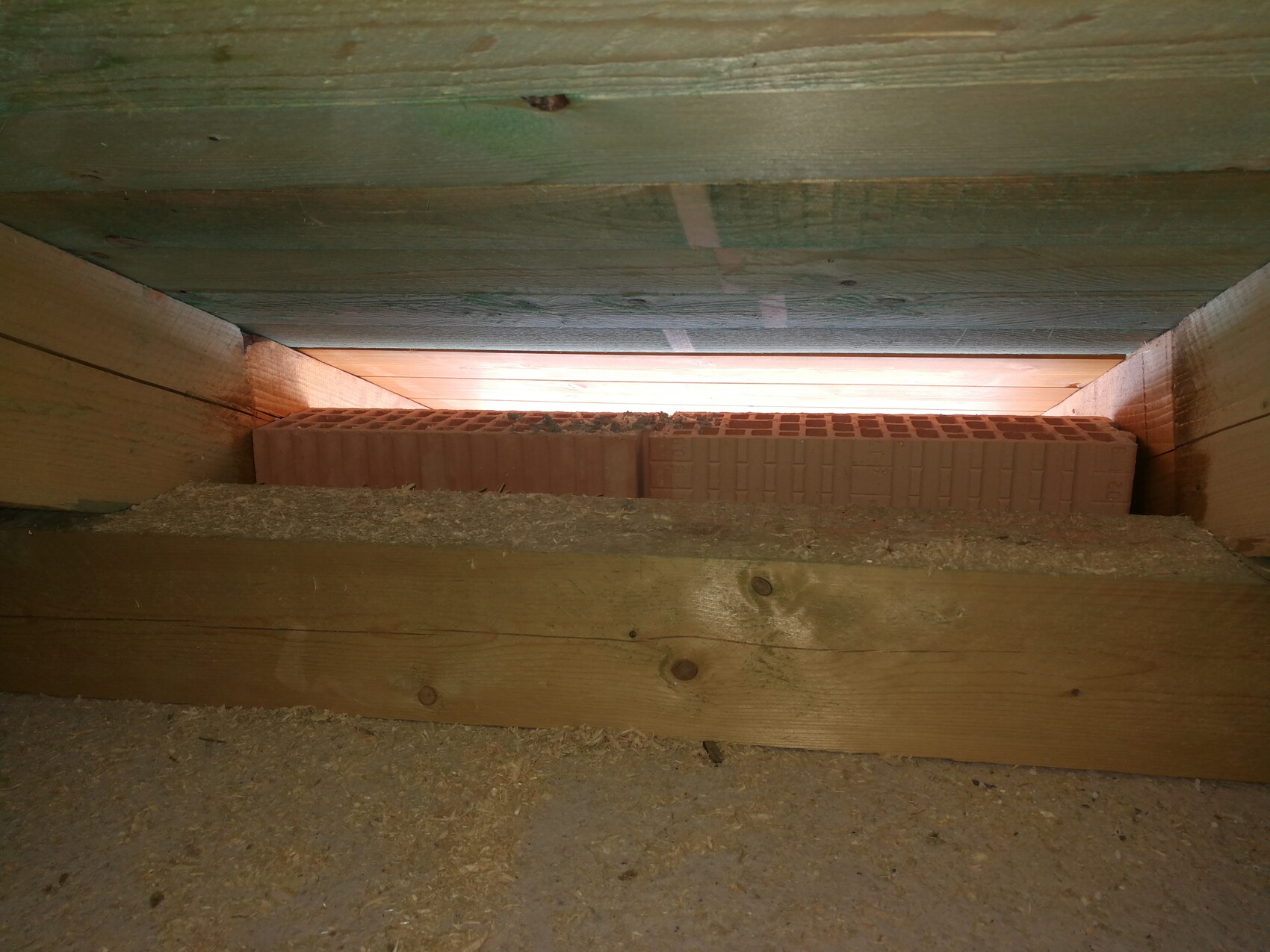

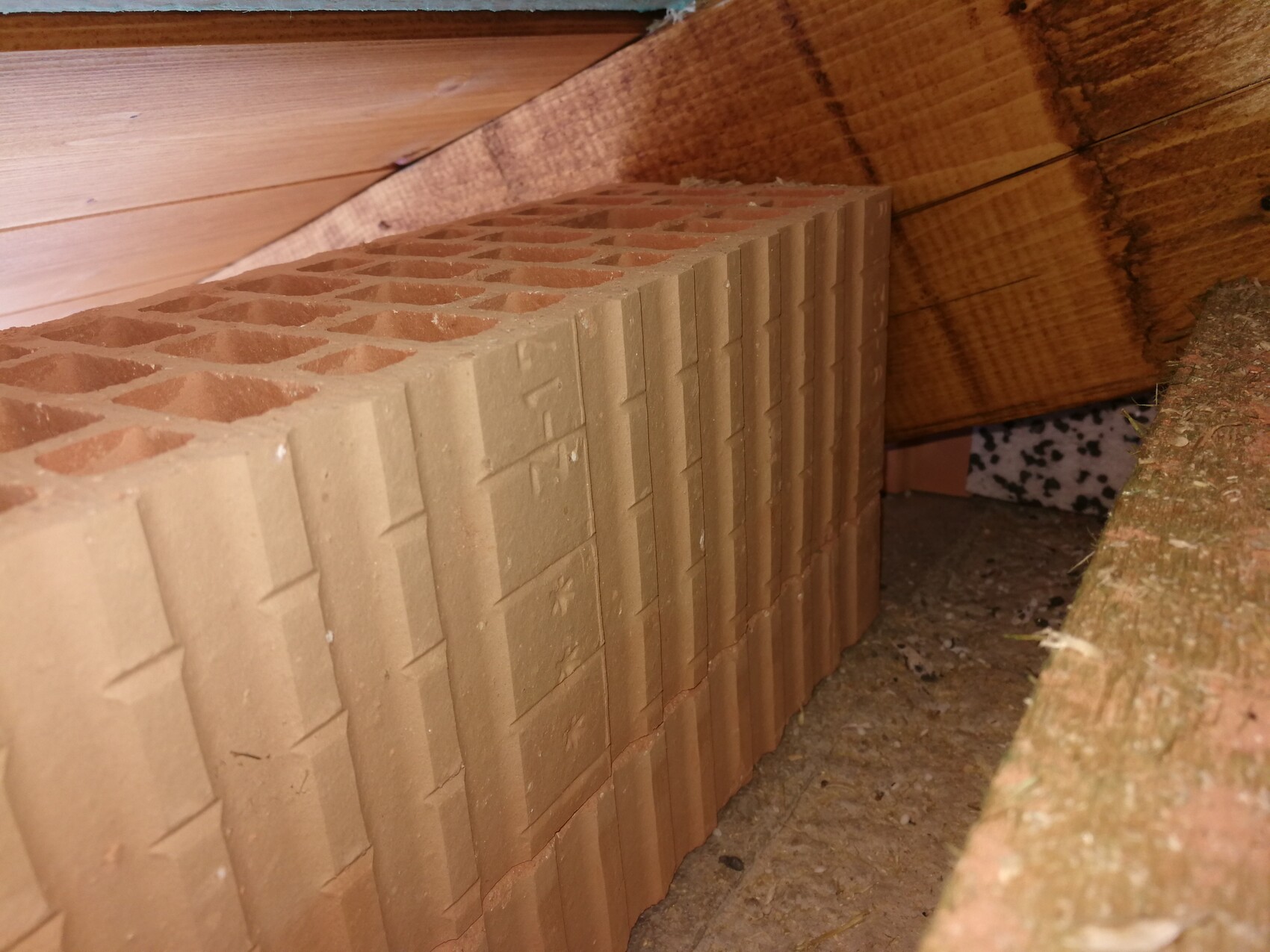

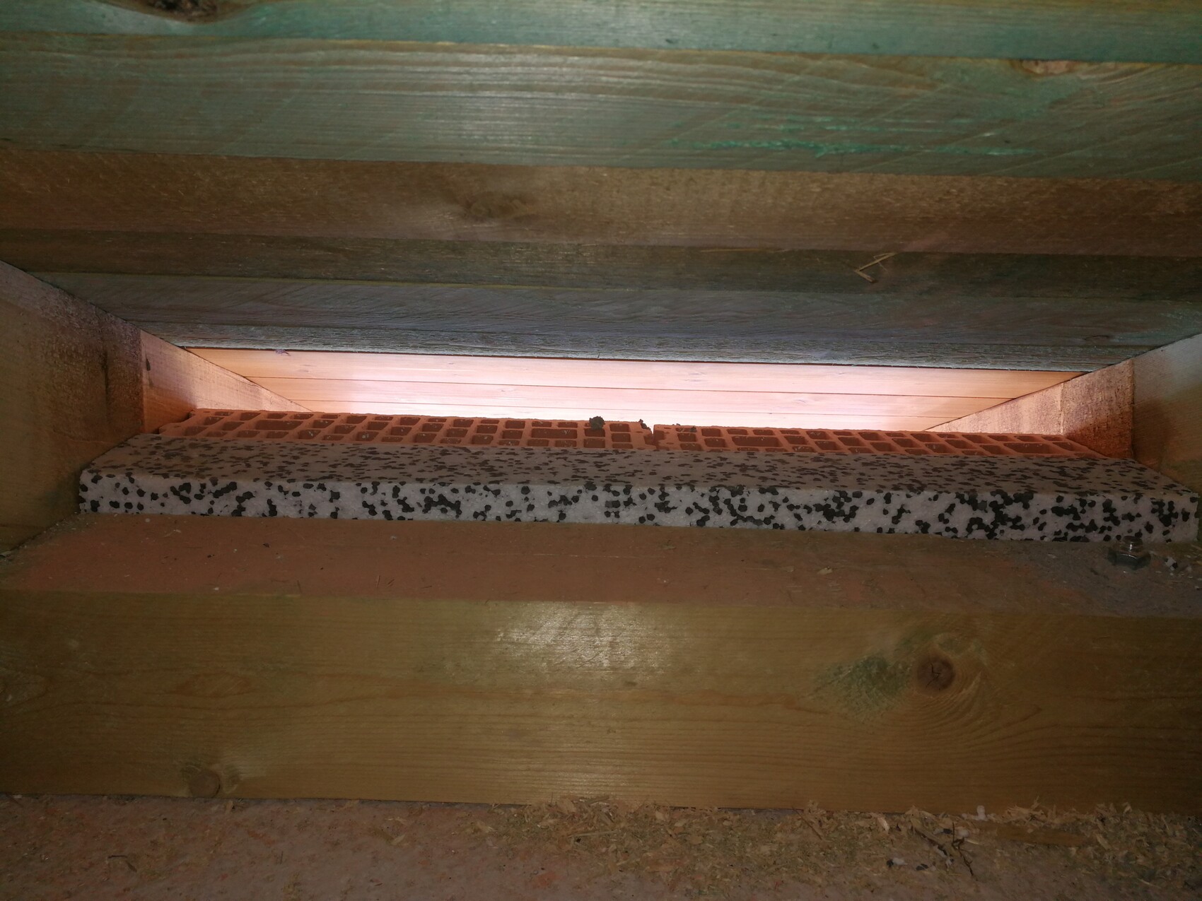

Hello, we are currently insulating the top concrete ceiling with a cold roof design using 26cm EPS insulation (10 inches).
My question is how best to insulate the knee wall and fill the gaps between the beams. Would mineral wool be a better option?
Thanks and best regards

Hello Steffi, thanks for your reply, I believe you have helped me several times before. My main concern is the small triangle under the beam.
Since I need to insulate 26 cm (10 inches) in height, the wide gap between the roof joists will automatically disappear, but I am not sure how to handle the corner under the beam. At the moment, I can only think of using mineral wool or another loose, fibrous material.

Cellulose loose fill insulation or loose-fill insulation wool

Finally finished, it was a tough job, hopefully it wasn’t all for nothing and reduces thermal bridging.
Using loose fill insulation would surely have been easier and faster, good to know for next time.
