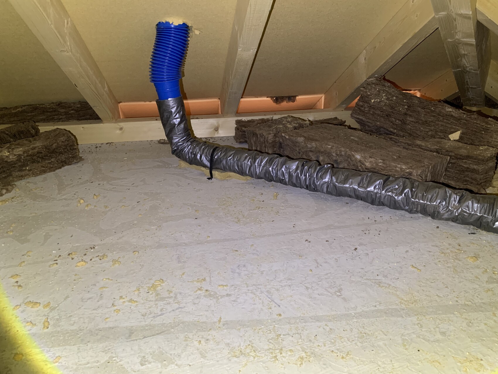

Allthewayup5 Jan 2024 13:58In our case, before insulation, the cold roof looked like this. A vapor barrier was installed on the concrete, followed by the insulation. While reviewing the photos, I just realized I need to check whether they placed the wood fiberboard, which they used here as a spacer for the slope, above or below the vapor barrier. Otherwise, this board might absorb moisture and start to rot.
