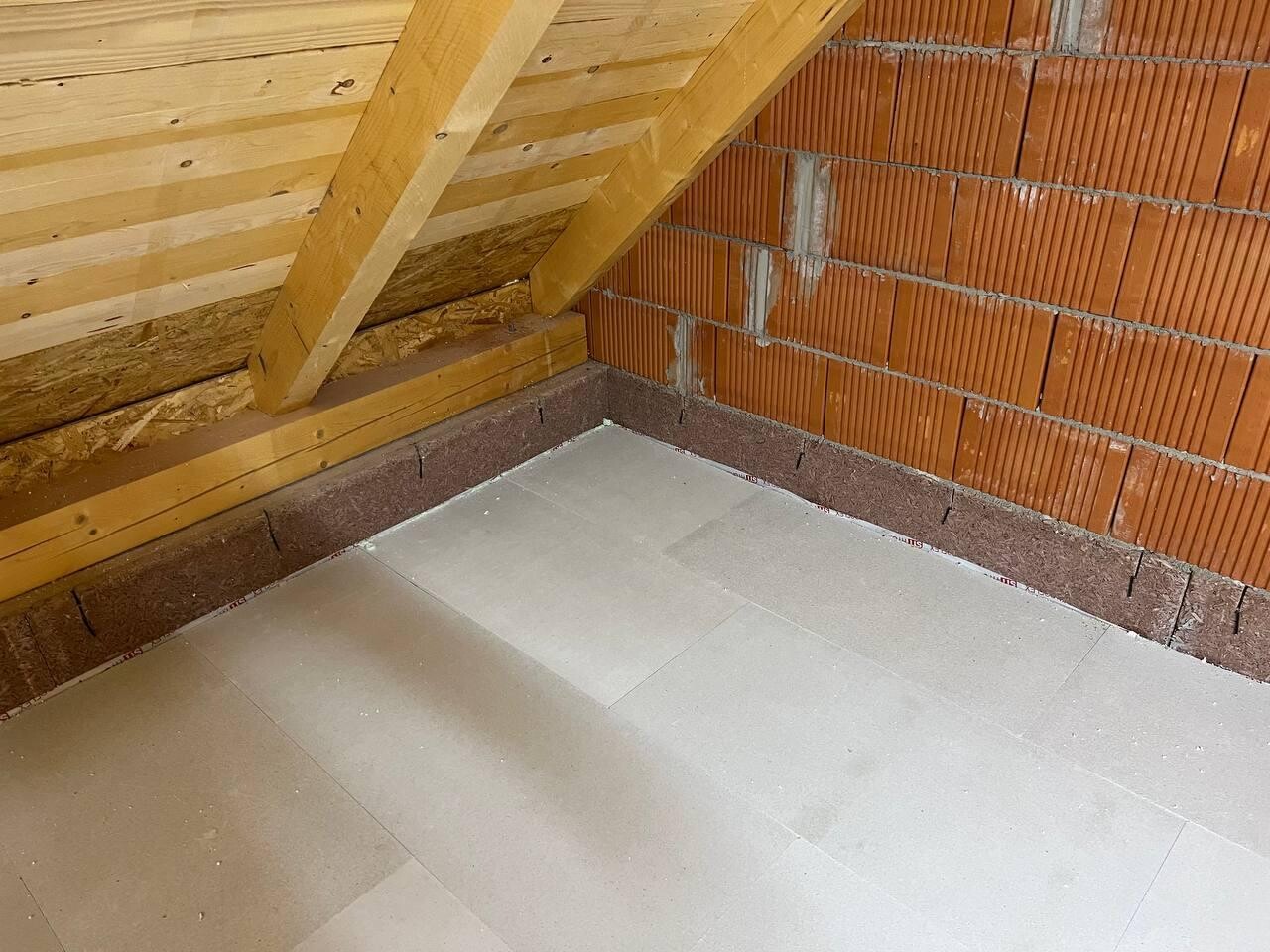

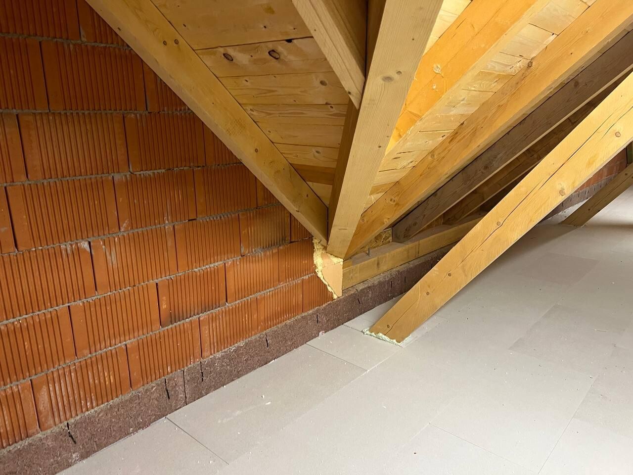

Here’s the situation: We have a 160 m² (1,722 sq ft) attic with a cold roof. OSB boards are installed, and there is a vapor barrier. The thermal separation from the living space is through an attic hatch that can be pulled down from below. We have been thinking: Since I’m starting my own business, we actually need a room in the house to use as an office. Therefore, we considered partially insulating the cold roof to create an office space. Is there any practical solution for this, or would it be equivalent to a full conversion that would cost a fortune? I have also attached a few photos.

Unfinished attic with visible wooden roof structure and red brick wall
Attic with wooden beams, red brick wall, and tiled floor.
Attic corner with visible wooden beams, brick wall, and tiled floor.
