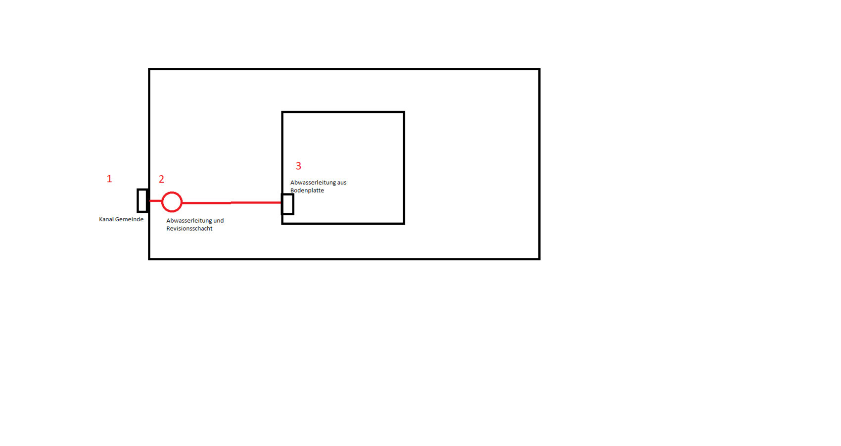

I have illustrated it here in a simplified way.
1. The municipal sewer at the property boundary was already in place.
2. The sewage pipe and inspection chamber were installed on-site in August.
3. The sewage pipe protruding from the concrete slab was factory-installed.
The slope between points 1 and 3 was only 6cm (2.4 inches) over a distance of 15 meters (49 feet).
Now the general contractor claims that the inspection chamber (2) was not present as a reference point when the concrete slab (3) was poured, and therefore the excessively deep sewer connection does not constitute a defect.
Was there additional excavation done under the slab afterward, and the pipe rerouted? Or how should I imagine the rework?
Does the shaft go further down? Could they have used a different shaft, or does it basically go straight through there?
What does the contractor’s pipe layout plan say?
