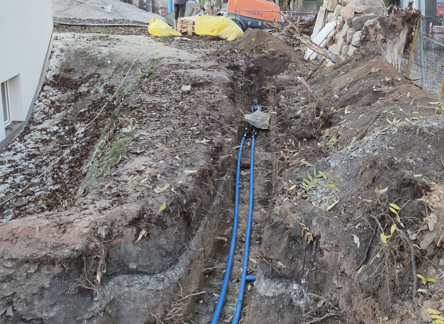

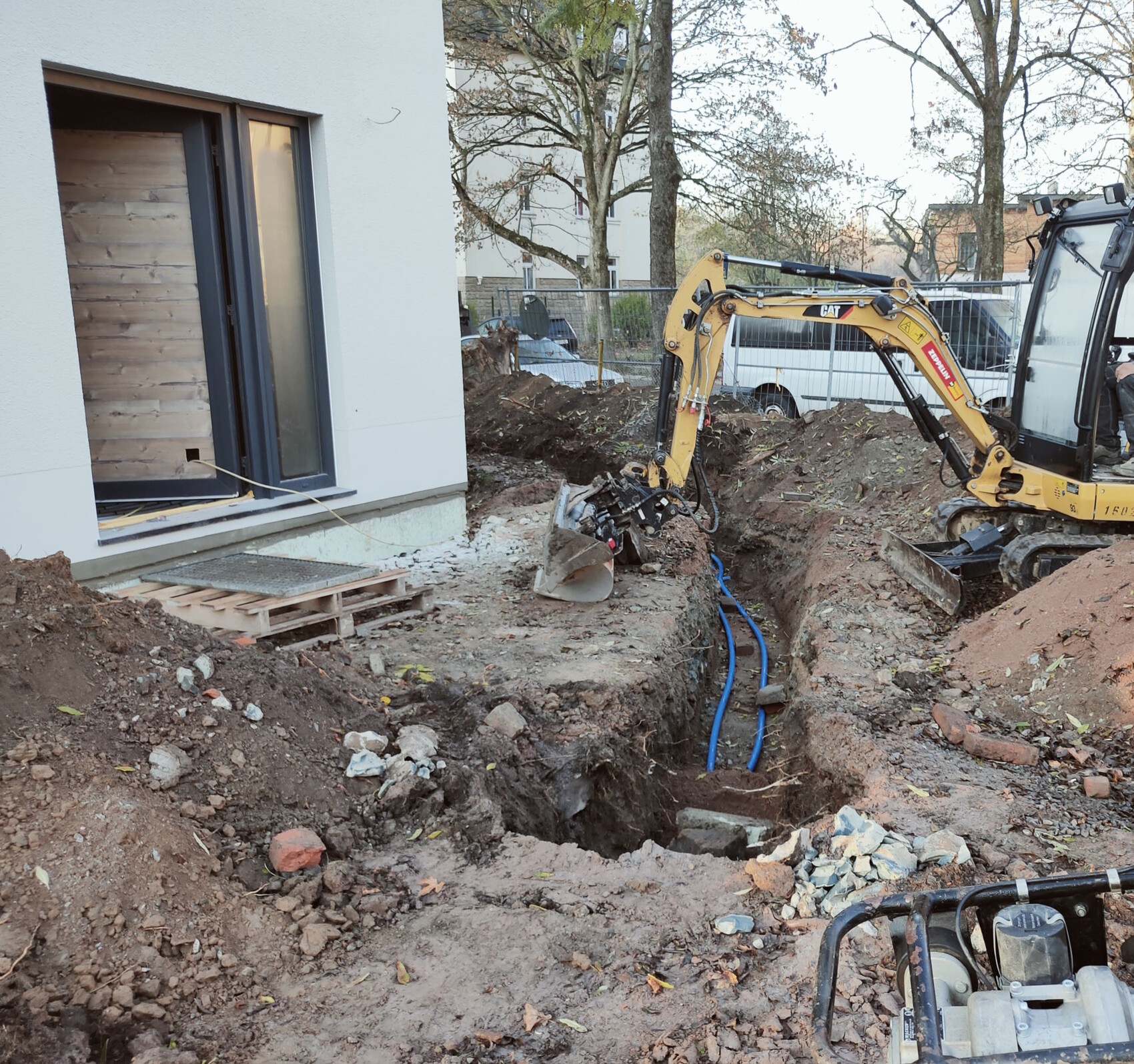

What does the heat pump manufacturer have to do with how deep the pipes run to the probe manifold? There should be standards for that, right?! The manufacturer only specifies or recommends the temperature difference between inlet and outlet – how or whether this is achieved is the heating engineer’s responsibility. The heating engineer told my excavation contractor how to bury the pipes to the probe drillings. Most likely, he just told him to bury them, which is why they aren’t very deep. I’ve attached a picture.

These are great tips! I could imagine that placing a lengthwise halved KG pipe over the pipes could also effectively distribute the weight above?! We’ll see. I did have an excavator on site recently for a rainwater tank, but that didn’t coincide with this. I think I’ll hold out for a while longer until something structural is changed there.
