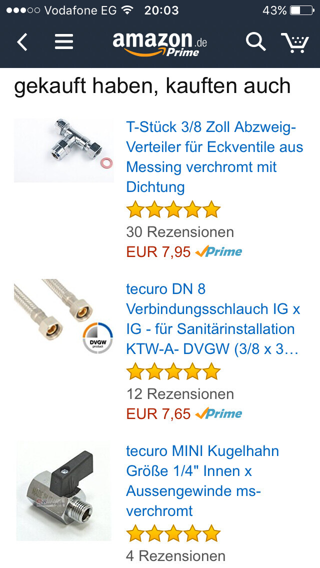

Kevkev9298 Feb 2017 23:39Hello everyone,
I would like to install a water connection from the bathroom to the adjacent room in our apartment.
The water connection will be used about twice a week for washing hair, approximately 5 minutes each time.
I was thinking of using a T-fitting and installing a valve to shut off the water. I plan to run the pipe using 2-meter (6.5 feet) flexible hoses, connected and sealed with hemp fiber and so on. A cable conduit will be used to keep everything stable.
What do you think about this setup? Do you think it can work the way I envision it?
Thank you in advance 🙂
Kevkev929
Kevkev929

Regarding traditional shower hoses, I am only aware of leakage issues occurring at kinks, which can be avoided with a “fixed” installation. I know someone who has subdivided several old buildings into worker apartments and used hoses as heating pipes in many places without any problems.
