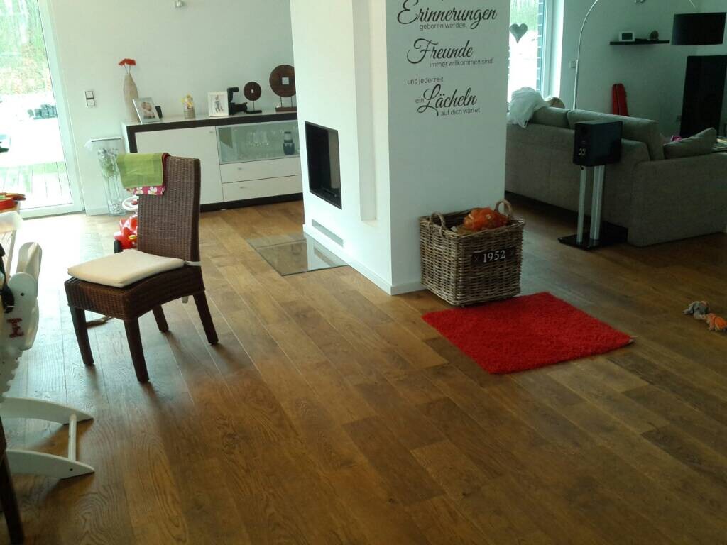

we are planning to install 20mm (3/4 inch) thick oak floorboards in our new build. In various forums, especially recent posts, it is often mentioned that a floating installation is at least possible. However, despite thorough research, I haven’t found much concrete information.
A Dutch wood supplier apparently recommends a floating installation using spacer clips along the walls. However, this is said not to be ideal. Another system uses clips to attach the individual boards but is quite expensive.
I just want to glue the tongue and groove joints and otherwise keep the floor floating. The subfloor would consist of a vapor barrier and 3-5mm (1/8–3/16 inch) impact sound insulation.
