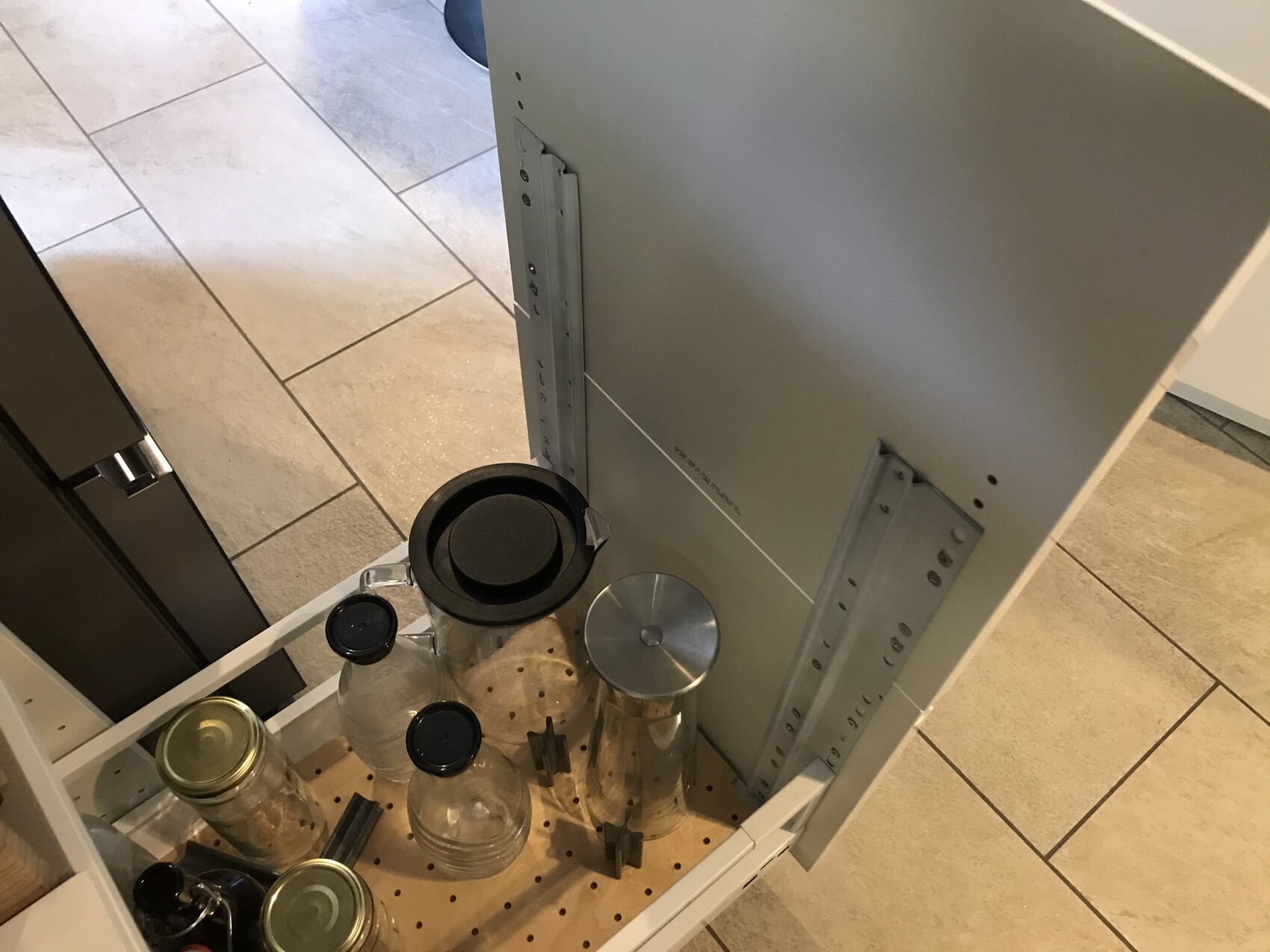

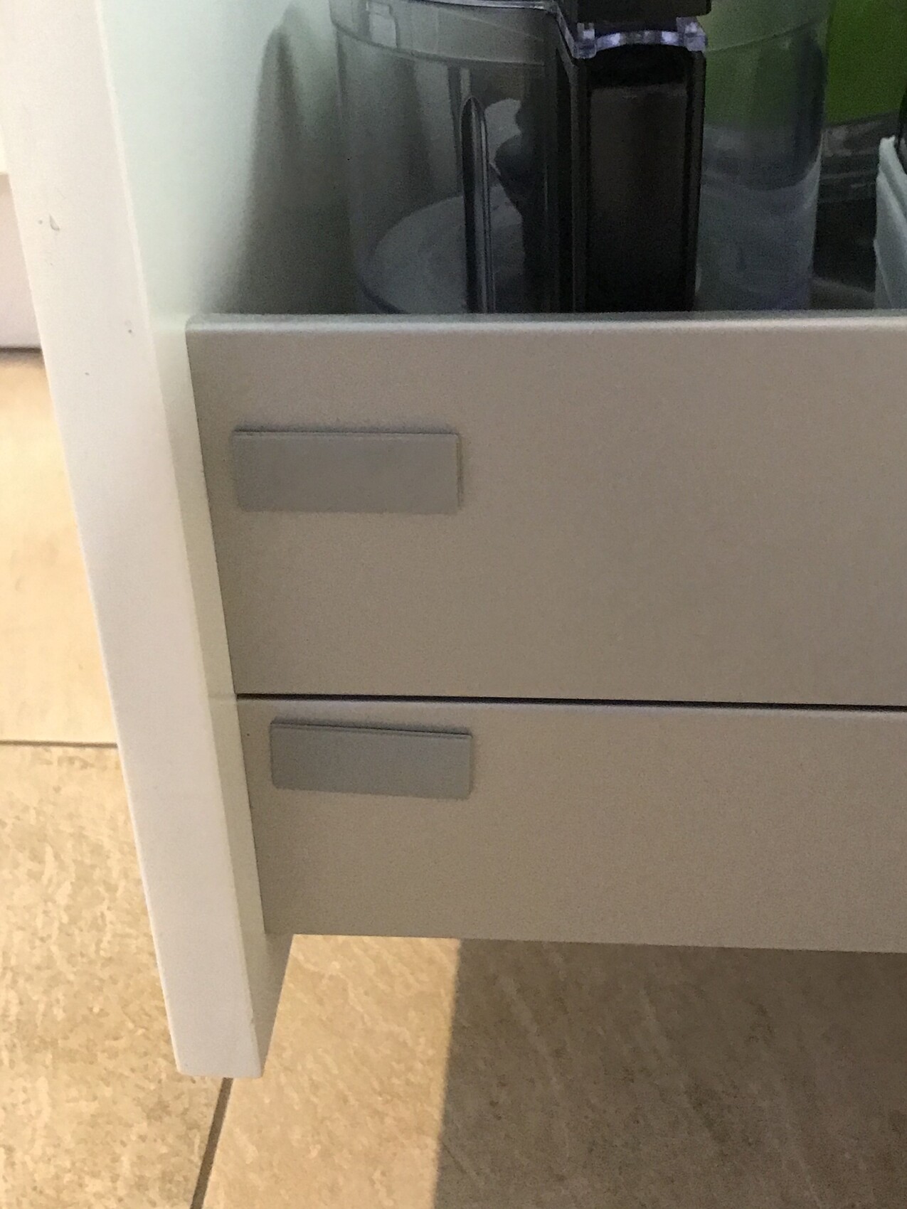

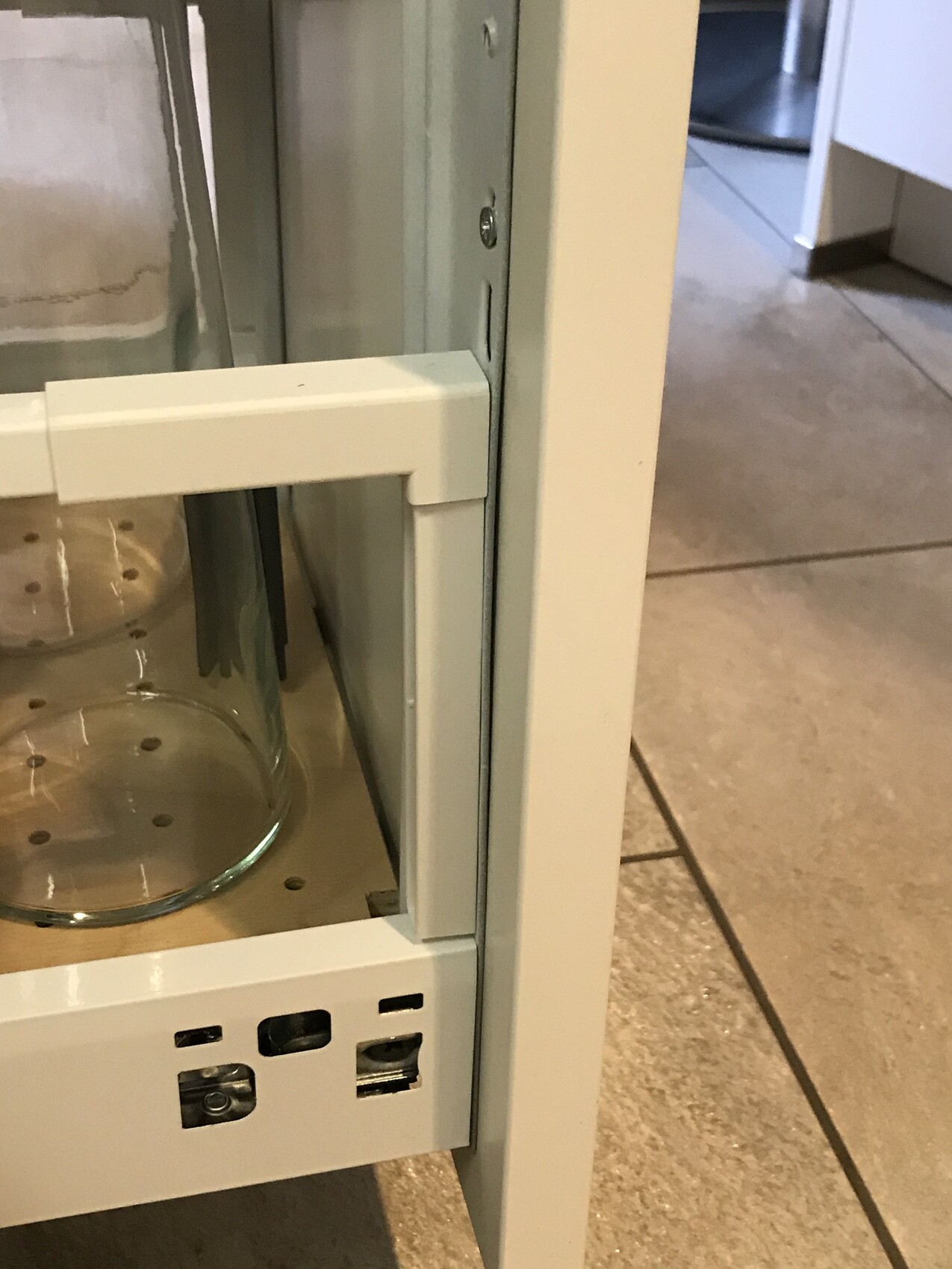

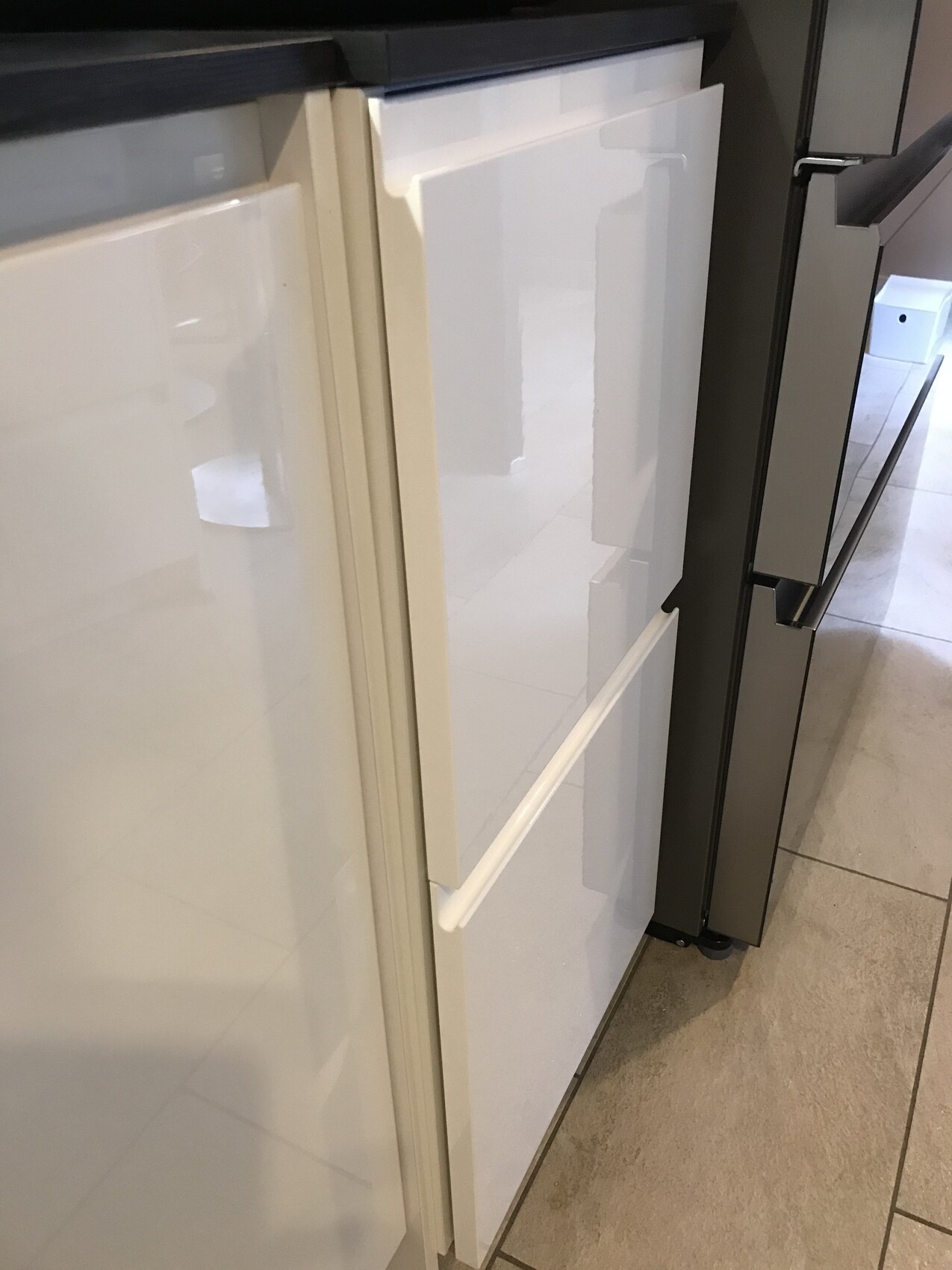

A long time ago, I was working on that cabinet.
I had planned to share my experience with the Ikea cabinet but then thought nobody would be interested. Now there are quite a few recent responses to this thread, so I’m posting some photos:
White under-counter refrigerator with handle next to gray kitchen units on tiled floor.
Pull-out kitchen cabinet with glass containers and lids on perforated shelf.
Small brown insect sitting on the edge of a light-colored cabinet front.
Open metal glass laboratory cabinet with glass front and round glass container on the shelf.
Gray drawer cabinet with two drawers and flat handles; above a filler panel with glass container.
21 Jul 2021 17:54
Conclusion: The doors are connected with large internal hinges. They look unattractive and feel unstable. If you look closely (first photo), you can see that the door is not perfectly straight.
With the Nolte doors, you get a better and more substantial handle, even though both are the same thickness.
The Maximera cabinet came with a flaw right from the start. To put it this way: overall, the cabinet was quite expensive. Then there’s the amount of work involved, which I personally enjoy as long as it’s not more than 7 meters (23 feet) in length. In total, the cabinet is not worth the price it cost. If I had chosen a shelving unit, which would have been a unique piece visually, I probably would have enjoyed the design more. But that might also be due to the specific drawer design I wanted.
