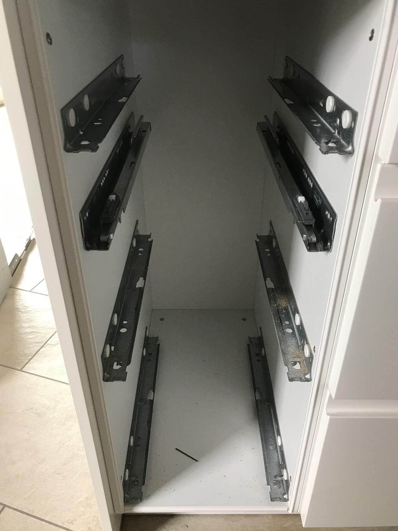

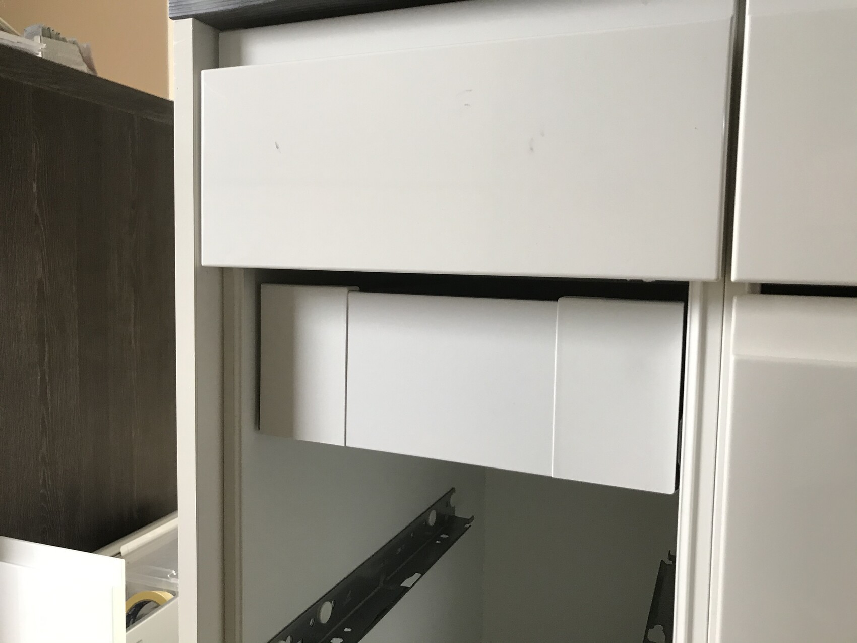

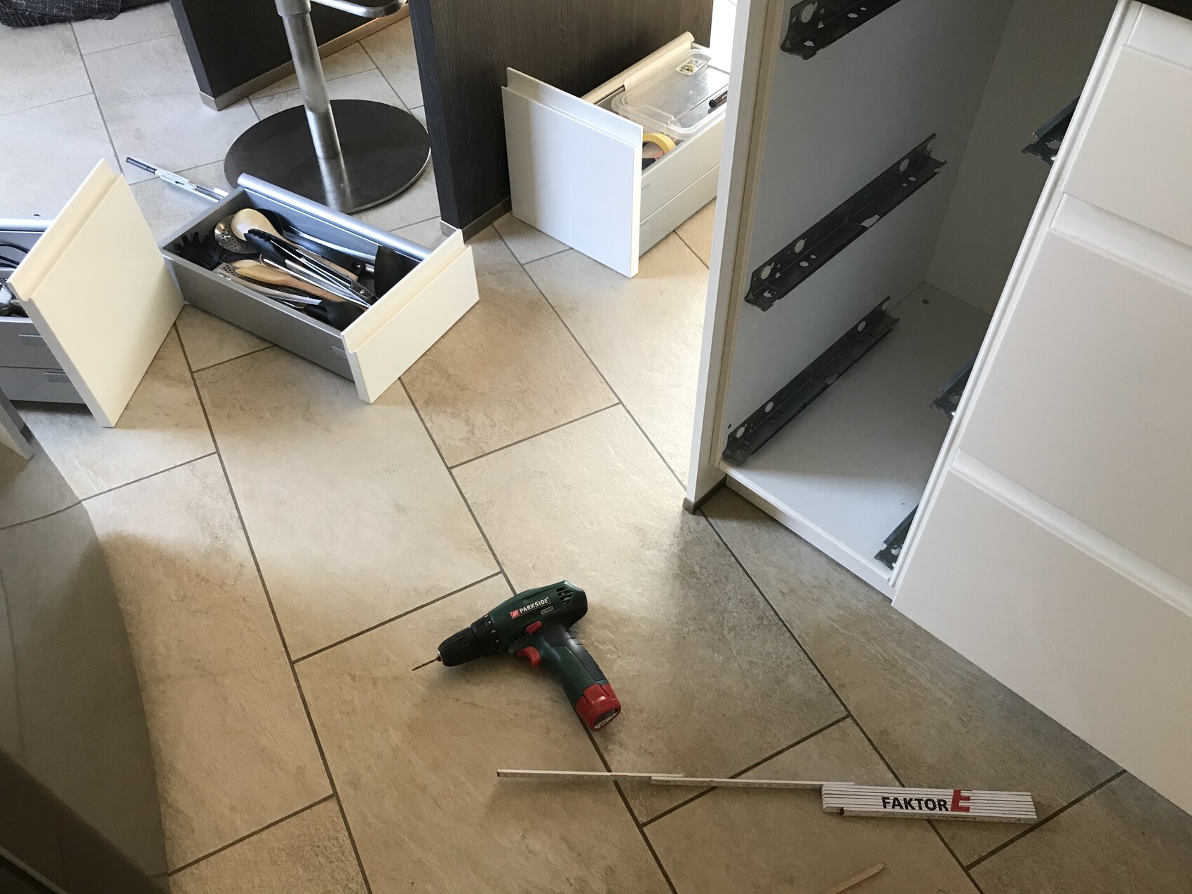

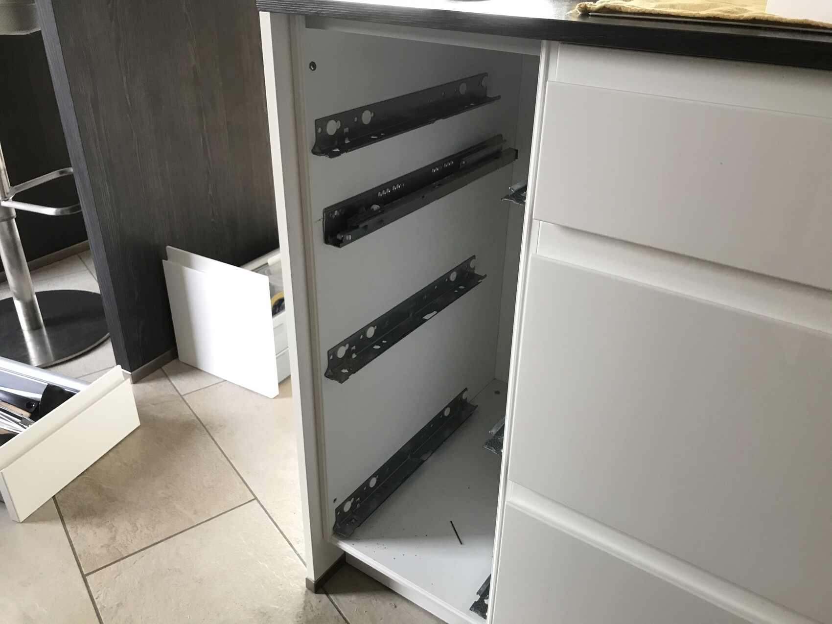

So! It’s done!
Since Küchen Geisler is quite unclear in their presentation and does not provide important details like measurements for consumers, I ordered a sample drawer from Ligno.
For just over €50 (about $55), I ordered a 30cm (12 inches) drawer plus rails, unfortunately not in silver gray as that was sold out.
It arrived within 4 working days, and today I installed it.
My husband was kind enough to hand me a cordless drill. (That said: when it comes to measuring, I prefer to do it myself calmly and carefully – unfortunately, I couldn’t find my hand tools later, like the screwdriver… ever since we got a caravan, everything is stored somewhere else 😀)
The result looks great:
... the next drawer for my spices in a 60cm (24 inches) cabinet is ordered :p

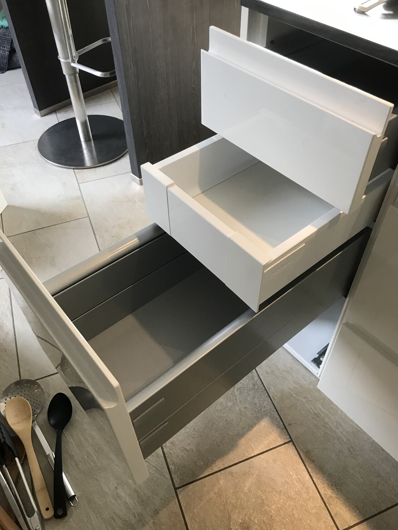

So... after 10 days the 60 cm (24 inches) drawer finally arrived and I quickly installed it myself.
I took a bit of a risk: it said to choose a depth 3 cm (1 inch) smaller than the cabinet depth. Since my cabinet depth is 52 cm (20.5 inches), I went with a 45 cm (18 inches) depth for the first drawer.
Now, for the 60 cm (24 inches) width, I ordered a 50 cm (20 inches) length. I didn’t see any measurable obstacles, but I was still a bit nervous when unpacking it. However, everything fits perfectly.
Now I finally have a bit more organization with my spices 😀
In the pictures, you can clearly see the difference in length, and of course, I installed the longer one more towards the front.
