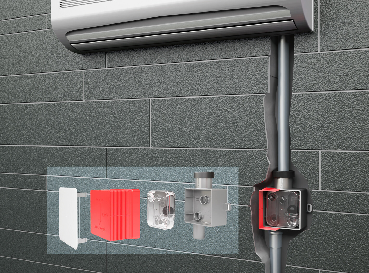

Steffen8020 Jan 2019 10:02I made some mistakes in the planning! But one thing I definitely got right, and my wife said several times in 2018, "That was the best decision" -> air conditioning from the start. The cost was about 10,000 EUR for high-quality Daikin units. Daikin is top quality. All piping, etc., is installed under the floor. Only three rooms are air-conditioned, with a total area of about 100m² (high ceilings). It ran almost the entire summer. Electricity costs were low, around 170 EUR, and absolutely worth every cent. Retrofitting is definitely more expensive... what most people forget: you need a drain for every indoor unit, and it must go downward. Pumping upwards is always problematic and often eventually clogs (due to dirt), and then you end up with water leaking into the room...

Important for wastewater: accessible traps, otherwise it will smell. We had a great climate builder who solved it perfectly (see picture)... Wouldn't it be easier to drain the condensate outside?
