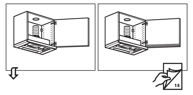

this concerns the installation of a Utdrag extractor hood into a 60x40 cm (24x16 inches) horizontal wall cabinet. There is a diagram in the manual that we do not fully understand, specifically this one:
Depending on the choice, the further assembly changes (especially the attachment of the brackets to the side panels for the offset bottom panel of the wall cabinet).
Unfortunately, the only difference we can see between the two photos is this odd gray line at the bottom edge of the door on the right image. Since we cannot identify what this is supposed to represent or whether it concerns us, we visited IKEA (Berlin-Lichtenberg) again today, where neither two kitchen department employees nor the service technician currently working on another kitchen installation in the showroom could help us.
So, what is that marking on the door supposed to indicate, and why would new holes have to be drilled in the side panels for the brackets?
