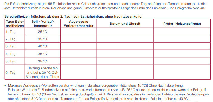

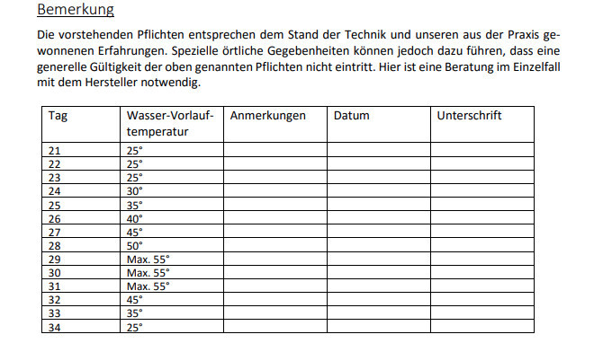

By the way, this involves cement screed without additives. I suspect that the timing and method of heating depend entirely on the type of screed and the additives used?Yes.There is a specific heating protocol for the screed.
An example for standard cement screed (although with today’s flow temperatures, 55°C (131°F) is often questioned – it seems to settle that 5°C (9°F) above the maximum flow temperature is sufficient):
With additives, for example:
There is so much talk about dry heating. I thought that functional heating is meant to test the operation of the underfloor heating system, not to dry the screed.
On the contrary, drying the screed too quickly (removing water) is actually not desired, because the water needs to bind through chemical processes and should not just evaporate. That is why there are these "careful" heating protocols. Otherwise, you could simply heat it up to check if the heating system works, and that would be it.
