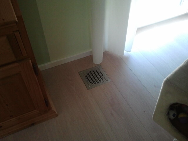

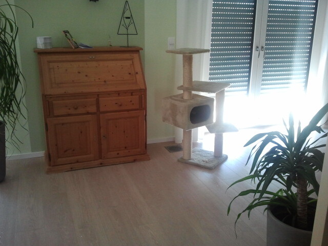

@Jaydee
Thanks for the photos. I’ve actually never seen it like this before. But I’m also not familiar with many houses that have mechanical ventilation with heat recovery; the houses I know are somewhat older, and in our new development, many have actually decided against it.
On the ground floor, we have white "discs" in the ceiling, and on the upper floor, discs located at the top of the walls.
