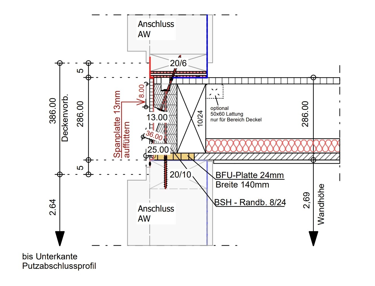

I am currently planning the installation of a canopy above my front door and am unsure about the best way to attach it. I have attached a cross-section to better illustrate the situation.
Specifically, I am concerned about how the attachment to the facade can or should be carried out to ensure the structure is secure while not damaging the thermal insulation (ETICS). Are there any special fixing systems or recommendations I should be aware of?
If anyone has experience or tips on this, I would greatly appreciate it!

For solidly built houses, there is, for example, the Thermax fastening kit from Fischer, which includes a bonded threaded rod with a plastic cone that braces itself within the insulation. You will need something like this to fasten into your ceiling joists. Everything else in the construction does not provide sufficient support.

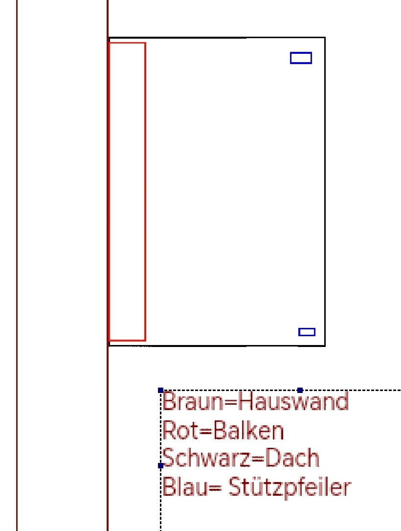

I would like to better understand how the porch roof should be correctly constructed to avoid any future warranty issues with the builder.
I imagine a beam being attached to the facade, with two support posts, and the roof structure built on top of that (simplified drawing attached).
Is this assumption correct, or how would this be professionally executed?

It always depends. You can take a look at the canopies, for example from Gutta. If the structure does not protrude too far, it can definitely work without supports. Beams attached to the wall are common with wooden constructions, but finished aluminum roofs are usually mounted directly with brackets.
