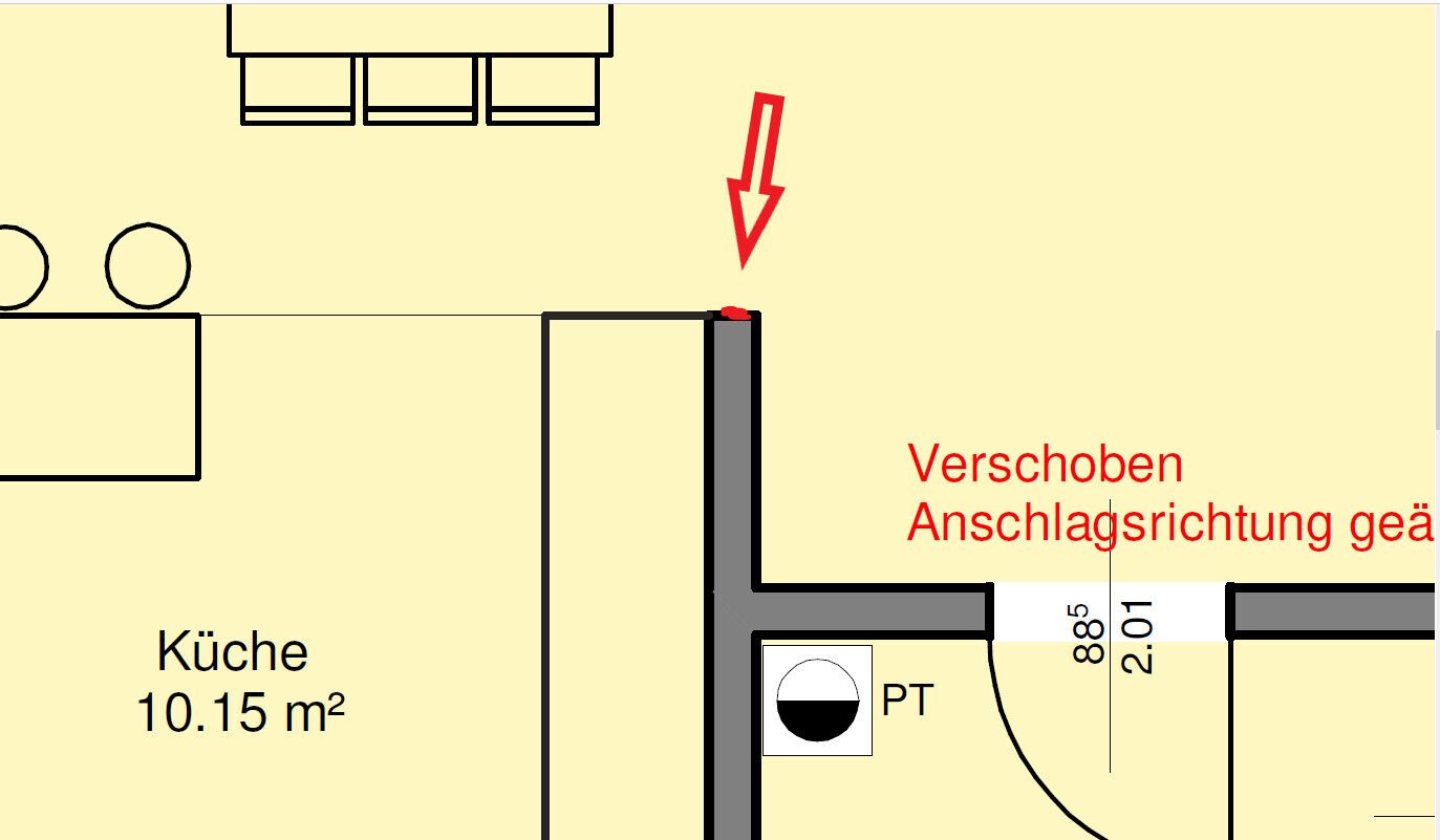

We are currently planning a single-family house and are in the process of fitting the kitchen. We have encountered a problem as we still need to find a place for the kitchen light switch.
My question is whether it is technically possible to install sockets and light switches on the narrow end of a 17.5 cm (7 inches) aerated concrete wall, and whether this is even allowed. Please refer to the attached image for a detailed illustration.
If this is not feasible, we would have to shorten our kitchen unit slightly to create some free wall space.
Thanks in advance for your help.

Knöpfchen14 Nov 2018 21:51
It is certainly feasible and also permitted.
But honestly, it doesn't look good.
I wouldn’t end the kitchen so tightly against the wall either. Presumably, a tall cabinet or something similar is meant to go there.
Is it possible to extend the wall a little further?
Dan859
14 Nov 2018 21:56
Knöpfchen schrieb:
Sure, it’s doable and also permitted.
But honestly, it doesn’t look very nice.
I wouldn’t end the kitchen so tight against the wall either. Presumably, there is meant to be a tall cabinet or something similar there.
Is it not possible to extend the wall a little bit further?
The kitchen is currently set back about 5cm (2 inches) from the edge of the wall.
In the drawing, our architect only sketched a rough outline of how it should look, which is why the measurement shows flush.
Unfortunately, extending the wall is not possible, as it would then protrude too far into the room.
15 Nov 2018 00:03
We have 4 light switches on the load-bearing wall at the stairway landing, and I must say that looks better than having them on the edge of a wall.
Are there going to be tall cabinets placed there?
Basti270916 Nov 2018 08:23
We have 4 switches installed on the front side of a 17.5cm (7 inch) sand-lime brick wall in our kitchen, so basically just like you... I can’t really complain about the appearance.
