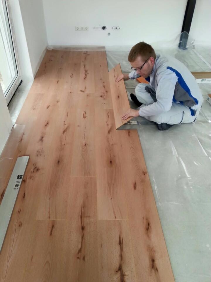

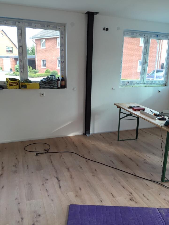

Pandrion20 Apr 2016 05:44
Interior under construction: two windows, black beam, workbench with tools, cables on the floor.
Worker laying light wooden planks as new flooring in a room.
Classen Click Vinyl Prestige, Müritzer Beech decor. Purchased from an online store at 14.99€/m² (1.39 USD/sq ft). Very satisfied with the appearance, quality, and installation method. Click-lock system: hook, fold down, then the next plank.
