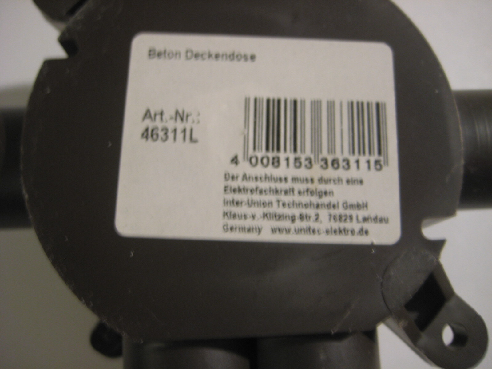

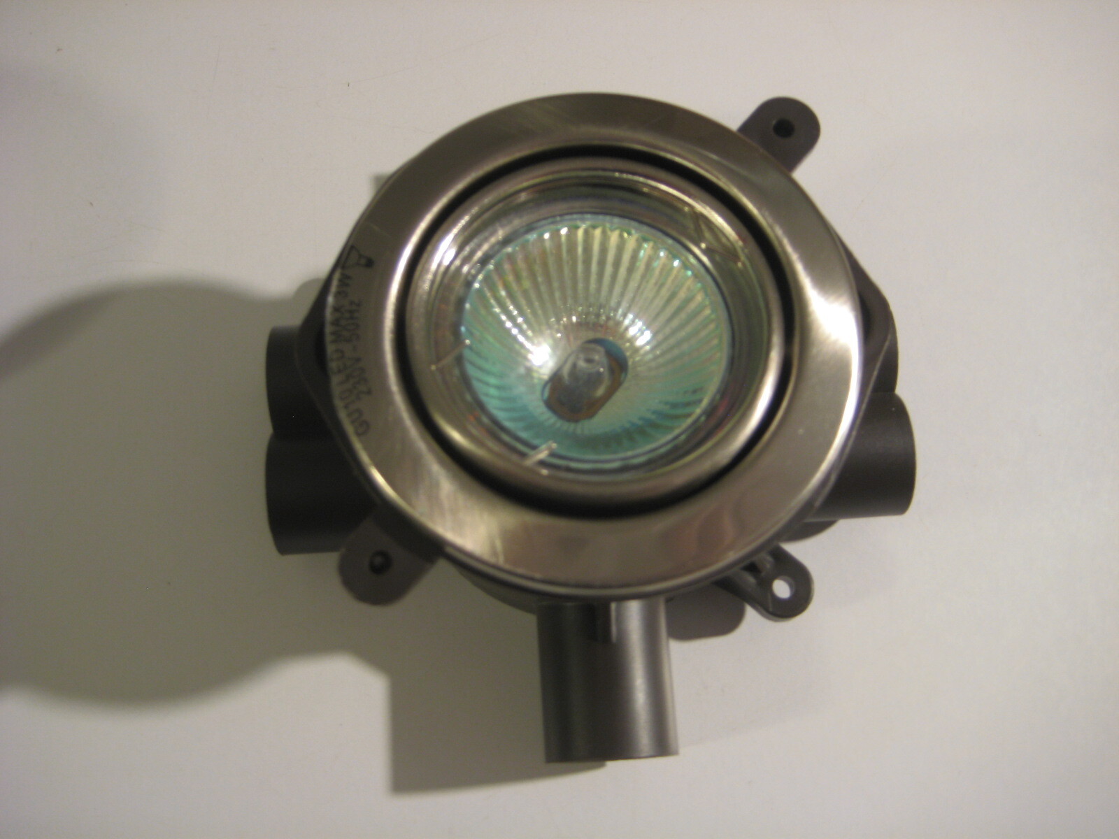

what is the best way to install spotlights in a ceiling if I don’t want to modify or plaster the cast-in-place concrete afterwards? We want to keep the concrete visible in the hallway on the ground floor to maintain the rustic charm.
I was thinking about using the Kaiser concrete slab ceiling large junction box. Fix it to the formwork boards with nails, pull the cables through, and that’s it. The spotlight to be installed should fit inside and the frame should cover the box.

I have placed and dimensioned every spotlight, ventilation opening, etc., using a sketch and noted the installation housings to be used. For the recessed spotlights, I am using Kaiser installation housings designed for exposed concrete. For other openings, I coordinated the exact core drill size in advance to minimize patching.

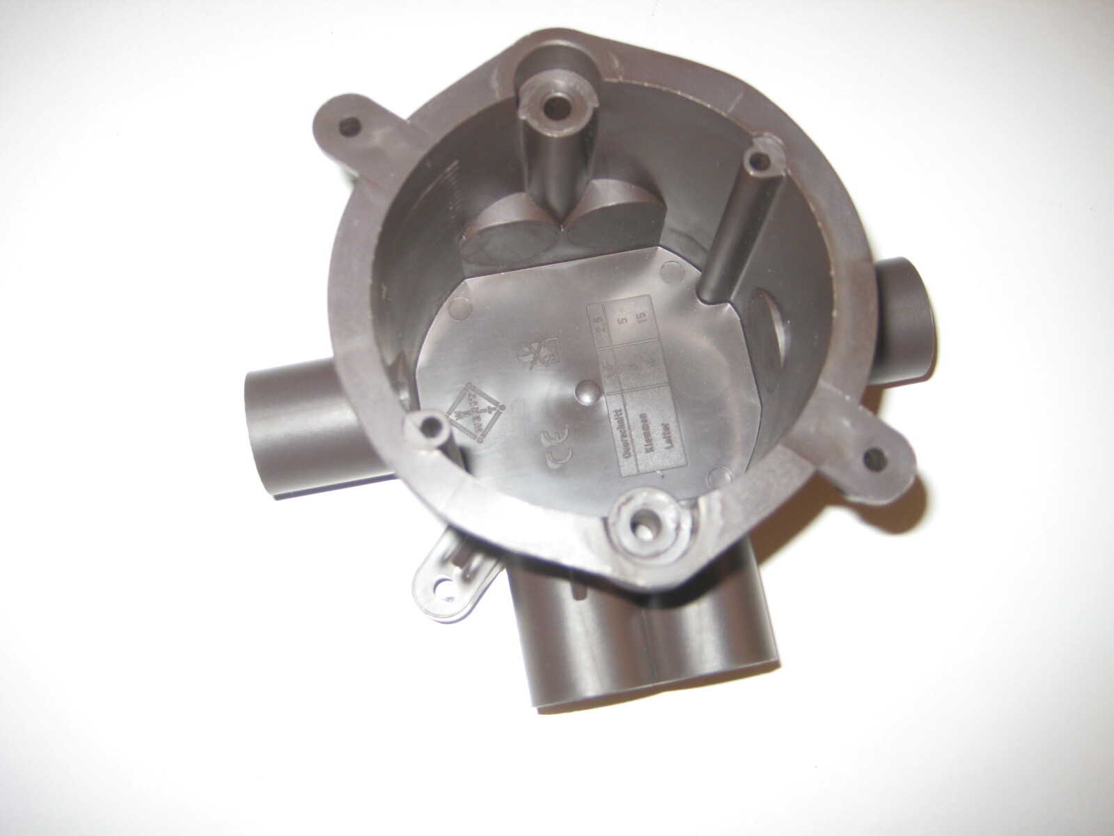

Hello Daniel
I do not recommend using nails. Make a template, mark the openings where the screws will go in from below (I have my empty boxes from the hardware store, which have these openings). Drill a 2mm (0.08 inch) hole through the formwork panels. Then fix the empty boxes from below with suitable screws (2.5 x 35mm (0.1 x 1.4 inches)). Tighten well, and you will have a perfect edge.

koettel8917 Jan 2018 11:35Hello Steven. Which boxes do you mean?
