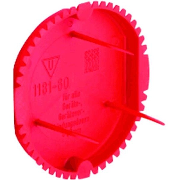

kaho6742 Jan 2019 21:08
We have recessed it completely / flush. Then a red cover was placed on top, which will be plastered over and has small red tips indicating the location of the box, so the opening can be easily found later and carefully exposed. 🙂

Gerd&Jolanthe
2 Jan 2019 22:30
kaho674 schrieb:
We recessed them completely / flush. Then a red cover was placed on top, which is embedded in the plaster and has small red points indicating the box location, so the hole can be easily found later and carefully uncovered. 🙂
I will most likely set them flush as well, and where I have limited space, possibly like Bookstar.
