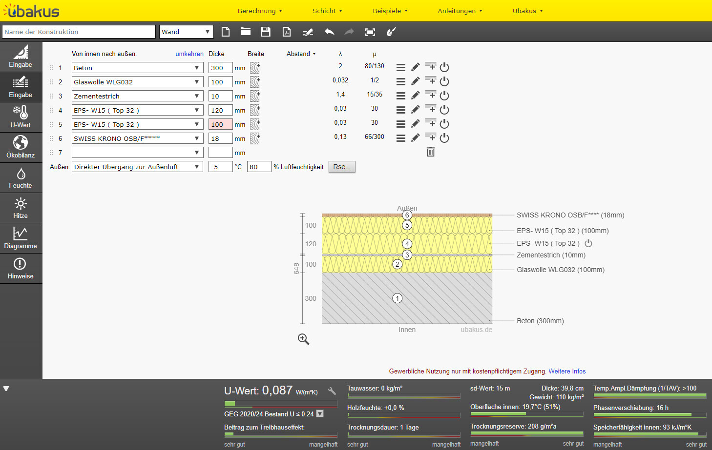

This is roughly how the top floor ceiling is constructed. I am not sure whether a vapor barrier membrane was installed between the insulation and the screed, or between the ceiling structure and the insulation.
Cross-section of a wall structure in the component calculator: concrete (300 mm) and insulation materials.

daFraunz schrieb:
It is a reinforced concrete slab
You don’t need anything else. It’s unnecessary
