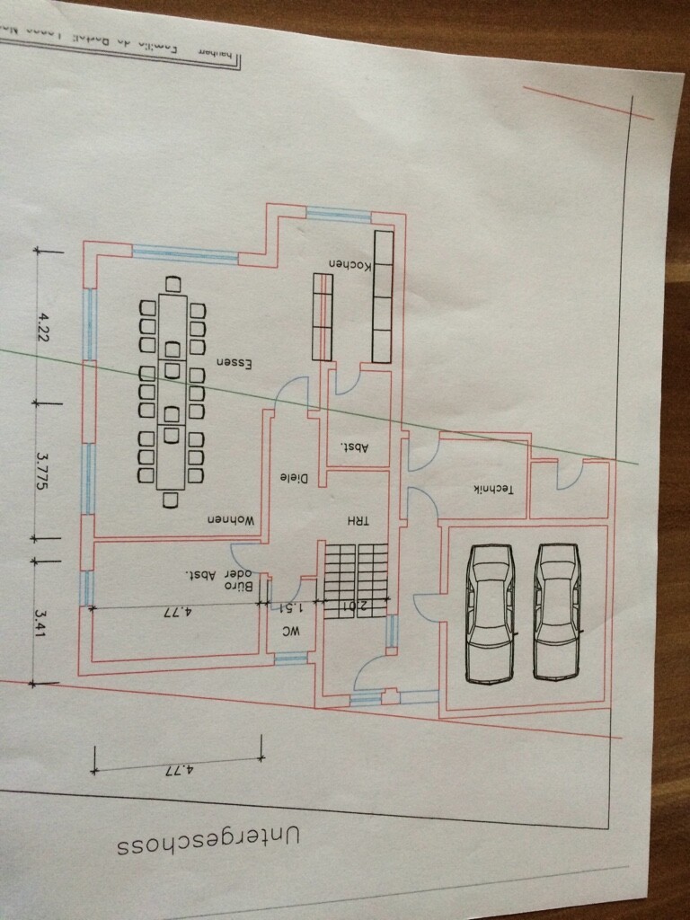

Our double garage will be built directly attached to the house. Since a basement is not possible, I just thought about relocating the utility room into the garage.
Is this feasible?
Is this feasible?
@bortel: Utility connection fees include a flat length of the lines, for example 12.5 meters (41 feet). Any length beyond that must be paid per meter, but this usually remains within reasonable limits. However, whether longer distances are preferable is discussed, for example, by @Jochen 104.
I just wanted to know if it is generally feasible. A colleague of mine said it wasn’t possible for him. The water meter and gas connection should have the shortest route from the street to the house, which is why, in his case, they are located in the garage next to the door in the corner.
Our architect’s suggestion is to have the utility/technical room behind the garage. Now I’m unsure if this is possible.

bortel schrieb:
I was only asking if it is generally feasible.Anything is possible!!! Whether it makes sense is another matter, and @Jochen104 has explained it well (long piping routes to the installations INSIDE the house, longer waiting times for example with water).
Also, keep in mind that the connection lines outside the house must not be built over – in emergencies, digging will be necessary... which means additional costs per meter...
bortel schrieb:
A colleague told me it wasn’t possible for him. The water meter and gas connection should follow the shortest route... “Should” means something different than “must”!
