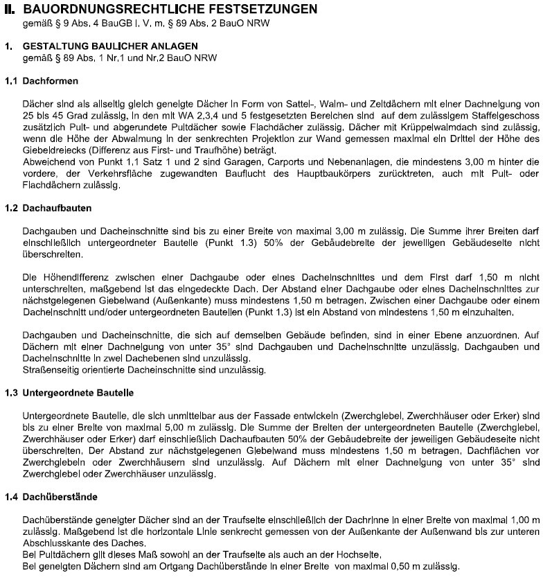

I have attached an excerpt from the building regulations in case there are any specific questions.

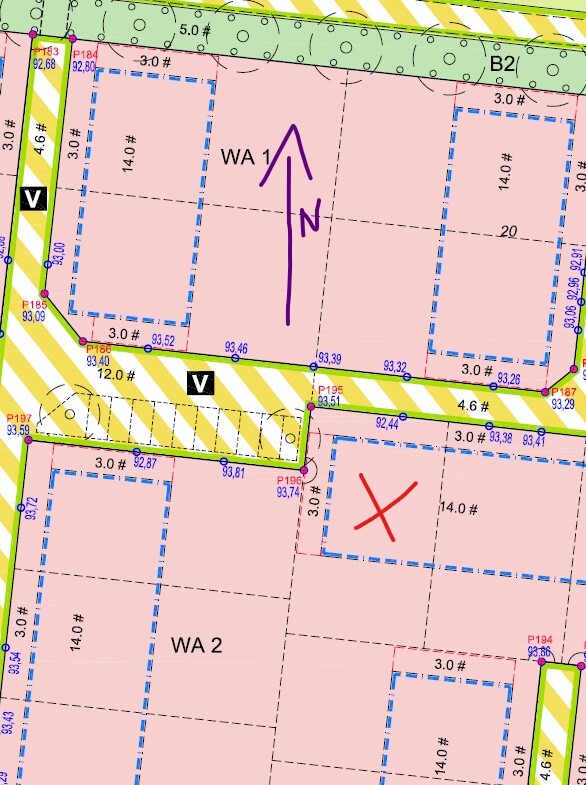

Or face north: but then a photovoltaic system cannot be effectively installed Orienting it: onto a plot, which is unknown here... Are you in the WA section 2-4? Or are you in WA 1?
Do the 25-degree rules also apply for shed roofs? I didn’t see that quickly… that is quite a steep pitch for a shed roof...

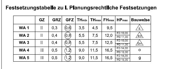

THmin: 5.5m (18 feet) That is quite unusual, and I would like to look it up myself.

That is very unusual and I would like to read about it myself.I have attached a screenshot of the regulation table. I only have the development plan as a PDF and cannot upload it.
The plot is located in the Rhineland region, in the Heinsberg district.
