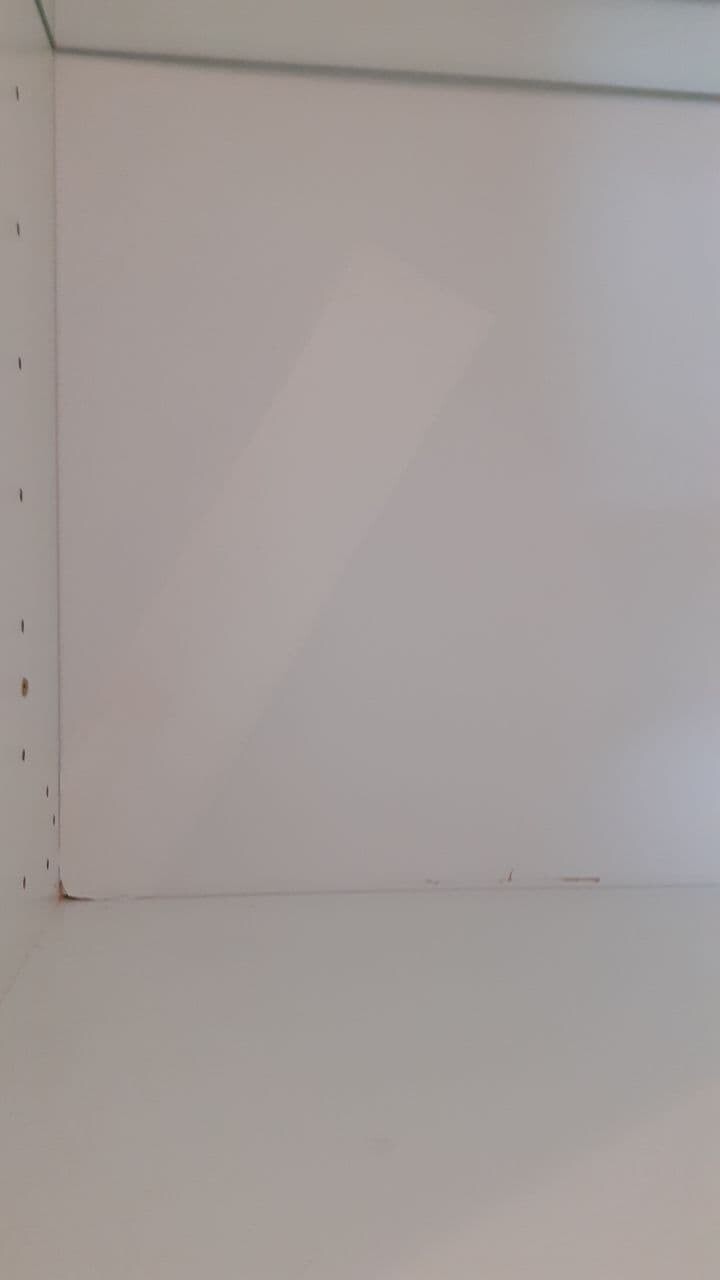

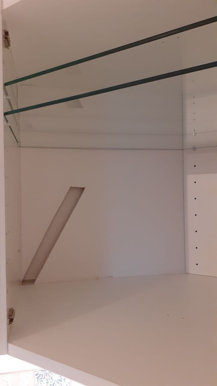

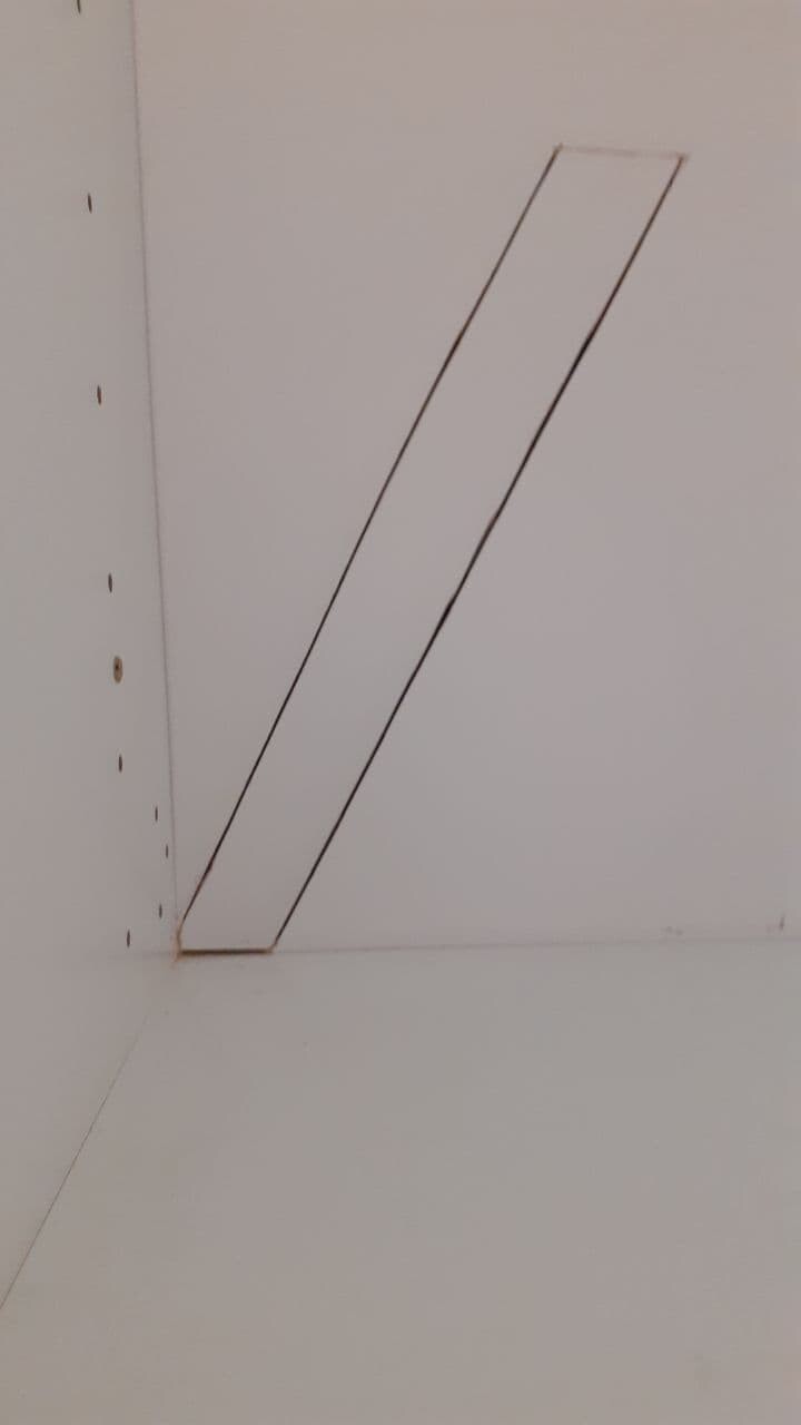

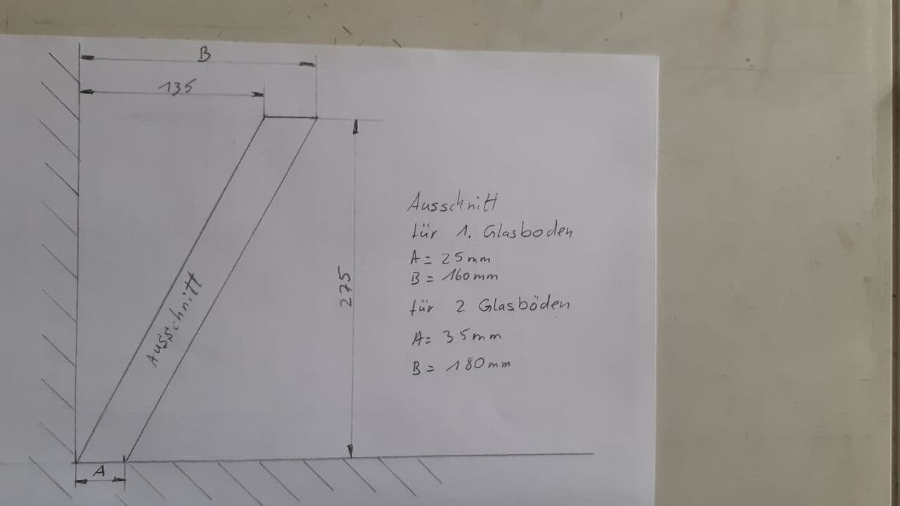

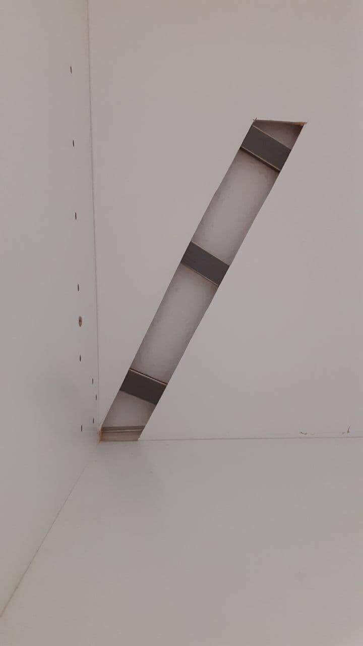

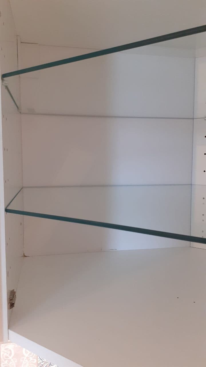

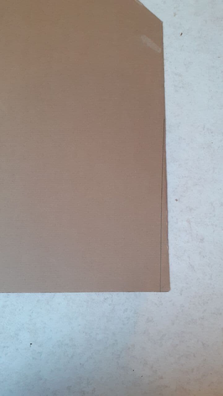

I was also looking for a solution for 600mm (24 inches) high corner cabinets, and I have one to offer. I was somewhat annoyed with Suzie.Bode (see above).
Initial consideration: Shortening the glass shelf at the back. A 15x300mm (0.6x12 inch) triangle. Unfortunately, this is not possible. The glass shelf is made of tempered safety glass (ESG). It cannot be cut or ground down. (According to the glass company). For wooden shelves, this would be a possible solution with adjusted dimensions.
Solution for glass shelves: Cut into the back panel.
The cut-out needs to be different sizes depending on whether you want to install one or two glass shelves. I’ve attached a few pictures, hope that works.
Procedure:
Mark and cut out the opening (using a multi-tool)
Smooth the edges (front and back, including the cut-out strip)
1. Insert glass shelf and rest it on the bottom
2. Insert glass shelf and place it on the top supports
1. Place the glass shelf in the lower position
Attach a cross brace (approx. 8-10cm (3-4 inches) long) to mounting tape, feed it through the cut-out, and stick it from behind onto the back panel.
Glue in the strip
Cover with D-C-Fix foil.
I’m glad I didn’t have to take down the wall cabinets.
