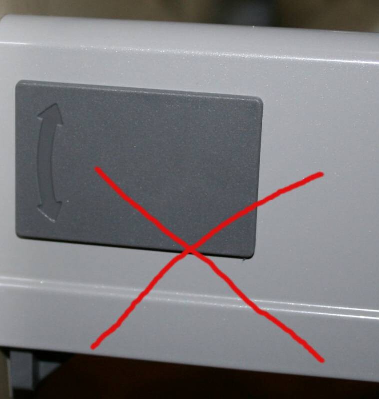

For drawers that look like this on the side
Close-up of a gray control panel with a sliding switch and a red X.
, they don’t always lock in properly. In this case, you can reach under the front of the drawer by hand and pull the rails with the gray plastic part towards the front until you hear it click into place.
