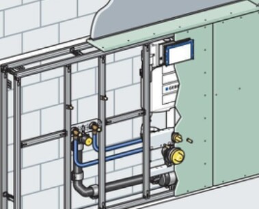

I am looking for an affordable and neat solution to repair a new concealed (in-wall) toilet cistern.
… and first, a bit about the building conditions.

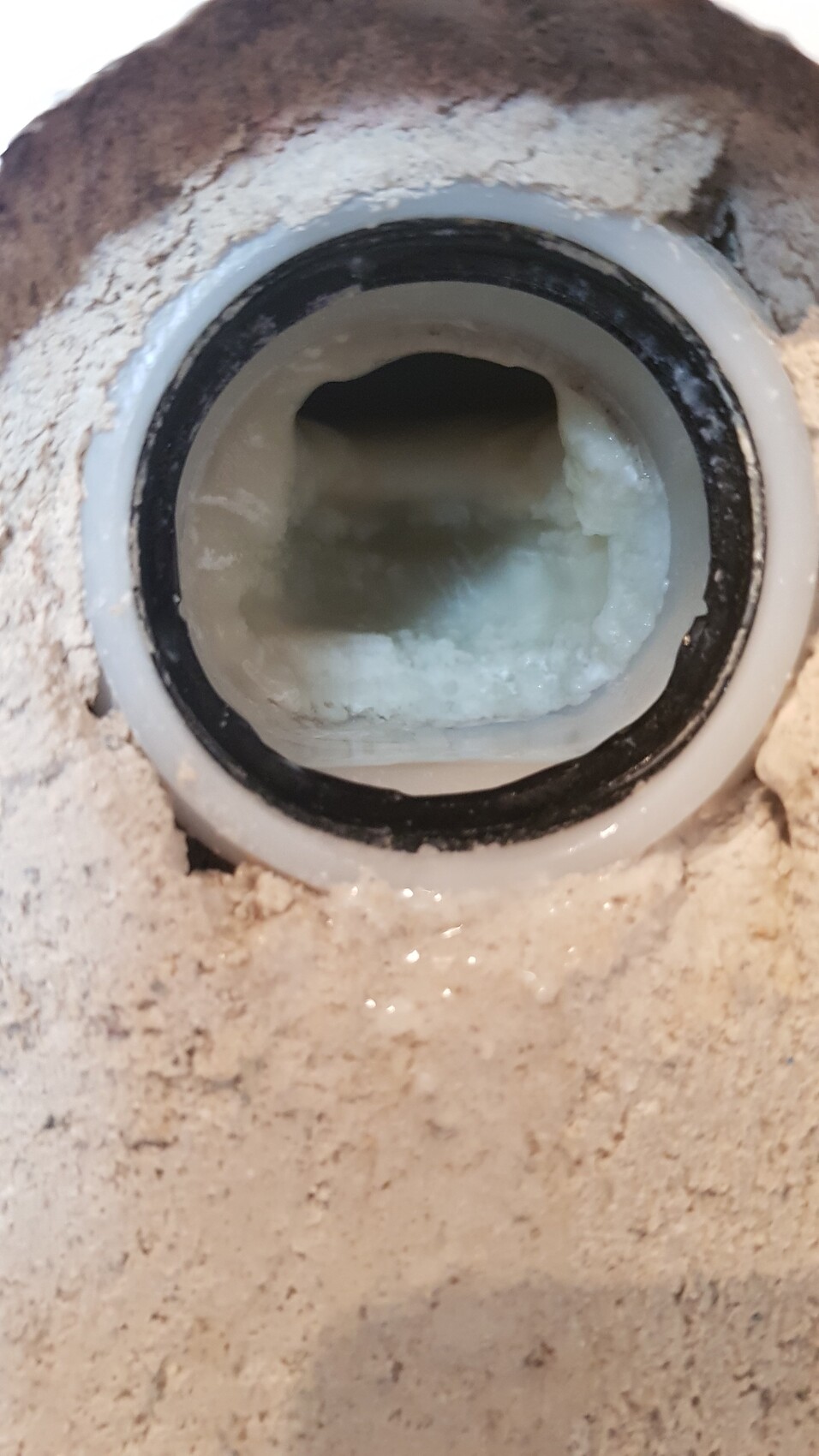

We moved into our detached house almost 25 years ago. Water hardness is 24 dH. During 2023, the water flow when flushing the toilet gradually decreased. In late autumn, I spoke to the plumber, who said the problem was with the toilet, as it was heavily scaled under the toilet rim and needed to be replaced. However, the toilet had already been replaced once before. I insisted that he should first check the concealed cistern.
Since now almost no water is flowing for flushing, the plumber finally checked the setup last Friday. He removed the toilet (which is only slightly scaled).
Cause: the water supply pipe to the cistern behind the wall is completely scaled, with fresh water only passing through a tiny opening to flush the toilet.
Removing the limescale from the pipe was not possible – it is rock solid.
We want to apply descaling agent through the cistern into the pipe tomorrow and let it work for several days.
What should we do if the limescale does not dissolve?
Are there any solutions available?
The supply pipe and the concealed cistern are entirely installed inside a stud wall, similar to what is shown in the attached file.
Does any expert know a clean, inexpensive solution?
Thanks in advance.

My question is: The inlet pipe from the flush system to the toilet is completely clogged with limescale.
Close-up of a round drain pipe with seal and limescale deposits.
Close-up of a round drain with brown deposits and water inside.
