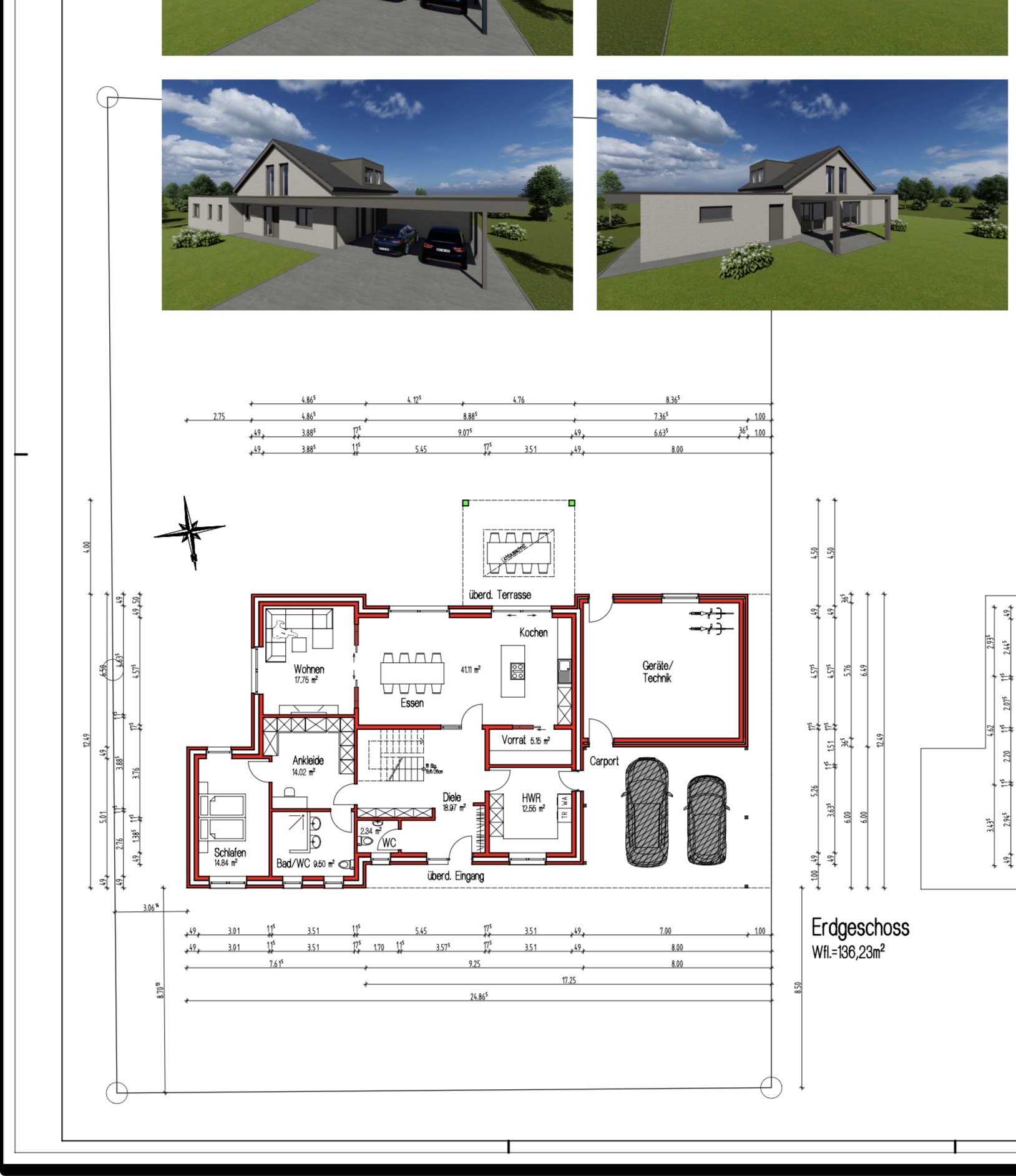

we would like to present our first floor plan draft and kindly ask for your honest feedback.
The house is designed for 2 adults plus potentially 2 children in the future and will be built on a rural plot of land. We are currently in the design phase and welcome all constructive comments and suggestions for improvement.
The plot is a backyard development, which means there are some restrictions. For example, we are not allowed to exceed a length of 7.0 m (23 feet) and an eave height of 3.7 m (12 feet). In addition, the assigned plots are not yet developed, so we will need to build a road access here.
On the site plan we were allocated plot number 4.
More details are included in the notes..

We wanted a home that is family-friendly, functional, and suitable for aging in place, while complying with the building plan.
The basic idea: parents live fully on the ground floor, children live upstairs.
We are still optimizing and would appreciate feedback on:
We look forward to your honest feedback!
What would you improve or arrange differently?
Thank you very much in advance for your time and suggestions.

We have now received the second draft. We are still not satisfied because several aspects of the floor plan do not yet suit us. For example, the walk-in closet is much too large, and we would prefer to use that space for the living area. There are a few other things we noticed that could be planned better. Overall, the design still feels too large to us, and we believe the room proportions are not quite right. We have now decided on a carport, but with a large storage room. We like how this is designed in the draft, and the utility room is also acceptable. We could do without the pantry if we can find a different solution for the kitchen, living, and dining areas.
This is currently our main focus. We would prefer not to have the living, dining, and kitchen areas in one straight line, but rather arranged in an L-shape with a defined living space. However, the extension in the first draft was too extreme. Perhaps this could be solved with an interior wall, for example, placing the TV on it?
Maybe one of you has some ideas?

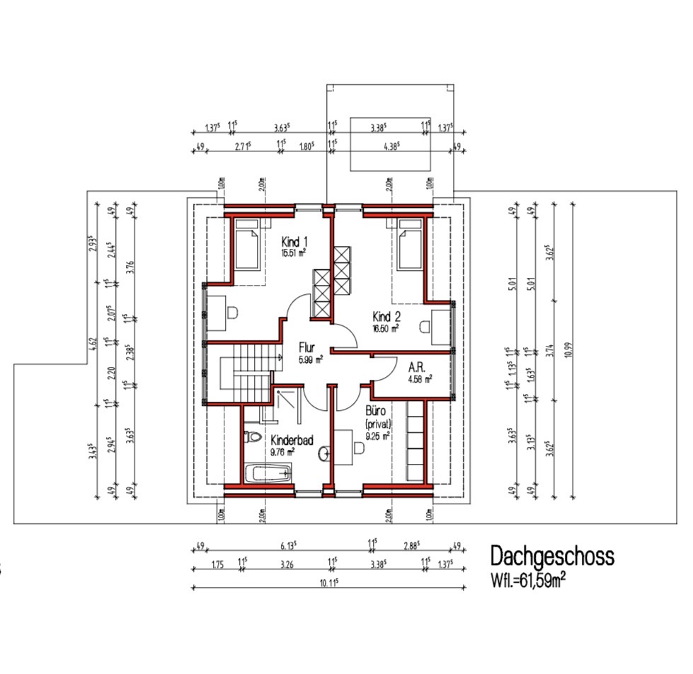

At first glance, we find the top floor quite good at the moment. Possibly, the office and bathroom could be swapped because of the waste chute.

Steiger schrieb:
A general question: Do you have any tips for a user-friendly architectural software that can be easily operated by oneself? I think we need to contribute more of our own ideas and preliminary floor plans to the architect. He is more of a structural engineer and can take on the role of the builder. This is why we would like to work with him. There is still room for improvement in the floor plan design. The essential tool is the "requirements profile," which belongs to design phase TWO - not THREE! - and should be discussed until it fits. As long as it doesn’t fit at this stage, you shouldn’t proceed (or if you have proceeded anyway, then only re-entering design phase 2 is the correct course of action). A structural engineer is a specialist and easily replaceable. Therefore, there is no reason to prefer an architect who includes this service. Besides, drawing floor plans is a basic exercise that a competent architect could do before breakfast in their first semester. If not, I would definitely not trust them with the more complex aspects of their work on my project. Moreover, a layperson is not a good coach for supervising an architect’s drafting if the architect struggles to interpret client requirements—assuming that is the case. More likely, the issue lies in communication if clients feel misunderstood. For poor understanding between sender and receiver, it’s enough if one of the “antennas” is not precisely aligned. Specialized software is aimed at professionals, primarily because it requires thorough training, experience, and continuous practice. There is software available for novices, usually with online tutorials, but the detailed plans can generally only be imported with limited success, leading to errors during compilation. This would not reduce misunderstandings but at best make them more "digital." A clearer language can be achieved with pencil and set square.
I think basically we will still need to revise the plans a few more times, which is fine.
We had considered removing the pantry and designing the kitchen in that space, moving the kitchen island and dining area more towards the garden, facing south.
The living area would then be to the left of the dining space. The living area could also be separated, for example, with a TV wall or an ethanol fireplace.
We will reduce the size of the walk-in closet. The block still needs to be revised.
