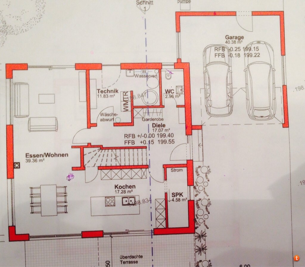

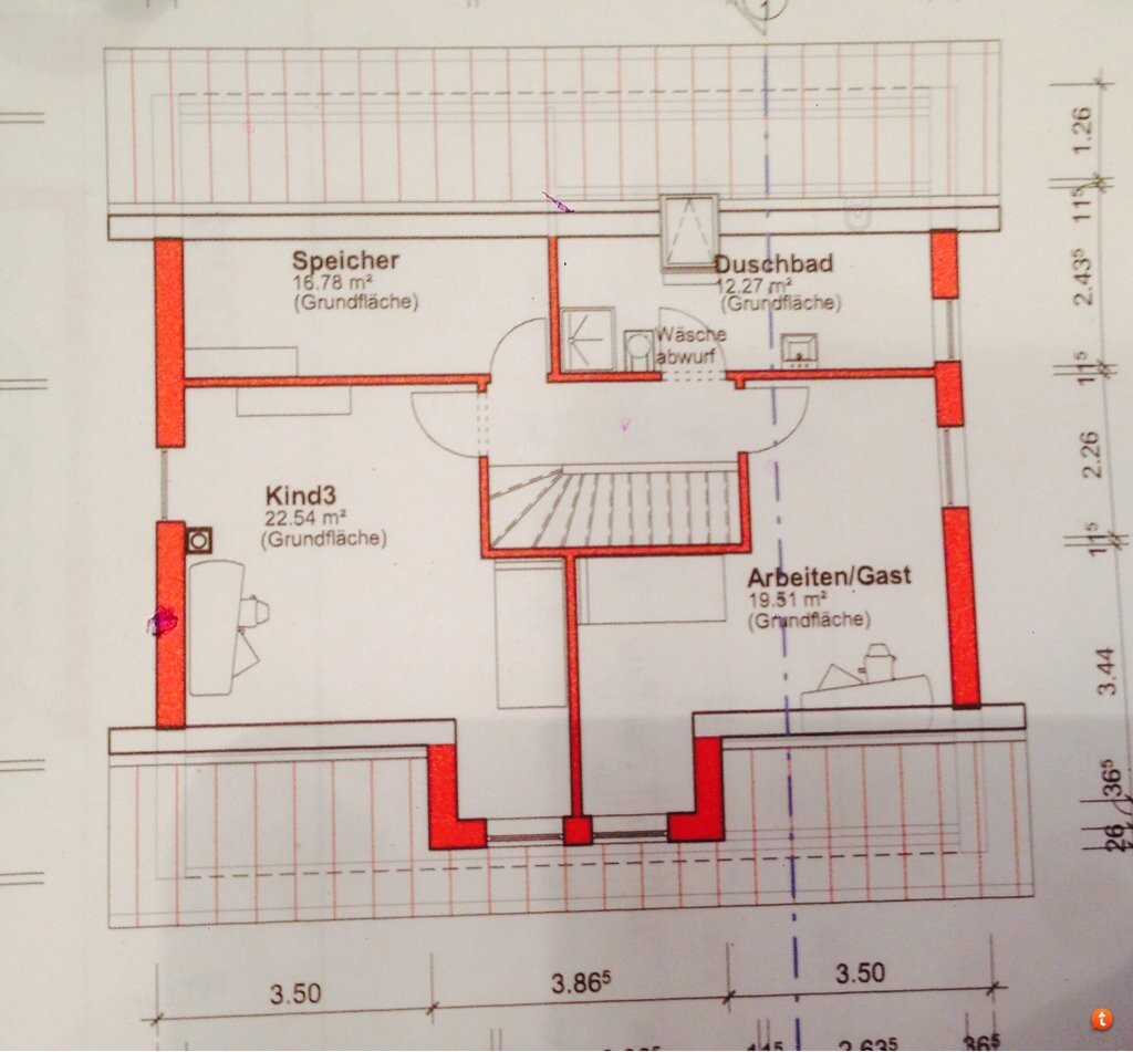

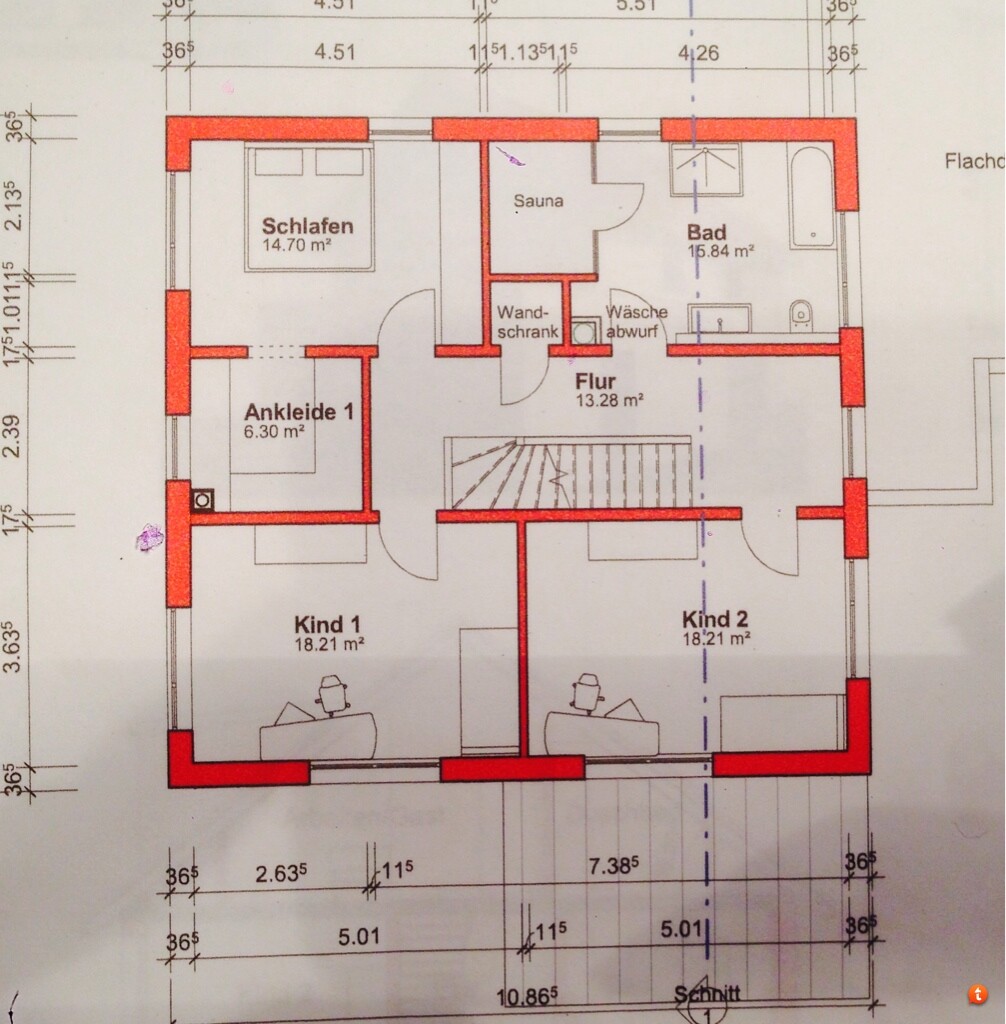

But you really should upload the floor plan again now – we don’t have your design clearly in mind at the moment. The position of the stairs and hallways also matters... Otherwise, we might end up recommending recessed floor-level spotlights, and you might want to cover the walls with cabinets 😀

We also installed LED spotlights in the wall for our staircase. However, we see this lighting more as a design element – while the stair treads are well lit by the spots, the rest of the space is only softly illuminated. That’s why we also planned for a ceiling light fixture in the stairwell in case we need very bright light there.
In your hallways on the upper and attic floors, I wouldn’t completely give up on having a ceiling light source either.
We faced the same issue but ended up choosing a completely different approach:
In the hallway ceiling, we installed a conventional light fixture that provides good overall illumination.
For nighttime, we installed outlets with integrated LED strips that automatically turn on and off via a built-in dusk sensor – these outlets are in the hallway and bathroom on the attic floor, so there is a nightlight along the way to the bathroom. The power consumption is likely negligible due to the LED technology.
