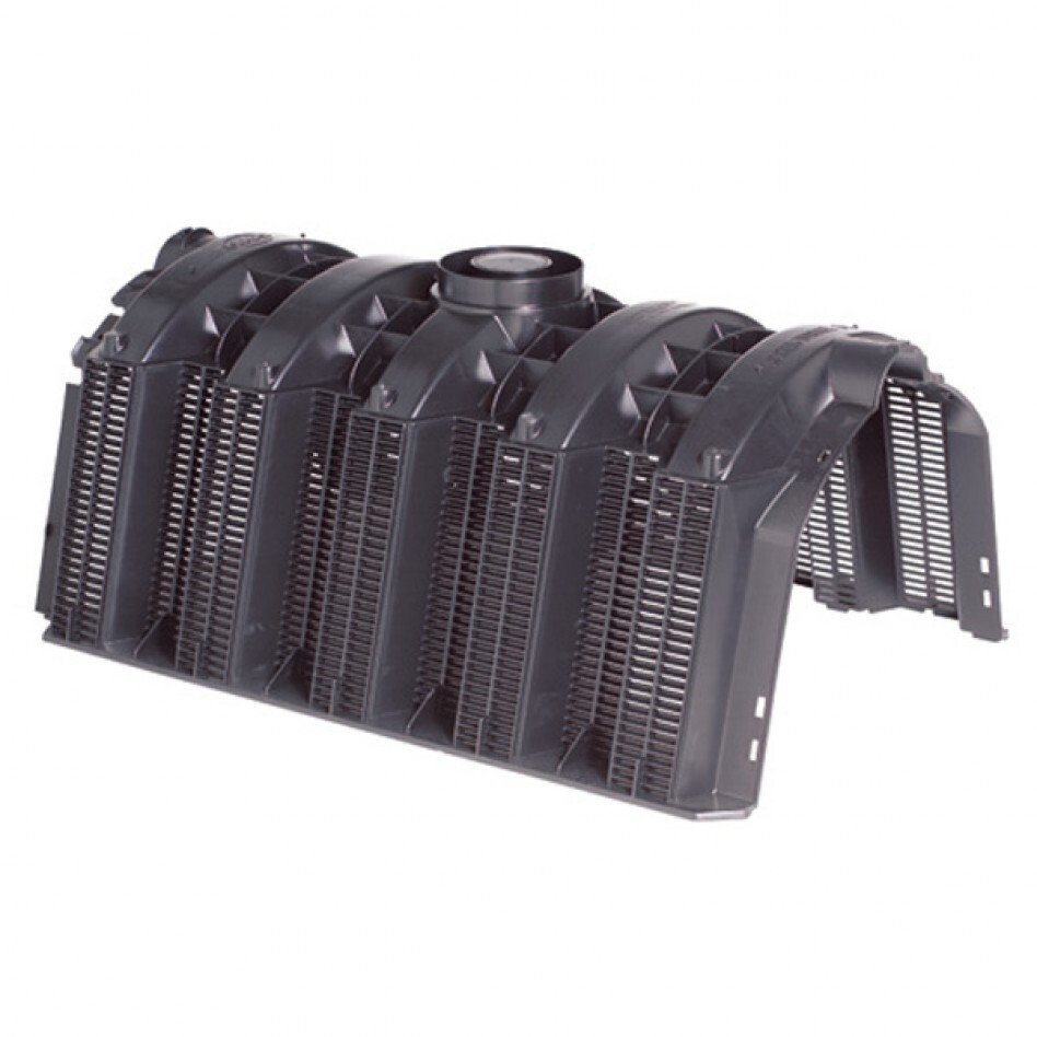

305er schrieb:
So, a volume of 3.3m³ (116.5 ft³) was calculated for the basin.It doesn’t matter. Just visit Graf’s website, download the worksheet, fill it out, and send it to Graf. Then you will know what you need and what a Graf infiltration system would cost.

I need a total of a 1200L (about 317 gallons) infiltration system.
It consists of a 300L (about 79 gallons) infiltration tunnel, so four pieces in total with a total length of over 4.64m (about 15 feet).
@RobsonMKK ...regarding your statement that infiltration boxes can be built deeper and “igloo” units only horizontally, isn’t that actually not quite correct?
Because this infiltration tunnel is installed horizontally, and an infiltration igloo...

Regarding your statement that soakaway crates can be built deep while soakaway modules (igloos) only in surface area, isn’t that actually not quite correct? I don’t understand your question. Soakaway modules can only be installed horizontally, how else would that work? With soakaway crates, you can, if necessary, build completely in depth.
