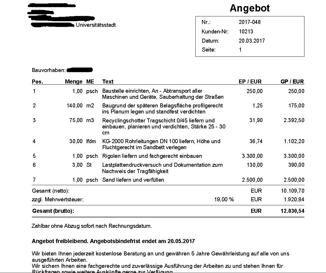

Now Iâm wondering which option is better or more cost-effective?
Attached is the offer, which also includes the trench soakaway.
The soakaway tank seems to be quite a bit cheaper??
I hope you can help me decide the best infiltration method.
