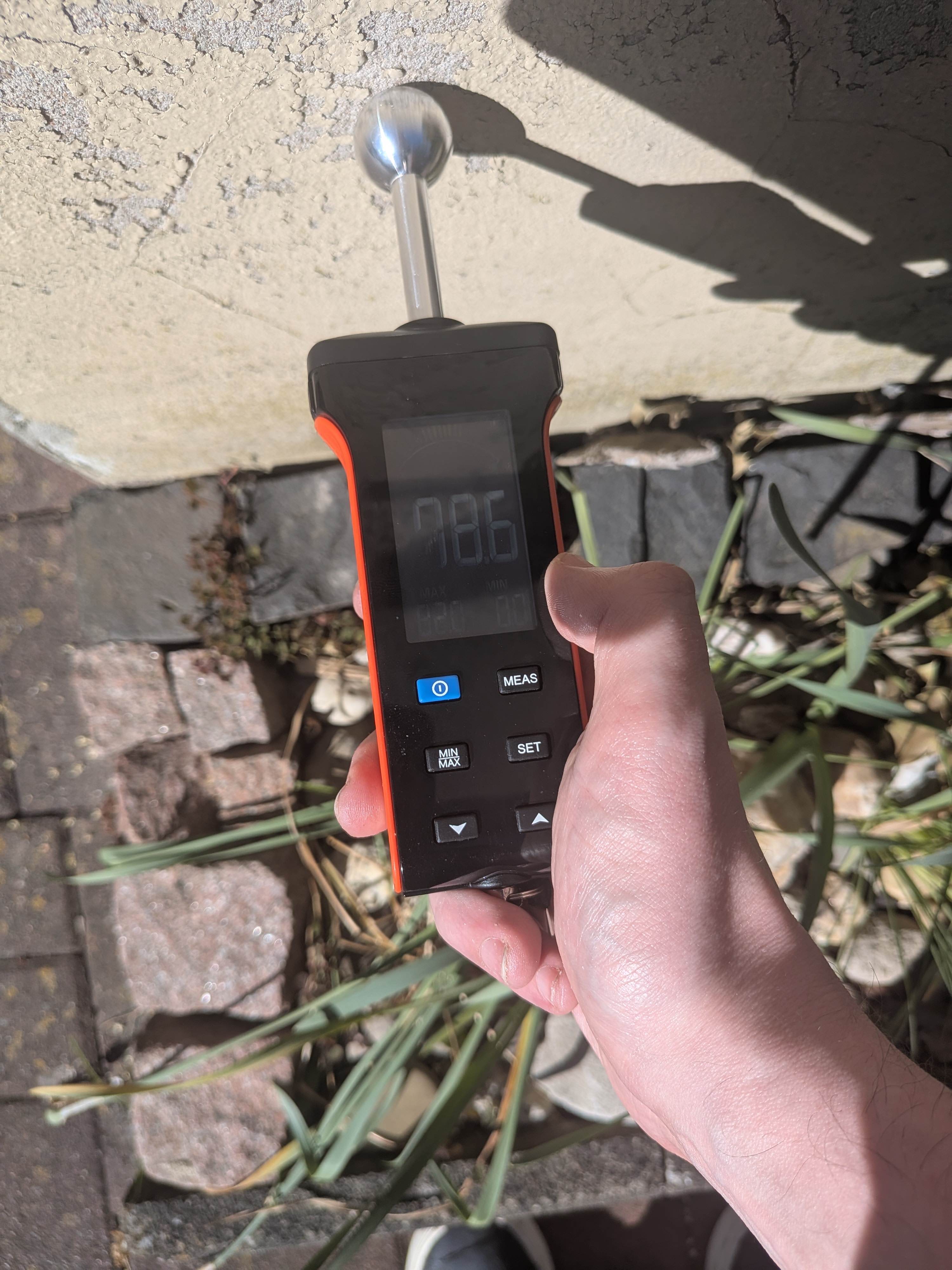

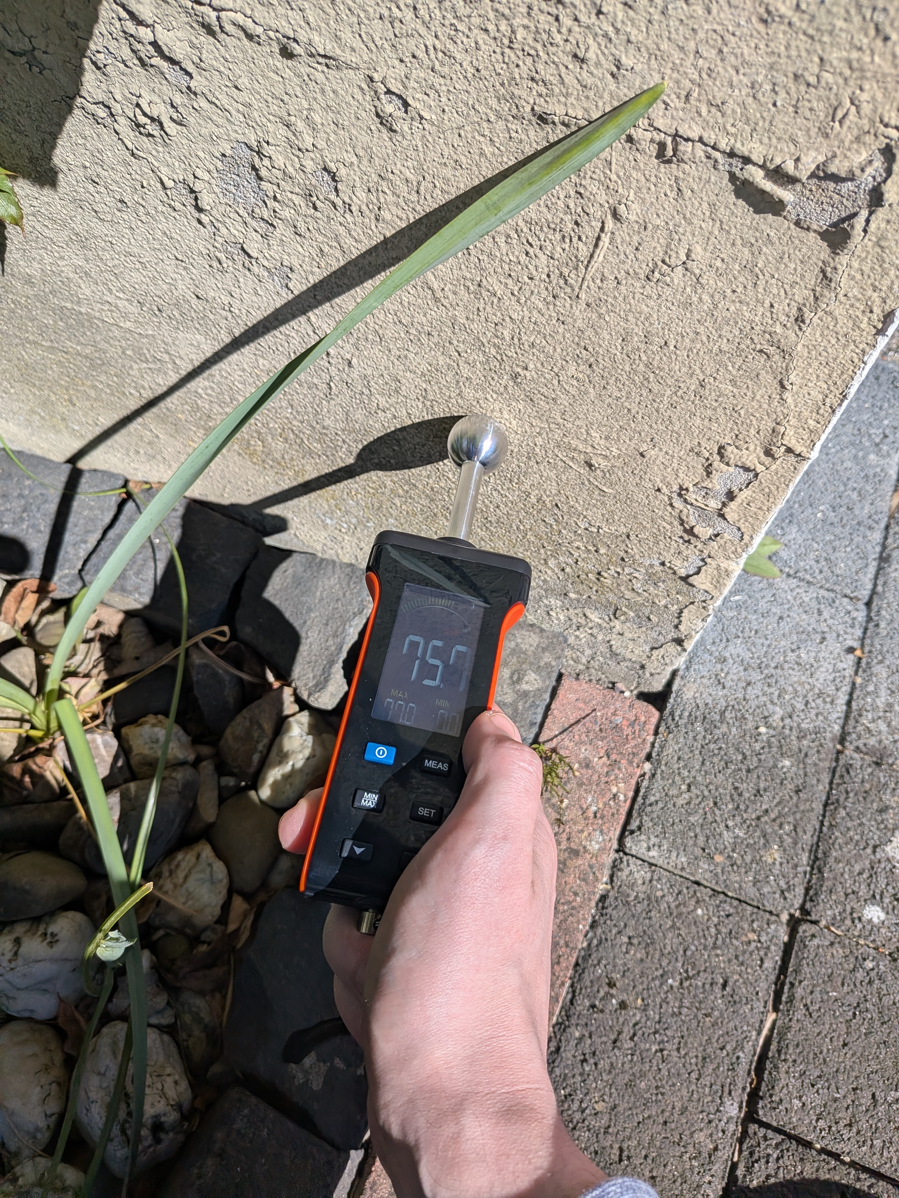

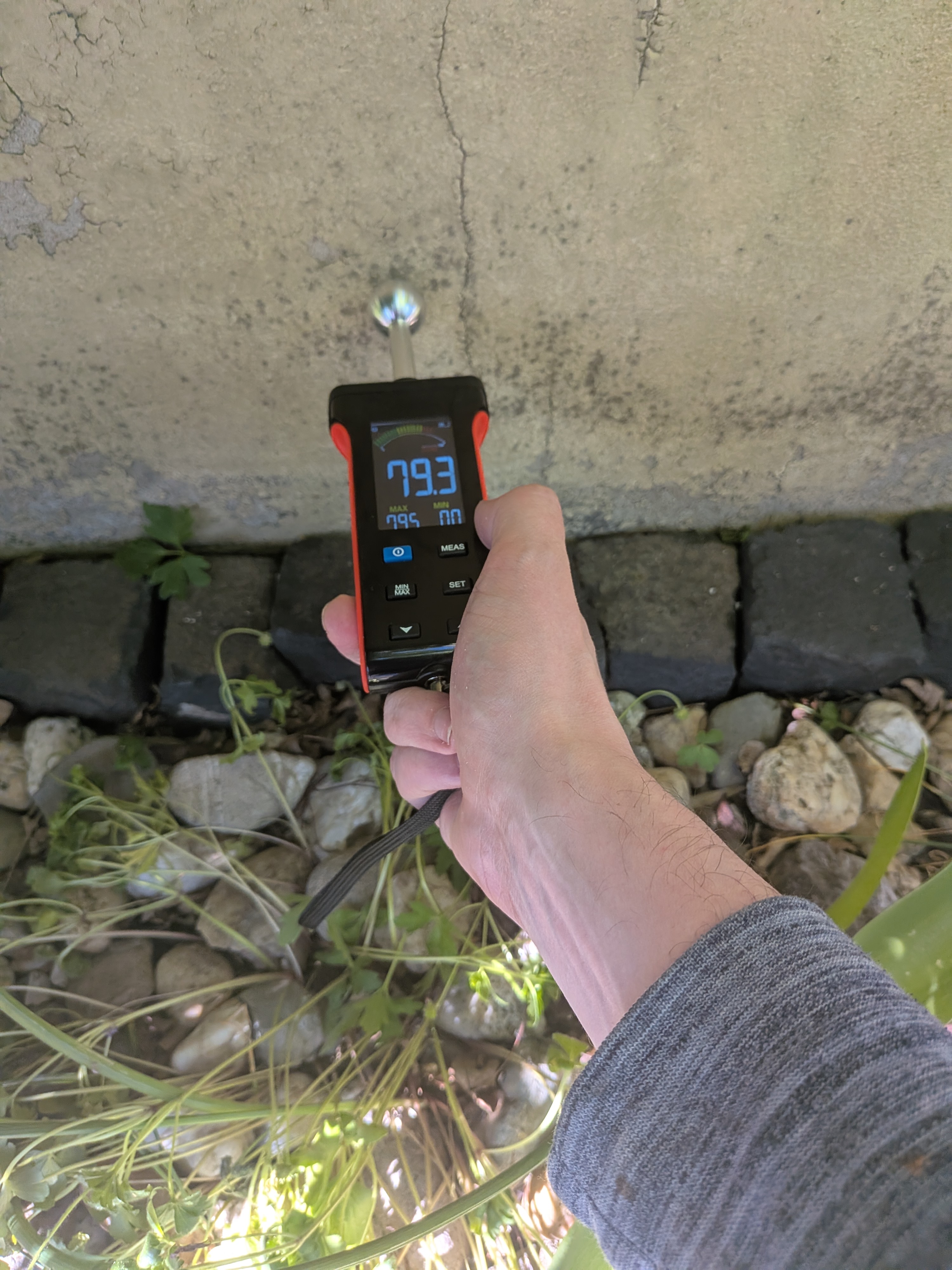

He definitely also checked the outside corner where the downpipe and the cellar entrance are located and took moisture measurements there
