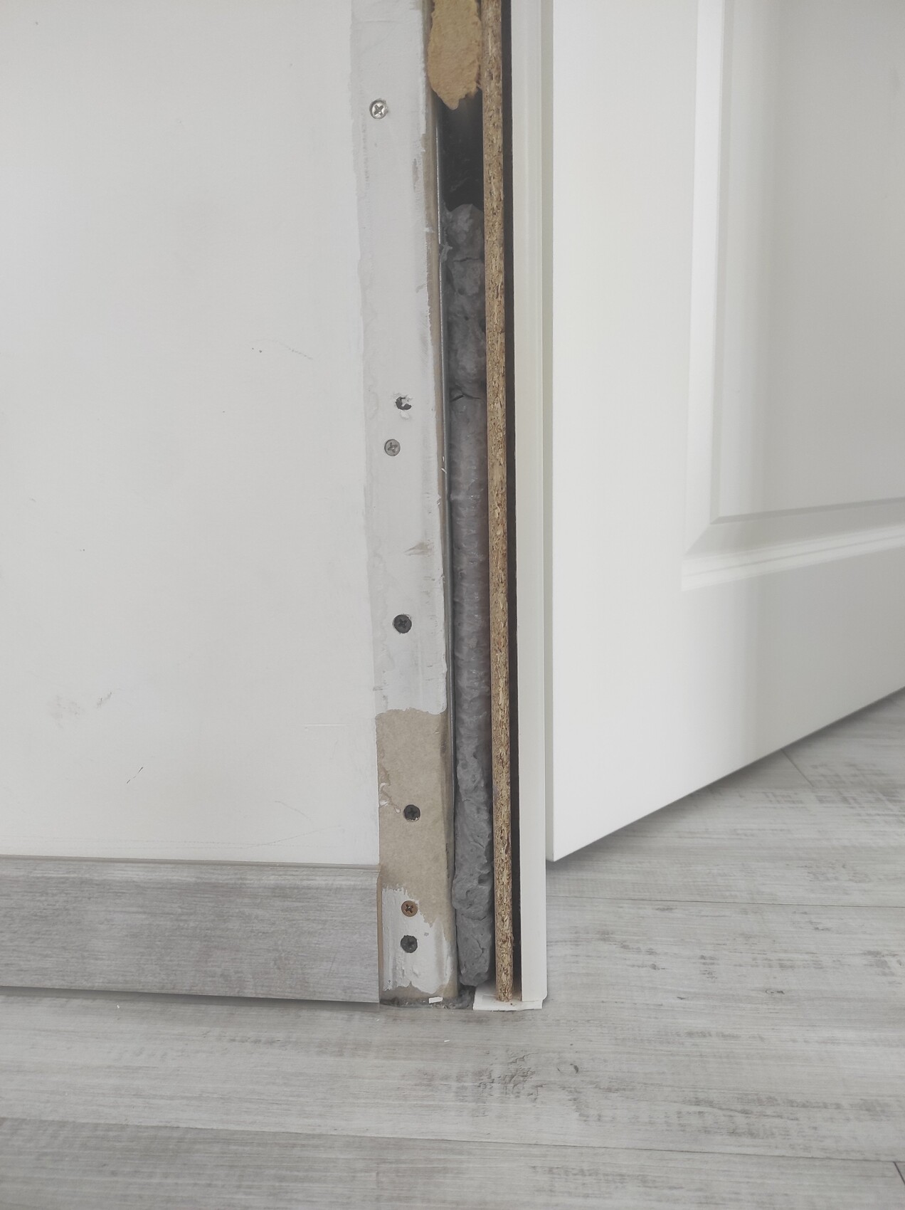

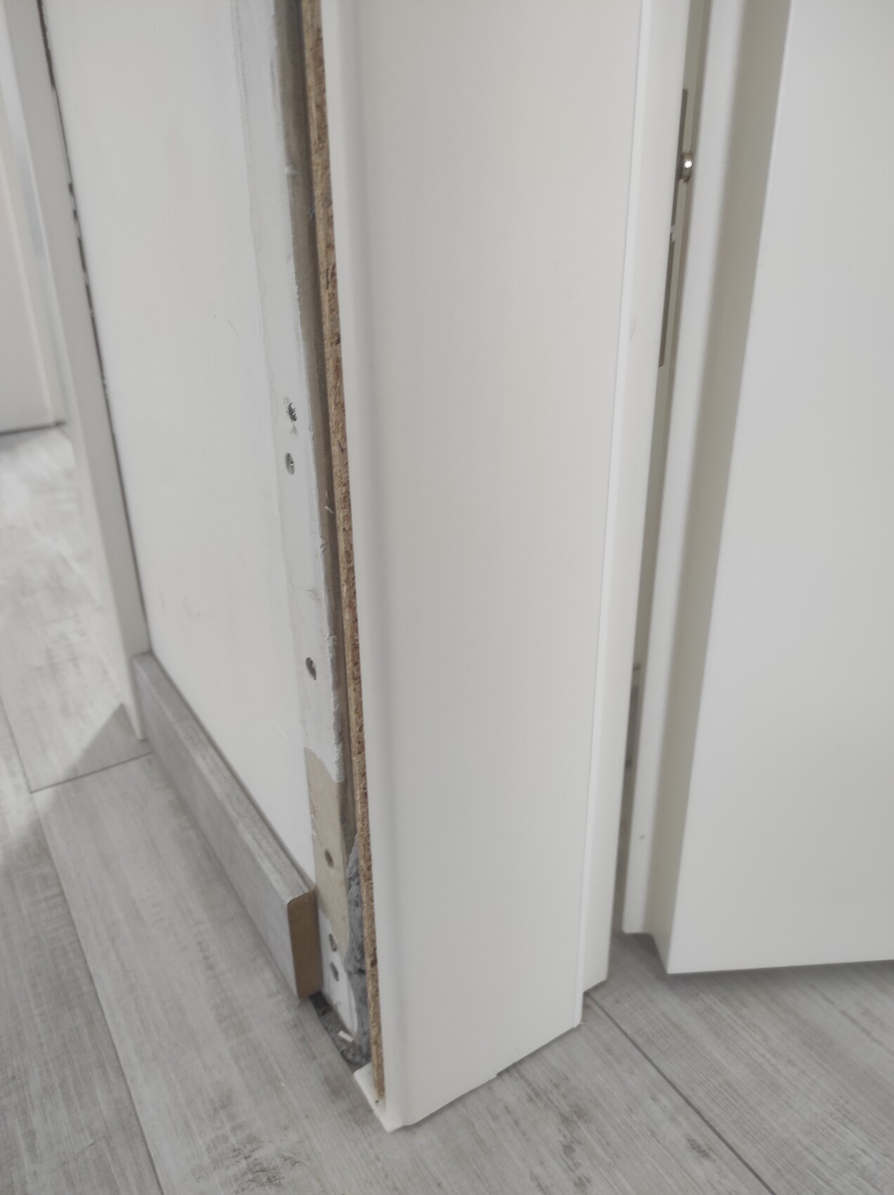

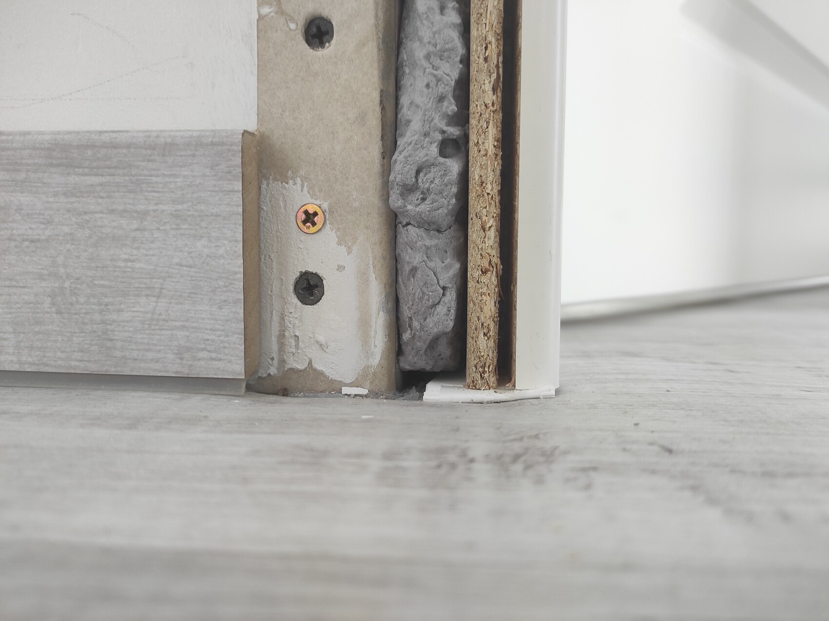

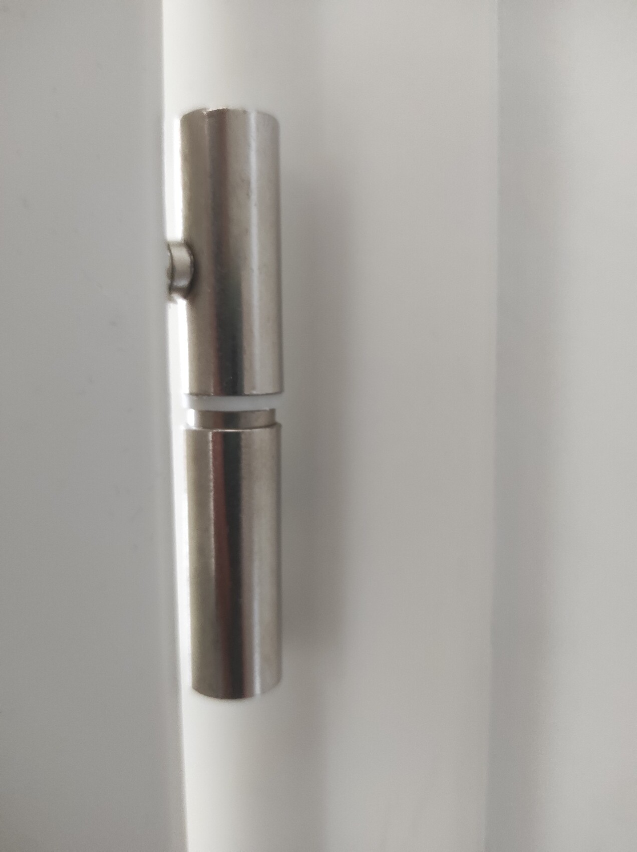

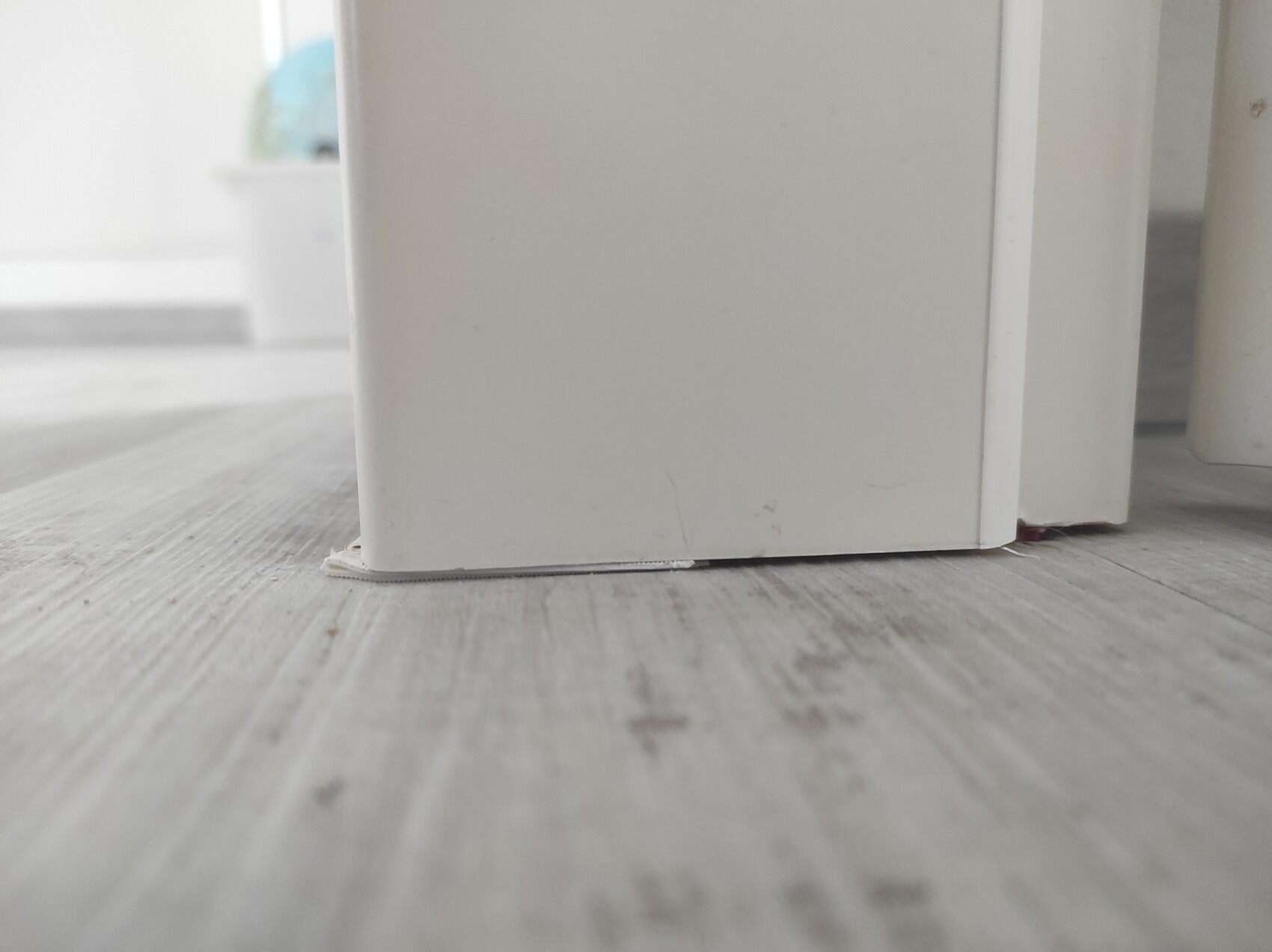

we built our house 4 years ago (2020) and moved in.
One of the room doors creaks briefly when opened. All other doors are quiet, as expected.
It can’t be the door frame because it has already been aligned and oiled. We suspect the issue lies in the connection between the drywall (plasterboard) wall, the door frame, and the PVC flooring.
But pinpointing the problem? That’s the tricky part! We are getting frustrated because even after a second attempt, the professionals couldn’t fully fix the issue. Pictures will follow.
Maybe this community has some solutions?
Thank you.
Best regards, Tarik

trksglm schrieb:
We built our house 4 years ago (2020) and moved in new.
One of the doors to a room squeaks briefly when opened. All other doors are quiet and are as expected.
It can’t be the door frame, since it has already been aligned and oiled. The issue seems to be related to the connection between the drywall, door frame, and PVC flooring.
But this is a "where’s the fault?" situation?! We are really frustrated because even the experts couldn’t fully resolve the root cause after a second attempt. Who were these “experts” – installers from the construction company...

It seems to me that there are various issues with shape, fit, and alignment that aren’t quite right; besides the last attempt, oiling won’t help much. Door frames standing on the floor (even with a gap) probably aren’t exactly top quality either. I hope the warranty period hasn’t expired or been interrupted. Under warranty, the contractor has the right to repair defects, but that does not mean you should let the contractor judge whether a fault exists instead of involving an independent expert. Discuss this with a specialist lawyer and consider hiring a professional surveyor.

there must be a connection between the drywall, door frame, and PVC covering. It is likely that the metal studs of the drywall are stressed.
In our case, half of the attic is affected: when we moved in 2014 and the storms got stronger, it felt like the entire upper floor creaked. We had the choice: file a complaint and have everything opened up or live with the creaking during storms. We chose the latter.

It is likely that the metal frame of the drywall, meaning the studs, are under stress.
In our case, it affects half of the attic: when we moved in in 2014 and the storms became stronger, it felt like the entire upper floor was creaking. We had the choice to file a defect report and have everything opened up or to live with the creaking during storms. We chose the latter.
