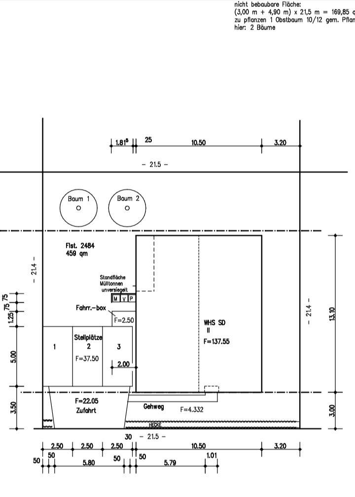

Hello, we are planning our house, which we want to share with my mother (separate apartment approximately 70 sqm (750 sq ft)). We want to maximize the floor area with 137 sqm (1,475 sq ft). Maybe someone has ideas, suggestions, or improvements. We are grateful for any input.
Plot size 459 sqm (4,940 sq ft), 21.5 * 21.4 meters (71 * 70 ft)
Site coverage ratio 0.3
Building area 15.4 * 13.4 meters (50 * 44 ft)
Building line 3 meters (10 ft) and boundary line 5 meters (16 ft)
1.5 storeys
Roof type: steep roof, minimum 35 degrees
Street-facing gable
Maximum heights / limits 9 meters (30 ft)
Other requirements: max 1.15 meter (3.8 ft) knee wall

What do you dislike? Why? Dark corridor
Personal budget for house including fittings: 400,000
Why is the design like it is now?
What do you think is particularly good or bad about it? Maximum size utilized, difficult implementation due to sloping roofs

Site plan? Site plan! Site plan?
Besides the problems already mentioned, you might want to reconsider the overall concept.
Because of the slopes, right now about five people upstairs have almost the same amount of space as one person downstairs. That seems disproportionate to me.
The office is quite large – how much space is really needed there? Could visitors be expected to use stairs, or do they have mobility issues?
Are there any regulations regarding dormer size? It was important to us that our apartment is all on one floor

Where is north, by the way?

What about garden access—even if it’s a small one? Sitting on a terrace with three kids feels very different than cramming onto a balcony. And what do you mean by "if we later live in the entire house"? Is your mother-in-law planning to get married again and moving in with her boyfriend soon? Or are you already planning for her to die from COVID?
