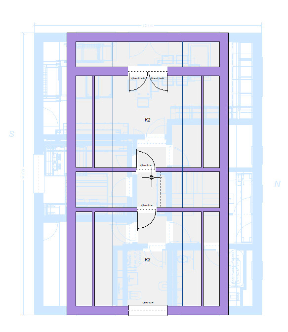

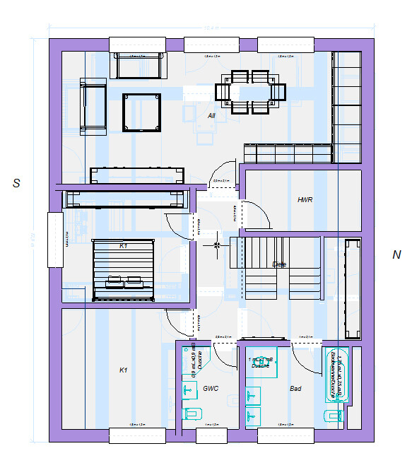

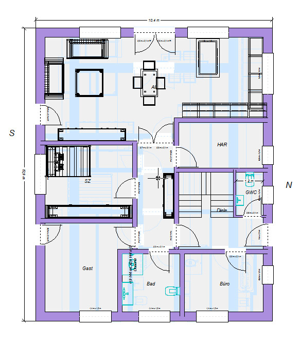

Here is an initial attempt at a roof peak conversion (50°) roughly according to the clients’ wishes, which I personally find quite questionable. (As usual, the stairs have no landings)
