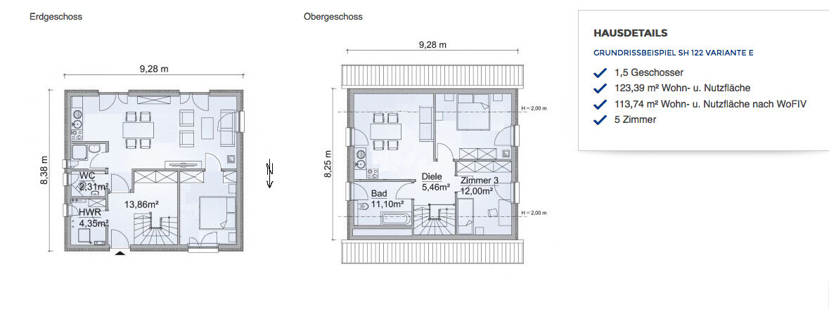

By the way, the light blue shaded rectangles on the site plan are intended to represent parking spaces for cars

But first there is the question: what do you basically want?Thanks for the example. It can actually be separated. I’ve redrawn it so that each floor is one living unit.
It is very good here that the ground floor child/office room is large enough to fit a double bed if you are willing to compromise. In this example, the ground floor child’s room unfortunately has no direct access to the rest of the ground floor apartment but only through the “public” staircase. However, if you move its door to the wall facing the living room as I drew, it fits. A prefabricated house provider once rejected that because the walls running longitudinally under the ridge are load-bearing walls.
A shower needs to be accommodated on the ground floor (if you want/need to keep the utility room because otherwise there is no space for the home technology). The kitchen could be reduced in size to create room for a small bathroom with a window; I have also marked that.
The question remains where to locate the second set of technical equipment. The utility room is sufficient for one set of heating and ventilation systems. If you don’t use special duplicated devices, the second set of heating/hot water/ventilation must go somewhere else. The attic is difficult to impossible because in prefab houses it is usually too low and because the fold-down ladder is too narrow and steep to get the equipment up there. With enough money, a solution could certainly be found.
If you want to include a kitchen combined with living and dining space in the upper floor and halve the bathroom but keep the bathroom window, the upper floor only has one window serving kitchen + dining + living areas. With money, adding a roof window is of course possible.
This is the crux of the matter. I once got a prefab house provider to calculate what it would cost to split a one and a half story house into two levels, and the price went way beyond my budget. (It is cheaper with bungalows.)
I do not want to criticize the proposal in principle.
It just seems very expensive in this specific case to separate the two floors into individual units. Like many other prefab houses, this house seems optimized for exactly one purpose. My partner and I have looked at several model houses and many floor plans. So far, every attempt to split a small one and a half story prefab house has run into something that made it very expensive for the respective provider, no matter how flexible we were. But one should never give up hope; this example already looks much more promising than most other designs I have tried to split. Thanks again.
