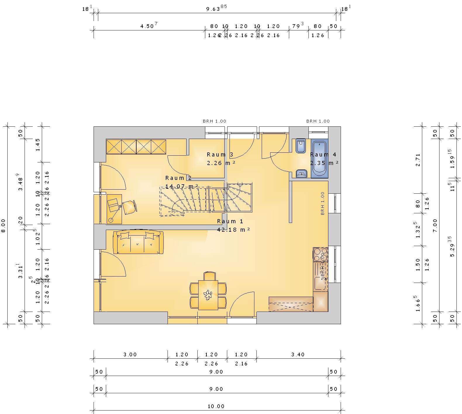

2D floor plan of a house: living room, kitchen, dining area, bathroom, and staircase

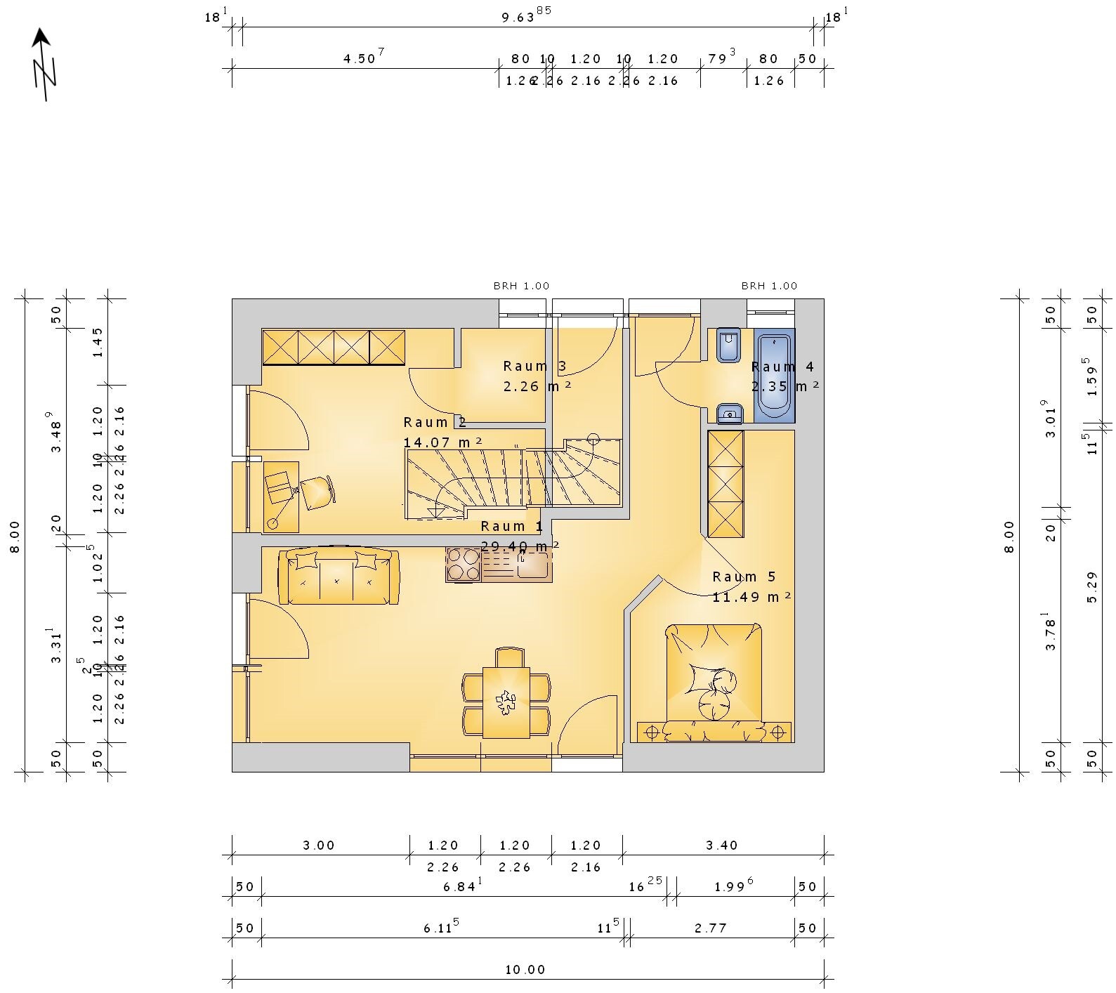

2D floor plan of a house with three rooms, staircase, and kitchen area

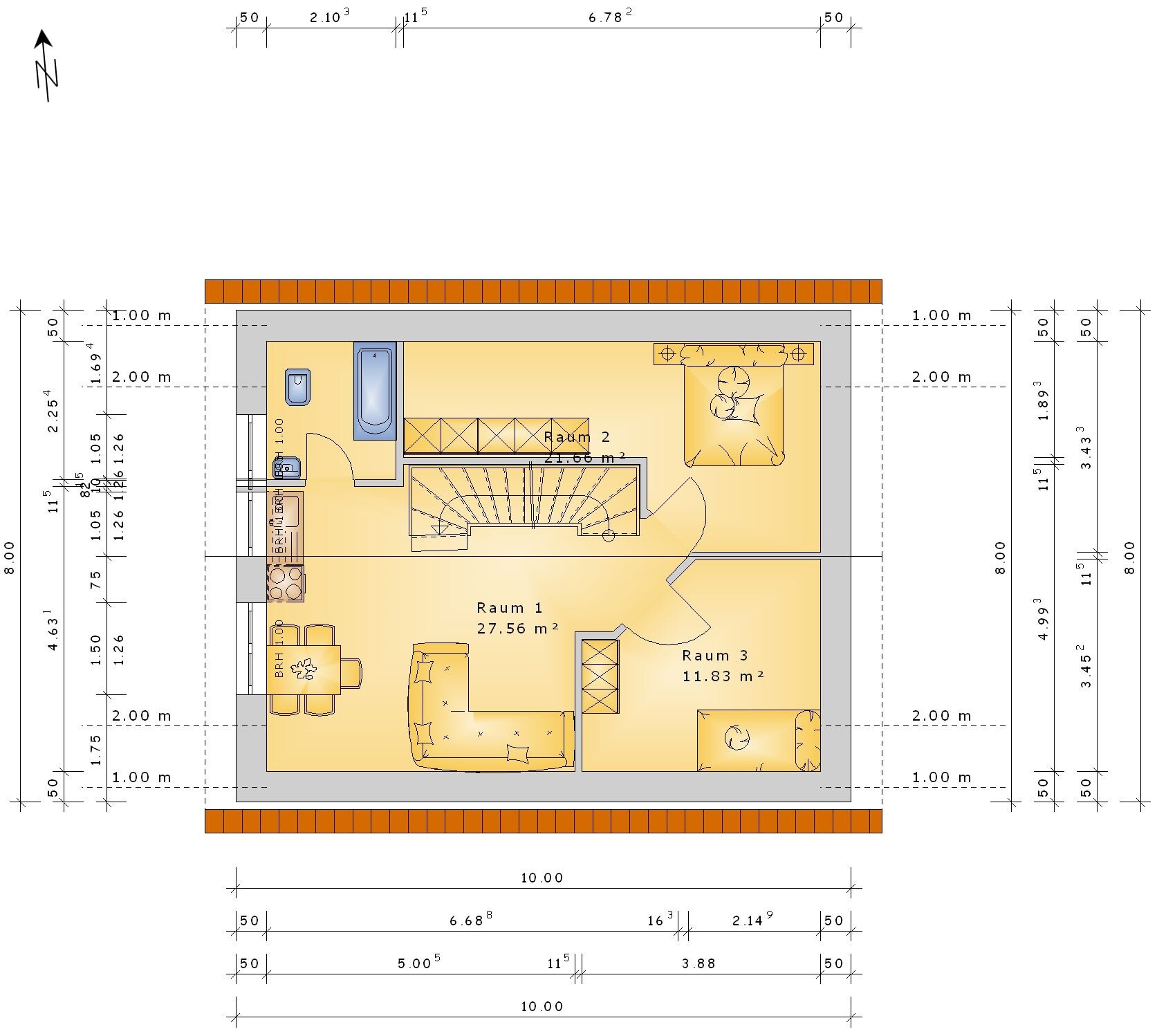

Technical floor plan with central staircase, exterior wall, and dimensions

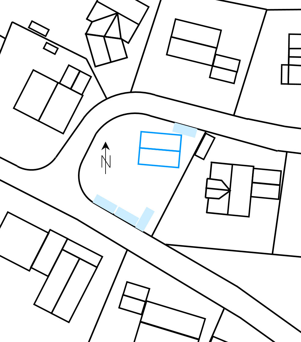

Site plan of a residential area with property boundaries, building sketches, and road layout.

By the way, the light blue shaded rectangles on the site plan are intended to represent parking spaces for cars
4 Jul 2017 17:52
I have a problem understanding the reasons behind this—perhaps you haven’t explained why it has to be so complicated?
I also find it difficult to understand—assuming the plan is good and makes sense—why the parking spaces are distributed so oddly on the property.
bindig schrieb:
I have looked at many floor plans here in the forum, but under similar conditions, it seemed the discussion always ended up with building the house solely as a single-family home (SFH) without dividing it before (or after) the SFH use.
You can’t compare the conditions if a homeowner wants to build an in-law unit under or above their own living area just to save costs. These are two completely different things—or are you mainly concerned about saving money? I’ve read that your primary goal is to rent out, at least for the first 10 years, at least the upper part. Below, a holiday apartment is planned.
Why do you want to build the house at all? Are you looking for an investment? Do you want a holiday apartment and to be an entrepreneur, or are you building a home for yourselves (whoever that may be)? That’s what the house design should be based on.

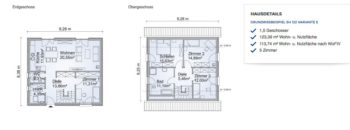

An example from the internet, quickly found at Scanhaus Marlow, where I can clearly see at first glance that it is possible to separate the ground floor and upper floor with minimal effort—if you accept compromises in living quality and size.
Two-story house floor plan with ground and upper floor, living and sleeping areas
But first of all, the question is: what do you basically want?

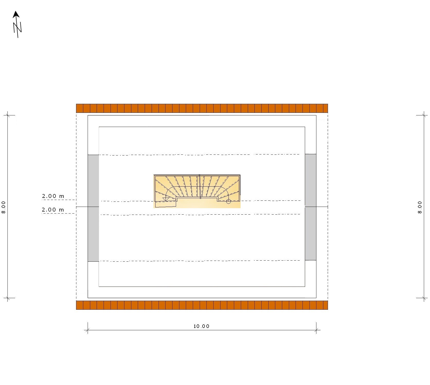

Here is the requested single-family house version of the initial design, not yet improved in any way, provided as a response to one of the first questions.
Detailed floor plan of a single-family house with kitchen, dining area, living room, staircase, and bathroom

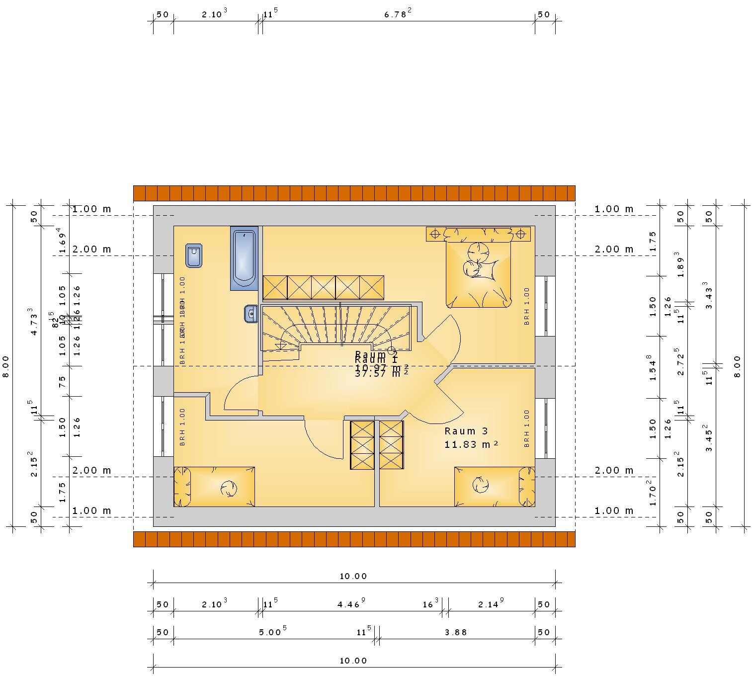

Attic floor plan with staircase, rooms, and measurements on the plan
kbt09
4 Jul 2017 19:26
I don’t understand the confusing staircase layout on the ground floor at all.
The bathroom on the upper floor wastes a lot of space, but it’s not possible to fit a shower in there.
As a closet user in the master bedroom, the closet can’t have doors or must be under 200 cm (79 inches) tall. And the user should not be too tall either.
On the ground floor... what is that worm-like extension from the kitchen toward the bathroom supposed to be?
This definitely won’t work as it is.
bindig
4 Jul 2017 19:40
Evolith schrieb:
Something different: You mention a limited budget. What budget do you actually have available? Only then can we properly help you with dimensions.
200,000 (two hundred thousand)
Otherwise: one-and-a-half stories --> sloped ceilings? You probably won't enjoy showering much in such a small bathroom. And constantly stepping out of the bathtub gets old over time. It’s also not entirely safe for a small child, by the way.
The bathtub in the attic is half outside the 2-meter (6 ft 7 in) line. I’ve seen worse cases in older buildings. An alternative would be just a shower in the attic, which could be fully outside the sloped ceiling area. I’ll reconsider that.
Then there are no windows in the bedrooms. But I think you’ve planned them, just didn’t draw them in.
Yes, in the updated single-family house version the windows are included. In the original post, all windows on the east side are missing (two downstairs, two upstairs), for some reason. Obviously, it wouldn’t work there without windows.
Also, a utility/technical room is missing. Since you have no basement, plan at least 8 square meters (86 sq ft) for the central heating compact unit and other equipment.
I can’t find space for a utility room in a 10 by 8 meter (33 by 26 ft) footprint if there are supposed to be two units. I’m thinking part of the technical equipment could go into the common room (ground floor, top left on the plan) and the rest in the attic. Is that unrealistic?
Why not build a 100 square meter (1,076 sq ft) bungalow? You could live much more comfortably and arrange the rooms better. It would also be easier to extend after a few years.
Yes, a bungalow also seems more suitable to me. Unfortunately, on this building plot it would only be allowed if the roof height is at least about 7 meters (23 ft). As I understand it, we can’t have a cheap bungalow-style roof with thin vertical and angled beams providing intermittent support, but must have a “proper” roof. This means we could save on internal roof insulation if we leave the attic space completely unused. But since the bungalow would obviously need to be larger than 8 by 10 meters (26 by 33 ft), the roof will still be more expensive than on a small one-and-a-half-story house where the attic space would be used. – Alternative suggestions are welcome.
