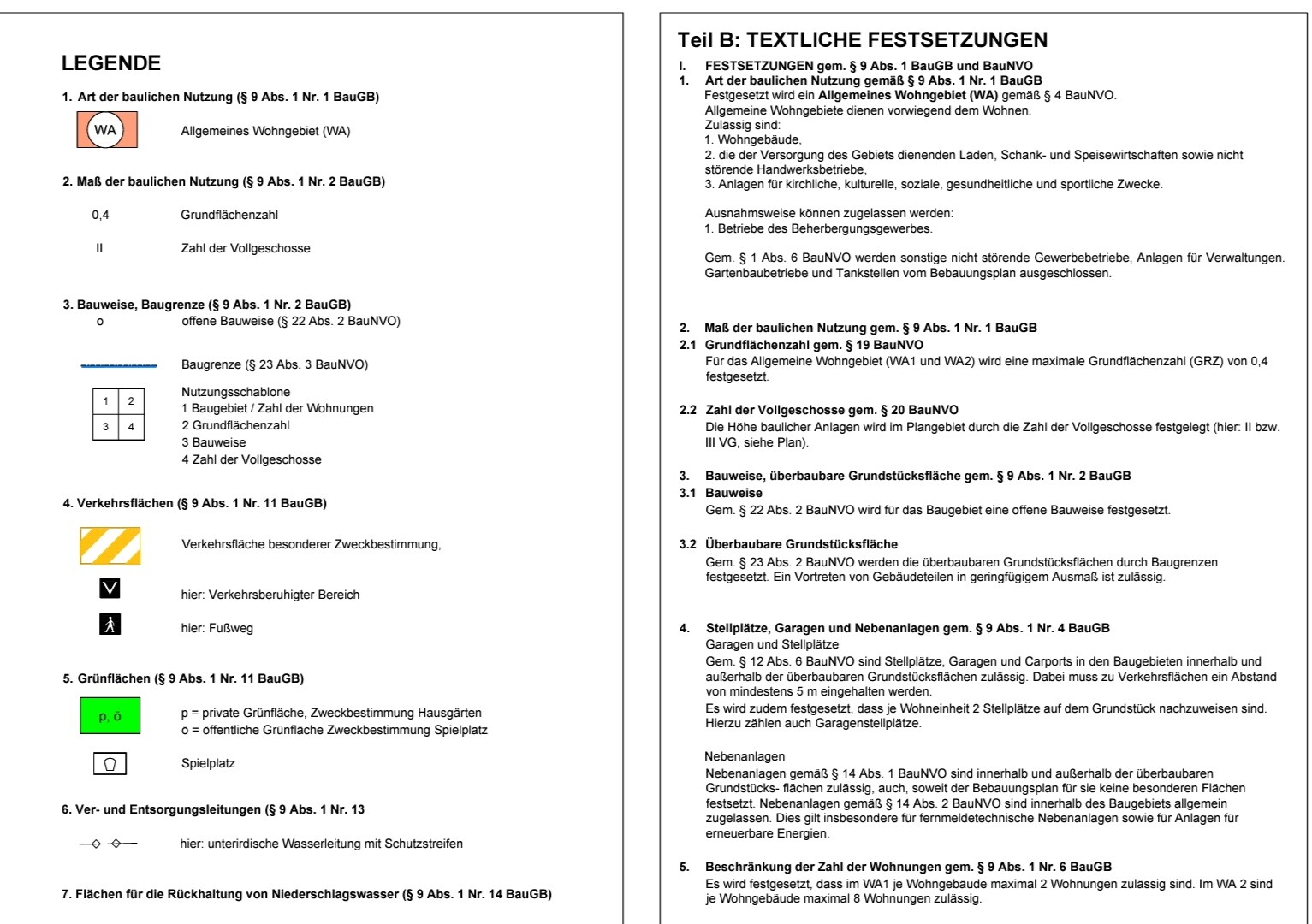

LuiseRadiese21 Sep 2020 19:48haydee schrieb:
Isn’t something still missing?What else is needed?W
Wintersonne21 Sep 2020 21:25LuiseRadiese schrieb:
This should be it.
Two full stories are allowed, so a townhouse-style villa would also be possible, but it was too expensive and unnecessary for us. That’s why we were offered and planned this gable roof instead, and we didn’t say no. With the gable roof, the costs for insulation, installing a vapor retarder, possibly wood fiberboards, drywall, scaffolding for painting the high ceilings, etc., are also quite significant. Have you compared this to a concrete ceiling? Or why were two full stories so much more expensive?
