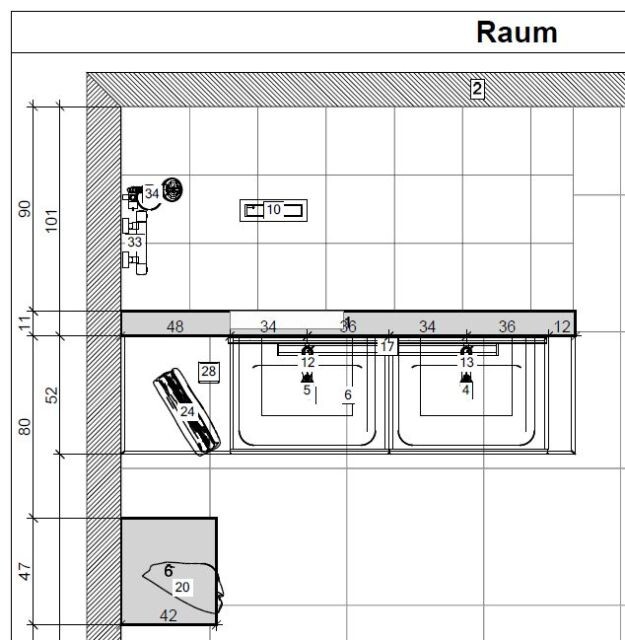

Masipulami11 Feb 2016 14:05
The niche did not cost us any extra. The tiler in the bathrooms agreed to do it that way.
Here is an excerpt from the bathroom plan:
