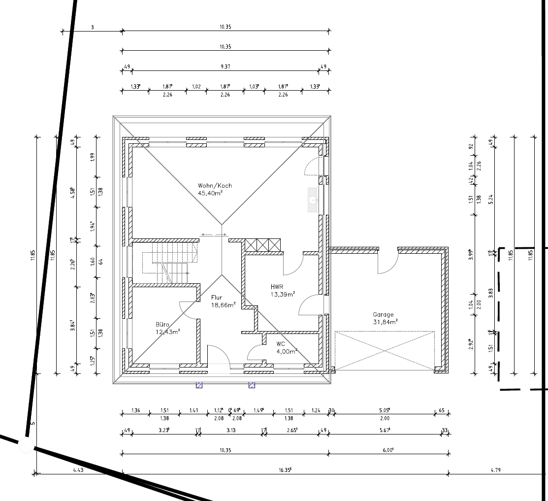

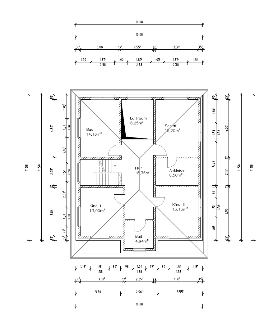

Attached are the floor plans for the ground floor and the upper floor. On the upper floor, the children’s bathroom is located above the main entrance. It should roughly keep the drawn size but can still be adjusted slightly due to the hallway space. To create an overhang above the main entrance, it would need to extend out at least 50cm (20 inches). If this 50cm (20 inches) overhang is allowed, only the gutter could be placed on this extended part, maintaining the desired roof overhang of 50cm (20 inches) over the rest of the house side. Our planner mentioned that he would prefer a larger roof overhang instead of having only the gutter at this point in the middle of the upper floor.
Ground floor:
Upper floor:
Ground floor:
Upper floor:

Are you sure that the ground floor and upper floor are based on the same design version? The wall lengths and the drawn roof overhang on the ground floor don’t seem to match. Depending on the bathroom layout, the routing of the plumbing could also become quite challenging.

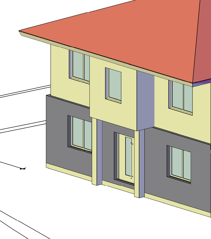

Our builder is very flexible based on experience and wants to provide us with the exact plans in large format with precise measurements before the ground floor masonry begins. Therefore, the drawings are probably not 100% final yet. He said we can change them as we like. One modification is possible without affecting the price. He calculated this solution that way from the start; we were simply unaware of the additional eaves overhang.
The roof drawing for the ground floor seems to have a small error. It should look like the left and right sides at the top. Only in the front area of the upper floor is there currently a larger roof overhang because the upper floor is set forward in the middle.
This is the view we received. It is the version with a 1.25m (4 feet) overhang on the left and right and a 75cm (30 inches) forward projection of the upper floor.
