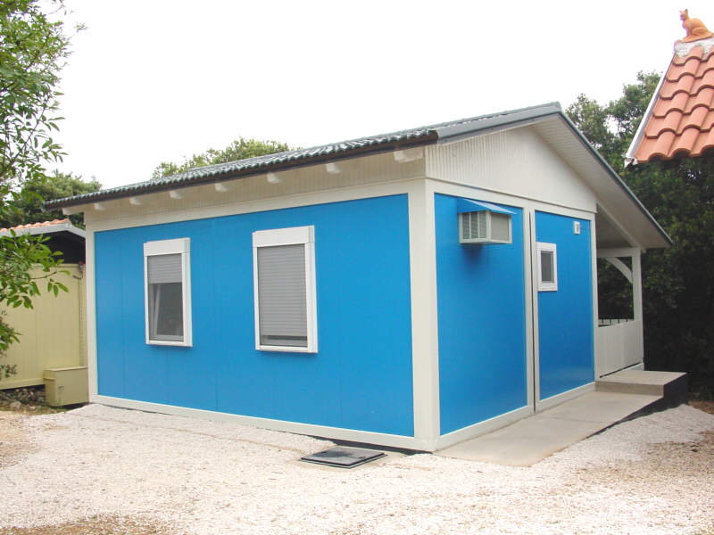

admittedly, the pictured red shipping container, which apparently has sections that can be extended, looks quite impressive.
The holiday home (Schmidt container), however, consists of two residential or office containers. These already meet certain minimum requirements for habitable rooms from the outset.
Nevertheless, if such a shipping container is intended for permanent residential use in Germany, the requirements and regulations mentioned in my previous post must be fulfilled.
The interesting examples of shipping containers converted into living spaces on the German Architecture Forum’s pages largely come from abroad for good reason. It seems that such projects are somewhat easier to implement there.
However, I can only wish success with such a plan, as it would bring much more variety to German housing culture.
Not always just the standard version: four walls, pitched roof, doghouse with an attached flat-roof garage or carport.
