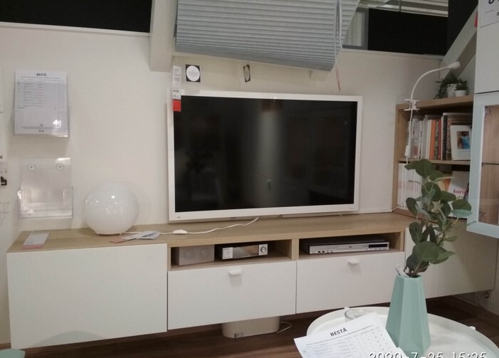

bauenmk202014 Nov 2020 08:17
Even if it only concerns your initial observation: The bank will probably be screwed directly to the wall without a rail. I also saw this at IKEA and took some pictures.
So I’m also curious whether this is an acceptable method. But why would IKEA do it differently then?
